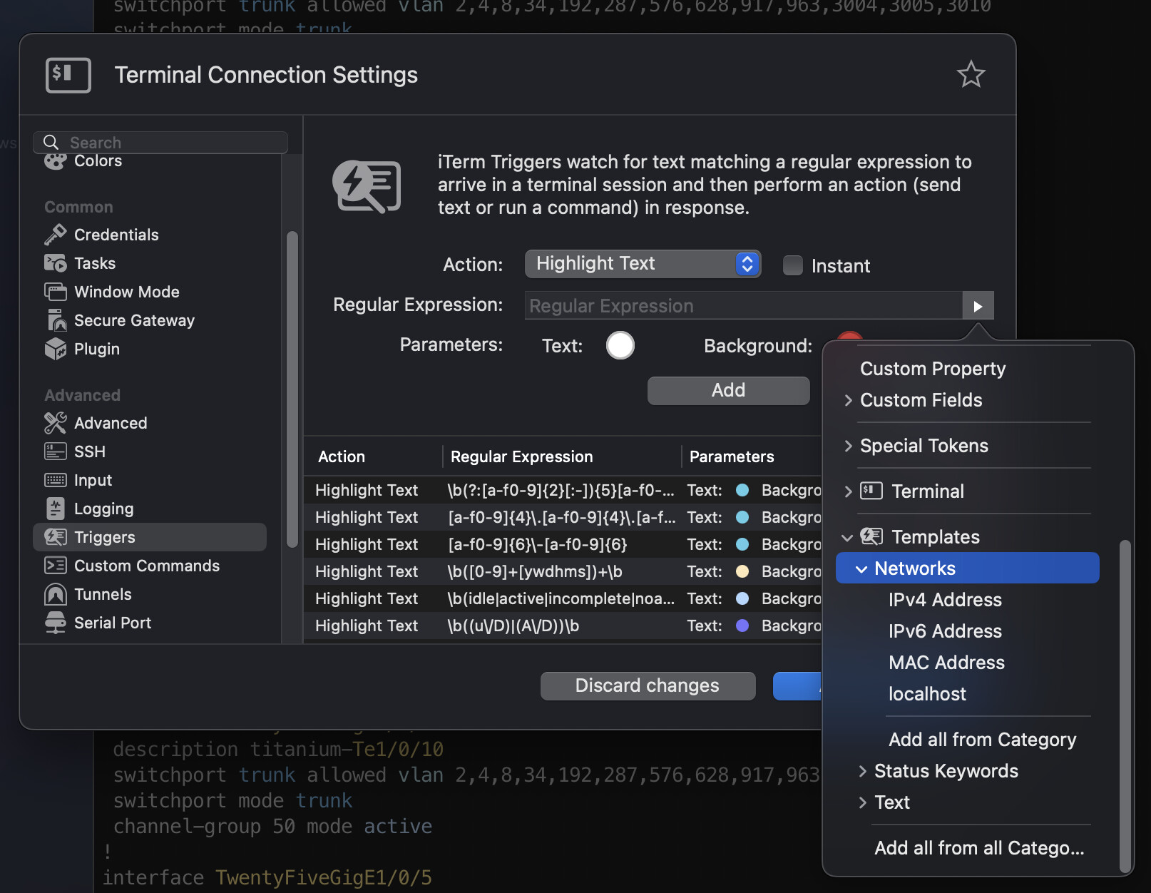

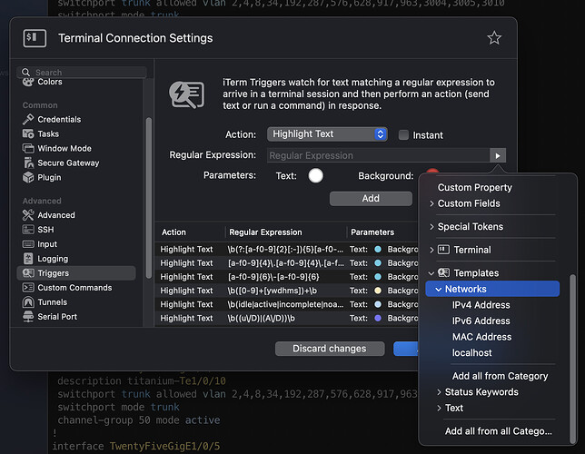

Good day,
I’ve copied regex highlighting from SecureCRT to TSX, so sysntax highlughting is working fine for networking devices (especially Cisco).
Now I want to build some template for these troggers. Unfortunately, I cannot find a way to do it, as there’s no option to add any new string here.
Does anyone know, where that file with Trigger Templates is located, so I do not enter eny new string everytime via GUI? I know, creating a Connection Template may be used as workaround, but for now, I want to create a Trigger Template, to make it possible to select different highlighting strings for different types of devices.
Thanks in advance.
While it is not possible to add/modify the templates, copying / pasting is enabled in the Trigger Table View.
So in your case you can select a trigger, press CMD + C and paste again with CMD + V into another connection.

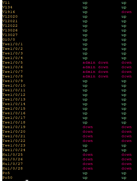

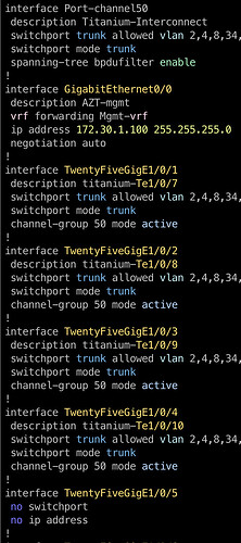

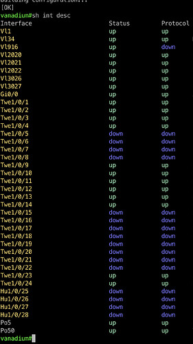

If someone interested, attached is a tuned regex list highlighting syntax for all Cisco versions (IOS, XE, XR).

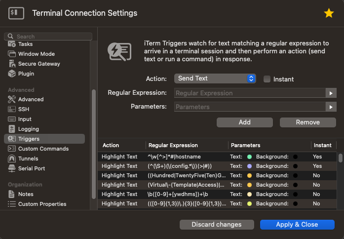

@AS, this is awesome! However, I can’t figure out how to import these into Roya TSX. They won’t paste into it. I created a couple of “Trigger—Highlight Text” from the default templates and copied those to a text editor. The format is completely different from the ones in your file.
This is what I get; I don’t understand why the parameter is full of junk unless that is the very specific color settings.
[{"Action":"HighlightTrigger","Regex":"\\b(?i)localhost\\b","Parameter":"{YnBsaXN0MDDUAQIDBAUGBxBYJHZlcnNpb25ZJGFyY2hpdmVyVCR0b3BYJG9iamVjdHMSAAGGoF8QD05TS2V5ZWRBcmNoaXZlctQICQoLDA0OD1xOU0NvbXBvbmVudHNVTlNSR0JcTlNDb2xvclNwYWNlXxASTlNDdXN0b21Db2xvclNwYWNlTxASMSAwLjMwMTk2MDc4NDMgMSAxTxAmMC45ODU4ODIyODIzIDAuMTI1OTQ5MzM4MSAwLjk5OTE5OTc0OAAQAYABpBESGRpVJG51bGzTExQVFhcYVE5TSURVTlNJQ0NWJGNsYXNzEAeAAoADTxEMSAAADEhMaW5vAhAAAG1udHJSR0IgWFlaIAfOAAIACQAGADEAAGFjc3BNU0ZUAAAAAElFQyBzUkdCAAAAAAAAAAAAAAAAAAD21gABAAAAANMtSFAgIAAAAAAAAAAAAAAAAAAAAAAAAAAAAAAAAAAAAAAAAAAAAAAAAAAAAAAAAAAAAAAAEWNwcnQAAAFQAAAAM2Rlc2MAAAGEAAAAbHd0cHQAAAHwAAAAFGJrcHQAAAIEAAAAFHJYWVoAAAIYAAAAFGdYWVoAAAIsAAAAFGJYWVoAAAJAAAAAFGRtbmQAAAJUAAAAcGRtZGQAAALEAAAAiHZ1ZWQAAANMAAAAhnZpZXcAAAPUAAAAJGx1bWkAAAP4AAAAFG1lYXMAAAQMAAAAJHRlY2gAAAQwAAAADHJUUkMAAAQ8AAAIDGdUUkMAAAQ8AAAIDGJUUkMAAAQ8AAAIDHRleHQAAAAAQ29weXJpZ2h0IChjKSAxOTk4IEhld2xldHQtUGFja2FyZCBDb21wYW55AABkZXNjAAAAAAAAABJzUkdCIElFQzYxOTY2LTIuMQAAAAAAAAAAAAAAEnNSR0IgSUVDNjE5NjYtMi4xAAAAAAAAAAAAAAAAAAAAAAAAAAAAAAAAAAAAAAAAAAAAAAAAAAAAAAAAAAAAAAAAAABYWVogAAAAAAAA81EAAQAAAAEWzFhZWiAAAAAAAAAAAAAAAAAAAAAAWFlaIAAAAAAAAG+iAAA49QAAA5BYWVogAAAAAAAAYpkAALeFAAAY2lhZWiAAAAAAAAAkoAAAD4QAALbPZGVzYwAAAAAAAAAWSUVDIGh0dHA6Ly93d3cuaWVjLmNoAAAAAAAAAAAAAAAWSUVDIGh0dHA6Ly93d3cuaWVjLmNoAAAAAAAAAAAAAAAAAAAAAAAAAAAAAAAAAAAAAAAAAAAAAAAAAAAAAAAAAAAAAGRlc2MAAAAAAAAALklFQyA2MTk2Ni0yLjEgRGVmYXVsdCBSR0IgY29sb3VyIHNwYWNlIC0gc1JHQgAAAAAAAAAAAAAALklFQyA2MTk2Ni0yLjEgRGVmYXVsdCBSR0IgY29sb3VyIHNwYWNlIC0gc1JHQgAAAAAAAAAAAAAAAAAAAAAAAAAAAABkZXNjAAAAAAAAACxSZWZlcmVuY2UgVmlld2luZyBDb25kaXRpb24gaW4gSUVDNjE5NjYtMi4xAAAAAAAAAAAAAAAsUmVmZXJlbmNlIFZpZXdpbmcgQ29uZGl0aW9uIGluIElFQzYxOTY2LTIuMQAAAAAAAAAAAAAAAAAAAAAAAAAAAAAAAAAAdmlldwAAAAAAE6T+ABRfLgAQzxQAA+3MAAQTCwADXJ4AAAABWFlaIAAAAAAATAlWAFAAAABXH+dtZWFzAAAAAAAAAAEAAAAAAAAAAAAAAAAAAAAAAAACjwAAAAJzaWcgAAAAAENSVCBjdXJ2AAAAAAAABAAAAAAFAAoADwAUABkAHgAjACgALQAyADcAOwBAAEUASgBPAFQAWQBeAGMAaABtAHIAdwB8AIEAhgCLAJAAlQCaAJ8ApACpAK4AsgC3ALwAwQDGAMsA0ADVANsA4ADlAOsA8AD2APsBAQEHAQ0BEwEZAR8BJQErATIBOAE+AUUBTAFSAVkBYAFnAW4BdQF8AYMBiwGSAZoBoQGpAbEBuQHBAckB0QHZAeEB6QHyAfoCAwIMAhQCHQImAi8COAJBAksCVAJdAmcCcQJ6AoQCjgKYAqICrAK2AsECywLVAuAC6wL1AwADCwMWAyEDLQM4A0MDTwNaA2YDcgN+A4oDlgOiA64DugPHA9MD4APsA/kEBgQTBCAELQQ7BEgEVQRjBHEEfgSMBJoEqAS2BMQE0wThBPAE/gUNBRwFKwU6BUkFWAVnBXcFhgWWBaYFtQXFBdUF5QX2BgYGFgYnBjcGSAZZBmoGewaMBp0GrwbABtEG4wb1BwcHGQcrBz0HTwdhB3QHhgeZB6wHvwfSB+UH+AgLCB8IMghGCFoIbgiCCJYIqgi+CNII5wj7CRAJJQk6CU8JZAl5CY8JpAm6Cc8J5Qn7ChEKJwo9ClQKagqBCpgKrgrFCtwK8wsLCyILOQtRC2kLgAuYC7ALyAvhC/kMEgwqDEMMXAx1DI4MpwzADNkM8w0NDSYNQA1aDXQNjg2pDcMN3g34DhMOLg5JDmQOfw6bDrYO0g7uDwkPJQ9BD14Peg+WD7MPzw/sEAkQJhBDEGEQfhCbELkQ1xD1ERMRMRFPEW0RjBGqEckR6BIHEiYSRRJkEoQSoxLDEuMTAxMjE0MTYxODE6QTxRPlFAYUJxRJFGoUixStFM4U8BUSFTQVVhV4FZsVvRXgFgMWJhZJFmwWjxayFtYW+hcdF0EXZReJF64X0hf3GBsYQBhlGIoYrxjVGPoZIBlFGWsZkRm3Gd0aBBoqGlEadxqeGsUa7BsUGzsbYxuKG7Ib2hwCHCocUhx7HKMczBz1HR4dRx1wHZkdwx3sHhYeQB5qHpQevh7pHxMfPh9pH5Qfvx/qIBUgQSBsIJggxCDwIRwhSCF1IaEhziH7IiciVSKCIq8i3SMKIzgjZiOUI8Ij8CQfJE0kfCSrJNolCSU4JWgllyXHJfcmJyZXJocmtyboJxgnSSd6J6sn3CgNKD8ocSiiKNQpBik4KWspnSnQKgIqNSpoKpsqzysCKzYraSudK9EsBSw5LG4soizXLQwtQS12Last4S4WLkwugi63Lu4vJC9aL5Evxy/+MDUwbDCkMNsxEjFKMYIxujHyMioyYzKbMtQzDTNGM38zuDPxNCs0ZTSeNNg1EzVNNYc1wjX9Njc2cjauNuk3JDdgN5w31zgUOFA4jDjIOQU5Qjl/Obw5+To2OnQ6sjrvOy07azuqO+g8JzxlPKQ84z0iPWE9oT3gPiA+YD6gPuA/IT9hP6I/4kAjQGRApkDnQSlBakGsQe5CMEJyQrVC90M6Q31DwEQDREdEikTORRJFVUWaRd5GIkZnRqtG8Ec1R3tHwEgFSEtIkUjXSR1JY0mpSfBKN0p9SsRLDEtTS5pL4kwqTHJMuk0CTUpNk03cTiVObk63TwBPSU+TT91QJ1BxULtRBlFQUZtR5lIxUnxSx1MTU19TqlP2VEJUj1TbVShVdVXCVg9WXFapVvdXRFeSV+BYL1h9WMtZGllpWbhaB1pWWqZa9VtFW5Vb5Vw1XIZc1l0nXXhdyV4aXmxevV8PX2Ffs2AFYFdgqmD8YU9homH1YklinGLwY0Njl2PrZEBklGTpZT1lkmXnZj1mkmboZz1nk2fpaD9olmjsaUNpmmnxakhqn2r3a09rp2v/bFdsr20IbWBtuW4SbmtuxG8eb3hv0XArcIZw4HE6cZVx8HJLcqZzAXNdc7h0FHRwdMx1KHWFdeF2Pnabdvh3VnezeBF4bnjMeSp5iXnnekZ6pXsEe2N7wnwhfIF84X1BfaF+AX5ifsJ/I3+Ef+WAR4CogQqBa4HNgjCCkoL0g1eDuoQdhICE44VHhauGDoZyhteHO4efiASIaYjOiTOJmYn+imSKyoswi5aL/IxjjMqNMY2Yjf+OZo7OjzaPnpAGkG6Q1pE/kaiSEZJ6kuOTTZO2lCCUipT0lV+VyZY0lp+XCpd1l+CYTJi4mSSZkJn8mmia1ZtCm6+cHJyJnPedZJ3SnkCerp8dn4uf+qBpoNihR6G2oiailqMGo3aj5qRWpMelOKWpphqmi6b9p26n4KhSqMSpN6mpqhyqj6sCq3Wr6axcrNCtRK24ri2uoa8Wr4uwALB1sOqxYLHWskuywrM4s660JbSctRO1irYBtnm28Ldot+C4WbjRuUq5wro7urW7LrunvCG8m70VvY++Cr6Evv+/er/1wHDA7MFnwePCX8Lbw1jD1MRRxM7FS8XIxkbGw8dBx7/IPci8yTrJuco4yrfLNsu2zDXMtc01zbXONs62zzfPuNA50LrRPNG+0j/SwdNE08bUSdTL1U7V0dZV1tjXXNfg2GTY6Nls2fHadtr724DcBdyK3RDdlt4c3qLfKd+v4DbgveFE4cziU+Lb42Pj6+Rz5PzlhOYN5pbnH+ep6DLovOlG6dDqW+rl63Dr++yG7RHtnO4o7rTvQO/M8Fjw5fFy8f/yjPMZ86f0NPTC9VD13vZt9vv3ivgZ+Kj5OPnH+lf65/t3/Af8mP0p/br+S/7c/23//9IbHB0eWiRjbGFzc25hbWVYJGNsYXNzZXNcTlNDb2xvclNwYWNloh8gXE5TQ29sb3JTcGFjZVhOU09iamVjdAAIABEAGgAkACkAMgA3AEkAUgBfAGUAcgCHAJwAxQDHAMkAzgDUANsA4ADmAO0A7wDxAPMNPw1EDU8NWA1lDWgNdQAAAAAAAAIBAAAAAAAAACEAAAAAAAAAAAAAAAAAAA1+,YnBsaXN0MDDUAQIDBAUGBxBYJHZlcnNpb25ZJGFyY2hpdmVyVCR0b3BYJG9iamVjdHMSAAGGoF8QD05TS2V5ZWRBcmNoaXZlctQICQoLDA0OD1xOU0NvbXBvbmVudHNVTlNSR0JcTlNDb2xvclNwYWNlXxASTlNDdXN0b21Db2xvclNwYWNlRzAgMCAwIDFGMCAwIDAAEAGAAaQREhkaVSRudWxs0xMUFRYXGFROU0lEVU5TSUNDViRjbGFzcxAHgAKAA08RDEgAAAxITGlubwIQAABtbnRyUkdCIFhZWiAHzgACAAkABgAxAABhY3NwTVNGVAAAAABJRUMgc1JHQgAAAAAAAAAAAAAAAAAA9tYAAQAAAADTLUhQICAAAAAAAAAAAAAAAAAAAAAAAAAAAAAAAAAAAAAAAAAAAAAAAAAAAAAAAAAAAAAAABFjcHJ0AAABUAAAADNkZXNjAAABhAAAAGx3dHB0AAAB8AAAABRia3B0AAACBAAAABRyWFlaAAACGAAAABRnWFlaAAACLAAAABRiWFlaAAACQAAAABRkbW5kAAACVAAAAHBkbWRkAAACxAAAAIh2dWVkAAADTAAAAIZ2aWV3AAAD1AAAACRsdW1pAAAD+AAAABRtZWFzAAAEDAAAACR0ZWNoAAAEMAAAAAxyVFJDAAAEPAAACAxnVFJDAAAEPAAACAxiVFJDAAAEPAAACAx0ZXh0AAAAAENvcHlyaWdodCAoYykgMTk5OCBIZXdsZXR0LVBhY2thcmQgQ29tcGFueQAAZGVzYwAAAAAAAAASc1JHQiBJRUM2MTk2Ni0yLjEAAAAAAAAAAAAAABJzUkdCIElFQzYxOTY2LTIuMQAAAAAAAAAAAAAAAAAAAAAAAAAAAAAAAAAAAAAAAAAAAAAAAAAAAAAAAAAAAAAAAAAAWFlaIAAAAAAAAPNRAAEAAAABFsxYWVogAAAAAAAAAAAAAAAAAAAAAFhZWiAAAAAAAABvogAAOPUAAAOQWFlaIAAAAAAAAGKZAAC3hQAAGNpYWVogAAAAAAAAJKAAAA+EAAC2z2Rlc2MAAAAAAAAAFklFQyBodHRwOi8vd3d3LmllYy5jaAAAAAAAAAAAAAAAFklFQyBodHRwOi8vd3d3LmllYy5jaAAAAAAAAAAAAAAAAAAAAAAAAAAAAAAAAAAAAAAAAAAAAAAAAAAAAAAAAAAAAABkZXNjAAAAAAAAAC5JRUMgNjE5NjYtMi4xIERlZmF1bHQgUkdCIGNvbG91ciBzcGFjZSAtIHNSR0IAAAAAAAAAAAAAAC5JRUMgNjE5NjYtMi4xIERlZmF1bHQgUkdCIGNvbG91ciBzcGFjZSAtIHNSR0IAAAAAAAAAAAAAAAAAAAAAAAAAAAAAZGVzYwAAAAAAAAAsUmVmZXJlbmNlIFZpZXdpbmcgQ29uZGl0aW9uIGluIElFQzYxOTY2LTIuMQAAAAAAAAAAAAAALFJlZmVyZW5jZSBWaWV3aW5nIENvbmRpdGlvbiBpbiBJRUM2MTk2Ni0yLjEAAAAAAAAAAAAAAAAAAAAAAAAAAAAAAAAAAHZpZXcAAAAAABOk/gAUXy4AEM8UAAPtzAAEEwsAA1yeAAAAAVhZWiAAAAAAAEwJVgBQAAAAVx/nbWVhcwAAAAAAAAABAAAAAAAAAAAAAAAAAAAAAAAAAo8AAAACc2lnIAAAAABDUlQgY3VydgAAAAAAAAQAAAAABQAKAA8AFAAZAB4AIwAoAC0AMgA3ADsAQABFAEoATwBUAFkAXgBjAGgAbQByAHcAfACBAIYAiwCQAJUAmgCfAKQAqQCuALIAtwC8AMEAxgDLANAA1QDbAOAA5QDrAPAA9gD7AQEBBwENARMBGQEfASUBKwEyATgBPgFFAUwBUgFZAWABZwFuAXUBfAGDAYsBkgGaAaEBqQGxAbkBwQHJAdEB2QHhAekB8gH6AgMCDAIUAh0CJgIvAjgCQQJLAlQCXQJnAnECegKEAo4CmAKiAqwCtgLBAssC1QLgAusC9QMAAwsDFgMhAy0DOANDA08DWgNmA3IDfgOKA5YDogOuA7oDxwPTA+AD7AP5BAYEEwQgBC0EOwRIBFUEYwRxBH4EjASaBKgEtgTEBNME4QTwBP4FDQUcBSsFOgVJBVgFZwV3BYYFlgWmBbUFxQXVBeUF9gYGBhYGJwY3BkgGWQZqBnsGjAadBq8GwAbRBuMG9QcHBxkHKwc9B08HYQd0B4YHmQesB78H0gflB/gICwgfCDIIRghaCG4IggiWCKoIvgjSCOcI+wkQCSUJOglPCWQJeQmPCaQJugnPCeUJ+woRCicKPQpUCmoKgQqYCq4KxQrcCvMLCwsiCzkLUQtpC4ALmAuwC8gL4Qv5DBIMKgxDDFwMdQyODKcMwAzZDPMNDQ0mDUANWg10DY4NqQ3DDd4N+A4TDi4OSQ5kDn8Omw62DtIO7g8JDyUPQQ9eD3oPlg+zD88P7BAJECYQQxBhEH4QmxC5ENcQ9RETETERTxFtEYwRqhHJEegSBxImEkUSZBKEEqMSwxLjEwMTIxNDE2MTgxOkE8UT5RQGFCcUSRRqFIsUrRTOFPAVEhU0FVYVeBWbFb0V4BYDFiYWSRZsFo8WshbWFvoXHRdBF2UXiReuF9IX9xgbGEAYZRiKGK8Y1Rj6GSAZRRlrGZEZtxndGgQaKhpRGncanhrFGuwbFBs7G2MbihuyG9ocAhwqHFIcexyjHMwc9R0eHUcdcB2ZHcMd7B4WHkAeah6UHr4e6R8THz4faR+UH78f6iAVIEEgbCCYIMQg8CEcIUghdSGhIc4h+yInIlUigiKvIt0jCiM4I2YjlCPCI/AkHyRNJHwkqyTaJQklOCVoJZclxyX3JicmVyaHJrcm6CcYJ0kneierJ9woDSg/KHEooijUKQYpOClrKZ0p0CoCKjUqaCqbKs8rAis2K2krnSvRLAUsOSxuLKIs1y0MLUEtdi2rLeEuFi5MLoIuty7uLyQvWi+RL8cv/jA1MGwwpDDbMRIxSjGCMbox8jIqMmMymzLUMw0zRjN/M7gz8TQrNGU0njTYNRM1TTWHNcI1/TY3NnI2rjbpNyQ3YDecN9c4FDhQOIw4yDkFOUI5fzm8Ofk6Njp0OrI67zstO2s7qjvoPCc8ZTykPOM9Ij1hPaE94D4gPmA+oD7gPyE/YT+iP+JAI0BkQKZA50EpQWpBrEHuQjBCckK1QvdDOkN9Q8BEA0RHRIpEzkUSRVVFmkXeRiJGZ0arRvBHNUd7R8BIBUhLSJFI10kdSWNJqUnwSjdKfUrESwxLU0uaS+JMKkxyTLpNAk1KTZNN3E4lTm5Ot08AT0lPk0/dUCdQcVC7UQZRUFGbUeZSMVJ8UsdTE1NfU6pT9lRCVI9U21UoVXVVwlYPVlxWqVb3V0RXklfgWC9YfVjLWRpZaVm4WgdaVlqmWvVbRVuVW+VcNVyGXNZdJ114XcleGl5sXr1fD19hX7NgBWBXYKpg/GFPYaJh9WJJYpxi8GNDY5dj62RAZJRk6WU9ZZJl52Y9ZpJm6Gc9Z5Nn6Wg/aJZo7GlDaZpp8WpIap9q92tPa6dr/2xXbK9tCG1gbbluEm5rbsRvHm94b9FwK3CGcOBxOnGVcfByS3KmcwFzXXO4dBR0cHTMdSh1hXXhdj52m3b4d1Z3s3gReG54zHkqeYl553pGeqV7BHtje8J8IXyBfOF9QX2hfgF+Yn7CfyN/hH/lgEeAqIEKgWuBzYIwgpKC9INXg7qEHYSAhOOFR4Wrhg6GcobXhzuHn4gEiGmIzokziZmJ/opkisqLMIuWi/yMY4zKjTGNmI3/jmaOzo82j56QBpBukNaRP5GokhGSepLjk02TtpQglIqU9JVflcmWNJaflwqXdZfgmEyYuJkkmZCZ/JpomtWbQpuvnByciZz3nWSd0p5Anq6fHZ+Ln/qgaaDYoUehtqImopajBqN2o+akVqTHpTilqaYapoum/adup+CoUqjEqTepqaocqo+rAqt1q+msXKzQrUStuK4trqGvFq+LsACwdbDqsWCx1rJLssKzOLOutCW0nLUTtYq2AbZ5tvC3aLfguFm40blKucK6O7q1uy67p7whvJu9Fb2Pvgq+hL7/v3q/9cBwwOzBZ8Hjwl/C28NYw9TEUcTOxUvFyMZGxsPHQce/yD3IvMk6ybnKOMq3yzbLtsw1zLXNNc21zjbOts83z7jQOdC60TzRvtI/0sHTRNPG1EnUy9VO1dHWVdbY11zX4Nhk2OjZbNnx2nba+9uA3AXcit0Q3ZbeHN6i3ynfr+A24L3hROHM4lPi2+Nj4+vkc+T85YTmDeaW5x/nqegy6LzpRunQ6lvq5etw6/vshu0R7ZzuKO6070DvzPBY8OXxcvH/8ozzGfOn9DT0wvVQ9d72bfb794r4Gfio+Tj5x/pX+uf7d/wH/Jj9Kf26/kv+3P9t///SGxwdHlokY2xhc3NuYW1lWCRjbGFzc2VzXE5TQ29sb3JTcGFjZaIfIFxOU0NvbG9yU3BhY2VYTlNPYmplY3QACAARABoAJAApADIANwBJAFIAXwBlAHIAhwCPAJYAmACaAJ8ApQCsALEAtwC+AMAAwgDEDRANFQ0gDSkNNg05DUYAAAAAAAACAQAAAAAAAAAhAAAAAAAAAAAAAAAAAAANTw==}","PartialLine":false}]
Yours are very clean, I was hoping I could transpose this, but I can’t figure it out.
 "(^(\S+)(\(config.*\))(>|#))",aaaaff
@Travis Kreikemeier,
Yes this is not a ready config from rtsz file, just a list of regex strings and color numbers.
And as you add these lines to triggers in GUI it forms rtsz exactly that way as you have noticed.
and respective config for each!! host is the following (you can mass clone it using GUI as Christoph have mentioned earlier)
<iTermTriggers>{\{"Action":"HighlightTrigger","Regex":"^\\\\w[^&gt;]*#|hostname","Parameter":"\{YnBsaXN0MDDUAQIDBAUGBxBYJHZlcnNpb25ZJGFyY2hpdmVyVCR0b3BYJG9iamVjdHMSAAGGoF8QD05TS2V5ZWRBcmNoaXZlctQICQoLDA0OD1xOU0NvbXBvbmVudHNVTlNSR0JcTlNDb2xvclNwYWNlXxASTlNDdXN0b21Db2xvclNwYWNlTxAoMC41ODQzMTM3NTAzIDAuOTI5NDExNzY4OSAwLjcxNzY0NzA3NTcgMU8QJjAuNDA0MzI5OTU1NiAwLjk0MjA3NjY4MyAwLjYzOTk1MTY0NjMAEAGAAaQREhkaVSRudWxs0xMUFRYXGFVOU0lDQ1YkY2xhc3NZTlNTcGFjZUlEgAKAAxAMTxECGAAAAhhhcHBsBAAAAG1udHJSR0IgWFlaIAfmAAEAAQAAAAAAAGFjc3BBUFBMAAAAAEFQUEwAAAAAAAAAAAAAAAAAAAAAAAD21gABAAAAANMtYXBwbOz9o444hUfDbbS9T3raGC8AAAAAAAAAAAAAAAAAAAAAAAAAAAAAAAAAAAAAAAAACmRlc2MAAAD8AAAAMGNwcnQAAAEsAAAAUHd0cHQAAAF8AAAAFHJYWVoAAAGQAAAAFGdYWVoAAAGkAAAAFGJYWVoAAAG4AAAAFHJUUkMAAAHMAAAAIGNoYWQAAAHsAAAALGJUUkMAAAHMAAAAIGdUUkMAAAHMAAAAIG1sdWMAAAAAAAAAAQAAAAxlblVTAAAAFAAAABwARABpAHMAcABsAGEAeQAgAFAAM21sdWMAAAAAAAAAAQAAAAxlblVTAAAANAAAABwAQwBvAHAAeQByAGkAZwBoAHQAIABBAHAAcABsAGUAIABJAG4AYwAuACwAIAAyADAAMgAyWFlaIAAAAAAAAPbVAAEAAAAA0yxYWVogAAAAAAAAg98AAD2/////u1hZWiAAAAAAAABKvwAAsTcAAAq5WFlaIAAAAAAAACg4AAARCwAAyLlwYXJhAAAAAAADAAAAAmZmAADypwAADVkAABPQAAAKW3NmMzIAAAAAAAEMQgAABd7///MmAAAHkwAA/ZD///ui///9owAAA9wAAMBu0hscHR5aJGNsYXNzbmFtZVgkY2xhc3Nlc1xOU0NvbG9yU3BhY2WiHyBcTlNDb2xvclNwYWNlWE5TT2JqZWN0AAgAEQAaACQAKQAyADcASQBSAF8AZQByAIcAsgDbAN0A3wDkAOoA8QD3AP4BCAEKAQwBDgMqAy8DOgNDA1ADUwNgAAAAAAAAAgEAAAAAAAAAIQAAAAAAAAAAAAAAAAAAA2k=,YnBsaXN0MDDUAQIDBAUGBwxYJHZlcnNpb25ZJGFyY2hpdmVyVCR0b3BYJG9iamVjdHMSAAGGoF8QD05TS2V5ZWRBcmNoaXZlctIICQoLVU5TUkdCXE5TQ29sb3JTcGFjZUYwIDAgMAAQAaENVSRudWxsCBEaJCkyN0lOVGFoamwAAAAAAAABAQAAAAAAAAAOAAAAAAAAAAAAAAAAAAAAcg==}","PartialLine":true}};{\{"Action":"HighlightTrigger","Regex":"(^(\\\\S+)(\\\\(config.*\\\\))(&gt;|#))","Parameter":"\{YnBsaXN0MDDUAQIDBAUGBxBYJHZlcnNpb25ZJGFyY2hpdmVyVCR0b3BYJG9iamVjdHMSAAGGoF8QD05TS2V5ZWRBcmNoaXZlctQICQoLDA0OD1xOU0NvbXBvbmVudHNVTlNSR0JcTlNDb2xvclNwYWNlXxASTlNDdXN0b21Db2xvclNwYWNlTxAdMC42NjY2NjY2ODY1IDAuNjY2NjY2Njg2NSAxIDFPEBwwLjYwMTUyMzM5OTQgMC41ODM3NjU3NDUyIDEAEAGAAaQREhkaVSRudWxs0xMUFRYXGFVOU0lDQ1YkY2xhc3NZTlNTcGFjZUlEgAKAAxAMTxECGAAAAhhhcHBsBAAAAG1udHJSR0IgWFlaIAfmAAEAAQAAAAAAAGFjc3BBUFBMAAAAAEFQUEwAAAAAAAAAAAAAAAAAAAAAAAD21gABAAAAANMtYXBwbOz9o444hUfDbbS9T3raGC8AAAAAAAAAAAAAAAAAAAAAAAAAAAAAAAAAAAAAAAAACmRlc2MAAAD8AAAAMGNwcnQAAAEsAAAAUHd0cHQAAAF8AAAAFHJYWVoAAAGQAAAAFGdYWVoAAAGkAAAAFGJYWVoAAAG4AAAAFHJUUkMAAAHMAAAAIGNoYWQAAAHsAAAALGJUUkMAAAHMAAAAIGdUUkMAAAHMAAAAIG1sdWMAAAAAAAAAAQAAAAxlblVTAAAAFAAAABwARABpAHMAcABsAGEAeQAgAFAAM21sdWMAAAAAAAAAAQAAAAxlblVTAAAANAAAABwAQwBvAHAAeQByAGkAZwBoAHQAIABBAHAAcABsAGUAIABJAG4AYwAuACwAIAAyADAAMgAyWFlaIAAAAAAAAPbVAAEAAAAA0yxYWVogAAAAAAAAg98AAD2/////u1hZWiAAAAAAAABKvwAAsTcAAAq5WFlaIAAAAAAAACg4AAARCwAAyLlwYXJhAAAAAAADAAAAAmZmAADypwAADVkAABPQAAAKW3NmMzIAAAAAAAEMQgAABd7///MmAAAHkwAA/ZD///ui///9owAAA9wAAMBu0hscHR5aJGNsYXNzbmFtZVgkY2xhc3Nlc1xOU0NvbG9yU3BhY2WiHyBcTlNDb2xvclNwYWNlWE5TT2JqZWN0AAgAEQAaACQAKQAyADcASQBSAF8AZQByAIcApwDGAMgAygDPANUA3ADiAOkA8wD1APcA+QMVAxoDJQMuAzsDPgNLAAAAAAAAAgEAAAAAAAAAIQAAAAAAAAAAAAAAAAAAA1Q=,YnBsaXN0MDDUAQIDBAUGBwxYJHZlcnNpb25ZJGFyY2hpdmVyVCR0b3BYJG9iamVjdHMSAAGGoF8QD05TS2V5ZWRBcmNoaXZlctIICQoLVU5TUkdCXE5TQ29sb3JTcGFjZUYwIDAgMAAQAaENVSRudWxsCBEaJCkyN0lOVGFoamwAAAAAAAABAQAAAAAAAAAOAAAAAAAAAAAAAAAAAAAAcg==}","PartialLine":true}};{\{"Action":"HighlightTrigger","Regex":"((Hundred|TwentyFive|Ten)GigE\\\\d\{1,3}(/\\\\d\{1,3})*(\\\\.\\\\d\{1,10})*|((Forty|Ten)*Gigabit|Fast)*Ethernet\\\\d\{1,3}(/\\\\d\{1,3})*(\\\\.\\\\d\{1,10})*|(Internal\\\\-(Control|Data)|Management|Serial|Twe|Eth|Hu|Tw|Fo|Te|Gi|Fa|Et|Se)\\\\d\{1,3}(/\\\\d\{1,3})*(\\\\.\\\\d\{1,10})*)","Parameter":"\{YnBsaXN0MDDUAQIDBAUGBxBYJHZlcnNpb25ZJGFyY2hpdmVyVCR0b3BYJG9iamVjdHMSAAGGoF8QD05TS2V5ZWRBcmNoaXZlctQICQoLDA0OD1xOU0NvbXBvbmVudHNVTlNSR0JcTlNDb2xvclNwYWNlXxASTlNDdXN0b21Db2xvclNwYWNlTxAdMSAwLjgwMDAwMDAxMTkgMC40MDAwMDAwMzU4IDFPEBsxIDAuNzQ5MDc2MDA4OCAwLjI0ODA1OTU0MQAQAYABpBESGRpVJG51bGzTExQVFhcYVU5TSUNDViRjbGFzc1lOU1NwYWNlSUSAAoADEAxPEQIYAAACGGFwcGwEAAAAbW50clJHQiBYWVogB+YAAQABAAAAAAAAYWNzcEFQUEwAAAAAQVBQTAAAAAAAAAAAAAAAAAAAAAAAAPbWAAEAAAAA0y1hcHBs7P2jjjiFR8NttL1PetoYLwAAAAAAAAAAAAAAAAAAAAAAAAAAAAAAAAAAAAAAAAAKZGVzYwAAAPwAAAAwY3BydAAAASwAAABQd3RwdAAAAXwAAAAUclhZWgAAAZAAAAAUZ1hZWgAAAaQAAAAUYlhZWgAAAbgAAAAUclRSQwAAAcwAAAAgY2hhZAAAAewAAAAsYlRSQwAAAcwAAAAgZ1RSQwAAAcwAAAAgbWx1YwAAAAAAAAABAAAADGVuVVMAAAAUAAAAHABEAGkAcwBwAGwAYQB5ACAAUAAzbWx1YwAAAAAAAAABAAAADGVuVVMAAAA0AAAAHABDAG8AcAB5AHIAaQBnAGgAdAAgAEEAcABwAGwAZQAgAEkAbgBjAC4ALAAgADIAMAAyADJYWVogAAAAAAAA9tUAAQAAAADTLFhZWiAAAAAAAACD3wAAPb////+7WFlaIAAAAAAAAEq/AACxNwAACrlYWVogAAAAAAAAKDgAABELAADIuXBhcmEAAAAAAAMAAAACZmYAAPKnAAANWQAAE9AAAApbc2YzMgAAAAAAAQxCAAAF3v//8yYAAAeTAAD9kP//+6L///2jAAAD3AAAwG7SGxwdHlokY2xhc3NuYW1lWCRjbGFzc2VzXE5TQ29sb3JTcGFjZaIfIFxOU0NvbG9yU3BhY2VYTlNPYmplY3QACAARABoAJAApADIANwBJAFIAXwBlAHIAhwCnAMUAxwDJAM4A1ADbAOEA6ADyAPQA9gD4AxQDGQMkAy0DOgM9A0oAAAAAAAACAQAAAAAAAAAhAAAAAAAAAAAAAAAAAAADUw==,YnBsaXN0MDDUAQIDBAUGBwxYJHZlcnNpb25ZJGFyY2hpdmVyVCR0b3BYJG9iamVjdHMSAAGGoF8QD05TS2V5ZWRBcmNoaXZlctIICQoLVU5TUkdCXE5TQ29sb3JTcGFjZUYwIDAgMAAQAaENVSRudWxsCBEaJCkyN0lOVGFoamwAAAAAAAABAQAAAAAAAAAOAAAAAAAAAAAAAAAAAAAAcg==}","PartialLine":false}};{\{"Action":"HighlightTrigger","Regex":"(Virtual\\\\-(Template|Access)|(P|p)ort-channel|(B|b)undle-Ether|Multilink|Loopback|Tunnel|Dialer|Vlan|mgmt|Mgmt|Mg|Null|Nu|NVI|BVI|BV|BE|Po|Mu|Lo|Tu|Di|Vl)\\\\d\{1,4}","Parameter":"\{YnBsaXN0MDDUAQIDBAUGBxBYJHZlcnNpb25ZJGFyY2hpdmVyVCR0b3BYJG9iamVjdHMSAAGGoF8QD05TS2V5ZWRBcmNoaXZlctQICQoLDA0OD1xOU0NvbXBvbmVudHNVTlNSR0JcTlNDb2xvclNwYWNlXxASTlNDdXN0b21Db2xvclNwYWNlTxAdMSAwLjgwMDAwMDAxMTkgMC40MDAwMDAwMzU4IDFPEBsxIDAuNzQ5MDc2MDA4OCAwLjI0ODA1OTU0MQAQAYABpBESGRpVJG51bGzTExQVFhcYVU5TSUNDViRjbGFzc1lOU1NwYWNlSUSAAoADEAxPEQIYAAACGGFwcGwEAAAAbW50clJHQiBYWVogB+YAAQABAAAAAAAAYWNzcEFQUEwAAAAAQVBQTAAAAAAAAAAAAAAAAAAAAAAAAPbWAAEAAAAA0y1hcHBs7P2jjjiFR8NttL1PetoYLwAAAAAAAAAAAAAAAAAAAAAAAAAAAAAAAAAAAAAAAAAKZGVzYwAAAPwAAAAwY3BydAAAASwAAABQd3RwdAAAAXwAAAAUclhZWgAAAZAAAAAUZ1hZWgAAAaQAAAAUYlhZWgAAAbgAAAAUclRSQwAAAcwAAAAgY2hhZAAAAewAAAAsYlRSQwAAAcwAAAAgZ1RSQwAAAcwAAAAgbWx1YwAAAAAAAAABAAAADGVuVVMAAAAUAAAAHABEAGkAcwBwAGwAYQB5ACAAUAAzbWx1YwAAAAAAAAABAAAADGVuVVMAAAA0AAAAHABDAG8AcAB5AHIAaQBnAGgAdAAgAEEAcABwAGwAZQAgAEkAbgBjAC4ALAAgADIAMAAyADJYWVogAAAAAAAA9tUAAQAAAADTLFhZWiAAAAAAAACD3wAAPb////+7WFlaIAAAAAAAAEq/AACxNwAACrlYWVogAAAAAAAAKDgAABELAADIuXBhcmEAAAAAAAMAAAACZmYAAPKnAAANWQAAE9AAAApbc2YzMgAAAAAAAQxCAAAF3v//8yYAAAeTAAD9kP//+6L///2jAAAD3AAAwG7SGxwdHlokY2xhc3NuYW1lWCRjbGFzc2VzXE5TQ29sb3JTcGFjZaIfIFxOU0NvbG9yU3BhY2VYTlNPYmplY3QACAARABoAJAApADIANwBJAFIAXwBlAHIAhwCnAMUAxwDJAM4A1ADbAOEA6ADyAPQA9gD4AxQDGQMkAy0DOgM9A0oAAAAAAAACAQAAAAAAAAAhAAAAAAAAAAAAAAAAAAADUw==,YnBsaXN0MDDUAQIDBAUGBwxYJHZlcnNpb25ZJGFyY2hpdmVyVCR0b3BYJG9iamVjdHMSAAGGoF8QD05TS2V5ZWRBcmNoaXZlctIICQoLVU5TUkdCXE5TQ29sb3JTcGFjZUYwIDAgMAAQAaENVSRudWxsCBEaJCkyN0lOVGFoamwAAAAAAAABAQAAAAAAAAAOAAAAAAAAAAAAAAAAAAAAcg==}","PartialLine":false}};{\{"Action":"HighlightTrigger","Regex":"\\\\b([0-9]+[ywdhms])+\\\\b","Parameter":"\{YnBsaXN0MDDUAQIDBAUGBxBYJHZlcnNpb25ZJGFyY2hpdmVyVCR0b3BYJG9iamVjdHMSAAGGoF8QD05TS2V5ZWRBcmNoaXZlctQICQoLDA0OD1xOU0NvbXBvbmVudHNVTlNSR0JcTlNDb2xvclNwYWNlXxASTlNDdXN0b21Db2xvclNwYWNlTxAdMSAwLjkxNzY0NzA2MzcgMC43Mjk0MTE3ODA4IDFPEBwxIDAuODk3NTI0ODMzNyAwLjY0Njg0MzMxNDIAEAGAAaQREhkaVSRudWxs0xMUFRYXGFVOU0lDQ1YkY2xhc3NZTlNTcGFjZUlEgAKAAxAMTxECGAAAAhhhcHBsBAAAAG1udHJSR0IgWFlaIAfmAAEAAQAAAAAAAGFjc3BBUFBMAAAAAEFQUEwAAAAAAAAAAAAAAAAAAAAAAAD21gABAAAAANMtYXBwbOz9o444hUfDbbS9T3raGC8AAAAAAAAAAAAAAAAAAAAAAAAAAAAAAAAAAAAAAAAACmRlc2MAAAD8AAAAMGNwcnQAAAEsAAAAUHd0cHQAAAF8AAAAFHJYWVoAAAGQAAAAFGdYWVoAAAGkAAAAFGJYWVoAAAG4AAAAFHJUUkMAAAHMAAAAIGNoYWQAAAHsAAAALGJUUkMAAAHMAAAAIGdUUkMAAAHMAAAAIG1sdWMAAAAAAAAAAQAAAAxlblVTAAAAFAAAABwARABpAHMAcABsAGEAeQAgAFAAM21sdWMAAAAAAAAAAQAAAAxlblVTAAAANAAAABwAQwBvAHAAeQByAGkAZwBoAHQAIABBAHAAcABsAGUAIABJAG4AYwAuACwAIAAyADAAMgAyWFlaIAAAAAAAAPbVAAEAAAAA0yxYWVogAAAAAAAAg98AAD2/////u1hZWiAAAAAAAABKvwAAsTcAAAq5WFlaIAAAAAAAACg4AAARCwAAyLlwYXJhAAAAAAADAAAAAmZmAADypwAADVkAABPQAAAKW3NmMzIAAAAAAAEMQgAABd7///MmAAAHkwAA/ZD///ui///9owAAA9wAAMBu0hscHR5aJGNsYXNzbmFtZVgkY2xhc3Nlc1xOU0NvbG9yU3BhY2WiHyBcTlNDb2xvclNwYWNlWE5TT2JqZWN0AAgAEQAaACQAKQAyADcASQBSAF8AZQByAIcApwDGAMgAygDPANUA3ADiAOkA8wD1APcA+QMVAxoDJQMuAzsDPgNLAAAAAAAAAgEAAAAAAAAAIQAAAAAAAAAAAAAAAAAAA1Q=,YnBsaXN0MDDUAQIDBAUGBwxYJHZlcnNpb25ZJGFyY2hpdmVyVCR0b3BYJG9iamVjdHMSAAGGoF8QD05TS2V5ZWRBcmNoaXZlctIICQoLVU5TUkdCXE5TQ29sb3JTcGFjZUYwIDAgMAAQAaENVSRudWxsCBEaJCkyN0lOVGFoamwAAAAAAAABAQAAAAAAAAAOAAAAAAAAAAAAAAAAAAAAcg==}","PartialLine":false}};{\{"Action":"HighlightTrigger","Regex":"(([0-9]\{1,3})\\\\.)\{3}([0-9]\{1,3})(\\\\/(3[0-2]|[1-2][0-9]|[0-9]))?","Parameter":"\{YnBsaXN0MDDUAQIDBAUGBxBYJHZlcnNpb25ZJGFyY2hpdmVyVCR0b3BYJG9iamVjdHMSAAGGoF8QD05TS2V5ZWRBcmNoaXZlctQICQoLDA0OD1xOU0NvbXBvbmVudHNVTlNSR0JcTlNDb2xvclNwYWNlXxASTlNDdXN0b21Db2xvclNwYWNlTxAoMC45MDU4ODIzNTg2IDAuOTUyOTQxMTc5MyAwLjUxMzcyNTUxOTIgMU8QJzAuODcyMjcyMTMzOCAwLjk1OTM1ODA5NjEgMC4zNjc4ODY0MjQxABABgAGkERIZGlUkbnVsbNMTFBUWFxhVTlNJQ0NWJGNsYXNzWU5TU3BhY2VJRIACgAMQDE8RAhgAAAIYYXBwbAQAAABtbnRyUkdCIFhZWiAH5gABAAEAAAAAAABhY3NwQVBQTAAAAABBUFBMAAAAAAAAAAAAAAAAAAAAAAAA9tYAAQAAAADTLWFwcGzs/aOOOIVHw220vU962hgvAAAAAAAAAAAAAAAAAAAAAAAAAAAAAAAAAAAAAAAAAApkZXNjAAAA/AAAADBjcHJ0AAABLAAAAFB3dHB0AAABfAAAABRyWFlaAAABkAAAABRnWFlaAAABpAAAABRiWFlaAAABuAAAABRyVFJDAAABzAAAACBjaGFkAAAB7AAAACxiVFJDAAABzAAAACBnVFJDAAABzAAAACBtbHVjAAAAAAAAAAEAAAAMZW5VUwAAABQAAAAcAEQAaQBzAHAAbABhAHkAIABQADNtbHVjAAAAAAAAAAEAAAAMZW5VUwAAADQAAAAcAEMAbwBwAHkAcgBpAGcAaAB0ACAAQQBwAHAAbABlACAASQBuAGMALgAsACAAMgAwADIAMlhZWiAAAAAAAAD21QABAAAAANMsWFlaIAAAAAAAAIPfAAA9v////7tYWVogAAAAAAAASr8AALE3AAAKuVhZWiAAAAAAAAAoOAAAEQsAAMi5cGFyYQAAAAAAAwAAAAJmZgAA8qcAAA1ZAAAT0AAACltzZjMyAAAAAAABDEIAAAXe///zJgAAB5MAAP2Q///7ov///aMAAAPcAADAbtIbHB0eWiRjbGFzc25hbWVYJGNsYXNzZXNcTlNDb2xvclNwYWNloh8gXE5TQ29sb3JTcGFjZVhOU09iamVjdAAIABEAGgAkACkAMgA3AEkAUgBfAGUAcgCHALIA3ADeAOAA5QDrAPIA+AD/AQkBCwENAQ8DKwMwAzsDRANRA1QDYQAAAAAAAAIBAAAAAAAAACEAAAAAAAAAAAAAAAAAAANq,YnBsaXN0MDDUAQIDBAUGBwxYJHZlcnNpb25ZJGFyY2hpdmVyVCR0b3BYJG9iamVjdHMSAAGGoF8QD05TS2V5ZWRBcmNoaXZlctIICQoLVU5TUkdCXE5TQ29sb3JTcGFjZUYwIDAgMAAQAaENVSRudWxsCBEaJCkyN0lOVGFoamwAAAAAAAABAQAAAAAAAAAOAAAAAAAAAAAAAAAAAAAAcg==}","PartialLine":false}};{\{"Action":"HighlightTrigger","Regex":"((?![^\\\\w:])(([0-9a-fA-F]\{1,4}:)\{1,7}:|:(:[0-9a-fA-F]\{1,4})\{1,7}|([0-9a-fA-F]\{1,4}:)\{1,7}[0-9a-fA-F]\{0,4}(:[0-9a-fA-F]\{1,4})\{1,7}):?(?![\\\\w:]))(\\\\/(12[0-8]|1[0-1][0-9]|[1-9][0-9]|[0-9]))?|(:\{2}\\\\/0)","Parameter":"\{YnBsaXN0MDDUAQIDBAUGBxBYJHZlcnNpb25ZJGFyY2hpdmVyVCR0b3BYJG9iamVjdHMSAAGGoF8QD05TS2V5ZWRBcmNoaXZlctQICQoLDA0OD1xOU0NvbXBvbmVudHNVTlNSR0JcTlNDb2xvclNwYWNlXxASTlNDdXN0b21Db2xvclNwYWNlTxAoMC45MDU4ODIzNTg2IDAuOTUyOTQxMTc5MyAwLjUxMzcyNTUxOTIgMU8QJzAuODcyMjcyMTMzOCAwLjk1OTM1ODA5NjEgMC4zNjc4ODY0MjQxABABgAGkERIZGlUkbnVsbNMTFBUWFxhVTlNJQ0NWJGNsYXNzWU5TU3BhY2VJRIACgAMQDE8RAhgAAAIYYXBwbAQAAABtbnRyUkdCIFhZWiAH5gABAAEAAAAAAABhY3NwQVBQTAAAAABBUFBMAAAAAAAAAAAAAAAAAAAAAAAA9tYAAQAAAADTLWFwcGzs/aOOOIVHw220vU962hgvAAAAAAAAAAAAAAAAAAAAAAAAAAAAAAAAAAAAAAAAAApkZXNjAAAA/AAAADBjcHJ0AAABLAAAAFB3dHB0AAABfAAAABRyWFlaAAABkAAAABRnWFlaAAABpAAAABRiWFlaAAABuAAAABRyVFJDAAABzAAAACBjaGFkAAAB7AAAACxiVFJDAAABzAAAACBnVFJDAAABzAAAACBtbHVjAAAAAAAAAAEAAAAMZW5VUwAAABQAAAAcAEQAaQBzAHAAbABhAHkAIABQADNtbHVjAAAAAAAAAAEAAAAMZW5VUwAAADQAAAAcAEMAbwBwAHkAcgBpAGcAaAB0ACAAQQBwAHAAbABlACAASQBuAGMALgAsACAAMgAwADIAMlhZWiAAAAAAAAD21QABAAAAANMsWFlaIAAAAAAAAIPfAAA9v////7tYWVogAAAAAAAASr8AALE3AAAKuVhZWiAAAAAAAAAoOAAAEQsAAMi5cGFyYQAAAAAAAwAAAAJmZgAA8qcAAA1ZAAAT0AAACltzZjMyAAAAAAABDEIAAAXe///zJgAAB5MAAP2Q///7ov///aMAAAPcAADAbtIbHB0eWiRjbGFzc25hbWVYJGNsYXNzZXNcTlNDb2xvclNwYWNloh8gXE5TQ29sb3JTcGFjZVhOU09iamVjdAAIABEAGgAkACkAMgA3AEkAUgBfAGUAcgCHALIA3ADeAOAA5QDrAPIA+AD/AQkBCwENAQ8DKwMwAzsDRANRA1QDYQAAAAAAAAIBAAAAAAAAACEAAAAAAAAAAAAAAAAAAANq,YnBsaXN0MDDUAQIDBAUGBwxYJHZlcnNpb25ZJGFyY2hpdmVyVCR0b3BYJG9iamVjdHMSAAGGoF8QD05TS2V5ZWRBcmNoaXZlctIICQoLVU5TUkdCXE5TQ29sb3JTcGFjZUYwIDAgMAAQAaENVSRudWxsCBEaJCkyN0lOVGFoamwAAAAAAAABAQAAAAAAAAAOAAAAAAAAAAAAAAAAAAAAcg==}","PartialLine":false}};{\{"Action":"HighlightTrigger","Regex":"\\\\b(?:[a-f0-9]\{2}[:-])\{5}[a-f0-9]\{2}","Parameter":"\{YnBsaXN0MDDUAQIDBAUGBxBYJHZlcnNpb25ZJGFyY2hpdmVyVCR0b3BYJG9iamVjdHMSAAGGoF8QD05TS2V5ZWRBcmNoaXZlctQICQoLDA0OD1xOU0NvbXBvbmVudHNVTlNSR0JcTlNDb2xvclNwYWNlXxASTlNDdXN0b21Db2xvclNwYWNlTxAoMC4zNzI1NDkwMjcyIDAuODAwMDAwMDExOSAwLjkwNTg4MjM1ODYgMU8QJzAuMTEyMTAyMzI5NyAwLjc3MzUyNjA3MjUgMC44OTkzNTc0MzgxABABgAGkERIZGlUkbnVsbNMTFBUWFxhVTlNJQ0NWJGNsYXNzWU5TU3BhY2VJRIACgAMQDE8RAhgAAAIYYXBwbAQAAABtbnRyUkdCIFhZWiAH5gABAAEAAAAAAABhY3NwQVBQTAAAAABBUFBMAAAAAAAAAAAAAAAAAAAAAAAA9tYAAQAAAADTLWFwcGzs/aOOOIVHw220vU962hgvAAAAAAAAAAAAAAAAAAAAAAAAAAAAAAAAAAAAAAAAAApkZXNjAAAA/AAAADBjcHJ0AAABLAAAAFB3dHB0AAABfAAAABRyWFlaAAABkAAAABRnWFlaAAABpAAAABRiWFlaAAABuAAAABRyVFJDAAABzAAAACBjaGFkAAAB7AAAACxiVFJDAAABzAAAACBnVFJDAAABzAAAACBtbHVjAAAAAAAAAAEAAAAMZW5VUwAAABQAAAAcAEQAaQBzAHAAbABhAHkAIABQADNtbHVjAAAAAAAAAAEAAAAMZW5VUwAAADQAAAAcAEMAbwBwAHkAcgBpAGcAaAB0ACAAQQBwAHAAbABlACAASQBuAGMALgAsACAAMgAwADIAMlhZWiAAAAAAAAD21QABAAAAANMsWFlaIAAAAAAAAIPfAAA9v////7tYWVogAAAAAAAASr8AALE3AAAKuVhZWiAAAAAAAAAoOAAAEQsAAMi5cGFyYQAAAAAAAwAAAAJmZgAA8qcAAA1ZAAAT0AAACltzZjMyAAAAAAABDEIAAAXe///zJgAAB5MAAP2Q///7ov///aMAAAPcAADAbtIbHB0eWiRjbGFzc25hbWVYJGNsYXNzZXNcTlNDb2xvclNwYWNloh8gXE5TQ29sb3JTcGFjZVhOU09iamVjdAAIABEAGgAkACkAMgA3AEkAUgBfAGUAcgCHALIA3ADeAOAA5QDrAPIA+AD/AQkBCwENAQ8DKwMwAzsDRANRA1QDYQAAAAAAAAIBAAAAAAAAACEAAAAAAAAAAAAAAAAAAANq,YnBsaXN0MDDUAQIDBAUGBwxYJHZlcnNpb25ZJGFyY2hpdmVyVCR0b3BYJG9iamVjdHMSAAGGoF8QD05TS2V5ZWRBcmNoaXZlctIICQoLVU5TUkdCXE5TQ29sb3JTcGFjZUYwIDAgMAAQAaENVSRudWxsCBEaJCkyN0lOVGFoamwAAAAAAAABAQAAAAAAAAAOAAAAAAAAAAAAAAAAAAAAcg==}","PartialLine":false}};{\{"Action":"HighlightTrigger","Regex":"[a-f0-9]\{4}\\\\.[a-f0-9]\{4}\\\\.[a-f0-9]\{4}","Parameter":"\{YnBsaXN0MDDUAQIDBAUGBxBYJHZlcnNpb25ZJGFyY2hpdmVyVCR0b3BYJG9iamVjdHMSAAGGoF8QD05TS2V5ZWRBcmNoaXZlctQICQoLDA0OD1xOU0NvbXBvbmVudHNVTlNSR0JcTlNDb2xvclNwYWNlXxASTlNDdXN0b21Db2xvclNwYWNlTxAoMC4zNzI1NDkwMjcyIDAuODAwMDAwMDExOSAwLjkwNTg4MjM1ODYgMU8QJzAuMTEyMTAyMzI5NyAwLjc3MzUyNjA3MjUgMC44OTkzNTc0MzgxABABgAGkERIZGlUkbnVsbNMTFBUWFxhVTlNJQ0NWJGNsYXNzWU5TU3BhY2VJRIACgAMQDE8RAhgAAAIYYXBwbAQAAABtbnRyUkdCIFhZWiAH5gABAAEAAAAAAABhY3NwQVBQTAAAAABBUFBMAAAAAAAAAAAAAAAAAAAAAAAA9tYAAQAAAADTLWFwcGzs/aOOOIVHw220vU962hgvAAAAAAAAAAAAAAAAAAAAAAAAAAAAAAAAAAAAAAAAAApkZXNjAAAA/AAAADBjcHJ0AAABLAAAAFB3dHB0AAABfAAAABRyWFlaAAABkAAAABRnWFlaAAABpAAAABRiWFlaAAABuAAAABRyVFJDAAABzAAAACBjaGFkAAAB7AAAACxiVFJDAAABzAAAACBnVFJDAAABzAAAACBtbHVjAAAAAAAAAAEAAAAMZW5VUwAAABQAAAAcAEQAaQBzAHAAbABhAHkAIABQADNtbHVjAAAAAAAAAAEAAAAMZW5VUwAAADQAAAAcAEMAbwBwAHkAcgBpAGcAaAB0ACAAQQBwAHAAbABlACAASQBuAGMALgAsACAAMgAwADIAMlhZWiAAAAAAAAD21QABAAAAANMsWFlaIAAAAAAAAIPfAAA9v////7tYWVogAAAAAAAASr8AALE3AAAKuVhZWiAAAAAAAAAoOAAAEQsAAMi5cGFyYQAAAAAAAwAAAAJmZgAA8qcAAA1ZAAAT0AAACltzZjMyAAAAAAABDEIAAAXe///zJgAAB5MAAP2Q///7ov///aMAAAPcAADAbtIbHB0eWiRjbGFzc25hbWVYJGNsYXNzZXNcTlNDb2xvclNwYWNloh8gXE5TQ29sb3JTcGFjZVhOU09iamVjdAAIABEAGgAkACkAMgA3AEkAUgBfAGUAcgCHALIA3ADeAOAA5QDrAPIA+AD/AQkBCwENAQ8DKwMwAzsDRANRA1QDYQAAAAAAAAIBAAAAAAAAACEAAAAAAAAAAAAAAAAAAANq,YnBsaXN0MDDUAQIDBAUGBwxYJHZlcnNpb25ZJGFyY2hpdmVyVCR0b3BYJG9iamVjdHMSAAGGoF8QD05TS2V5ZWRBcmNoaXZlctIICQoLVU5TUkdCXE5TQ29sb3JTcGFjZUYwIDAgMAAQAaENVSRudWxsCBEaJCkyN0lOVGFoamwAAAAAAAABAQAAAAAAAAAOAAAAAAAAAAAAAAAAAAAAcg==}","PartialLine":false}};{\{"Action":"HighlightTrigger","Regex":"[a-f0-9]\{6}\\\\-[a-f0-9]\{6}","Parameter":"\{YnBsaXN0MDDUAQIDBAUGBxBYJHZlcnNpb25ZJGFyY2hpdmVyVCR0b3BYJG9iamVjdHMSAAGGoF8QD05TS2V5ZWRBcmNoaXZlctQICQoLDA0OD1xOU0NvbXBvbmVudHNVTlNSR0JcTlNDb2xvclNwYWNlXxASTlNDdXN0b21Db2xvclNwYWNlTxAoMC4zNzI1NDkwMjcyIDAuODAwMDAwMDExOSAwLjkwNTg4MjM1ODYgMU8QJzAuMTEyMTAyMzI5NyAwLjc3MzUyNjA3MjUgMC44OTkzNTc0MzgxABABgAGkERIZGlUkbnVsbNMTFBUWFxhVTlNJQ0NWJGNsYXNzWU5TU3BhY2VJRIACgAMQDE8RAhgAAAIYYXBwbAQAAABtbnRyUkdCIFhZWiAH5gABAAEAAAAAAABhY3NwQVBQTAAAAABBUFBMAAAAAAAAAAAAAAAAAAAAAAAA9tYAAQAAAADTLWFwcGzs/aOOOIVHw220vU962hgvAAAAAAAAAAAAAAAAAAAAAAAAAAAAAAAAAAAAAAAAAApkZXNjAAAA/AAAADBjcHJ0AAABLAAAAFB3dHB0AAABfAAAABRyWFlaAAABkAAAABRnWFlaAAABpAAAABRiWFlaAAABuAAAABRyVFJDAAABzAAAACBjaGFkAAAB7AAAACxiVFJDAAABzAAAACBnVFJDAAABzAAAACBtbHVjAAAAAAAAAAEAAAAMZW5VUwAAABQAAAAcAEQAaQBzAHAAbABhAHkAIABQADNtbHVjAAAAAAAAAAEAAAAMZW5VUwAAADQAAAAcAEMAbwBwAHkAcgBpAGcAaAB0ACAAQQBwAHAAbABlACAASQBuAGMALgAsACAAMgAwADIAMlhZWiAAAAAAAAD21QABAAAAANMsWFlaIAAAAAAAAIPfAAA9v////7tYWVogAAAAAAAASr8AALE3AAAKuVhZWiAAAAAAAAAoOAAAEQsAAMi5cGFyYQAAAAAAAwAAAAJmZgAA8qcAAA1ZAAAT0AAACltzZjMyAAAAAAABDEIAAAXe///zJgAAB5MAAP2Q///7ov///aMAAAPcAADAbtIbHB0eWiRjbGFzc25hbWVYJGNsYXNzZXNcTlNDb2xvclNwYWNloh8gXE5TQ29sb3JTcGFjZVhOU09iamVjdAAIABEAGgAkACkAMgA3AEkAUgBfAGUAcgCHALIA3ADeAOAA5QDrAPIA+AD/AQkBCwENAQ8DKwMwAzsDRANRA1QDYQAAAAAAAAIBAAAAAAAAACEAAAAAAAAAAAAAAAAAAANq,YnBsaXN0MDDUAQIDBAUGBwxYJHZlcnNpb25ZJGFyY2hpdmVyVCR0b3BYJG9iamVjdHMSAAGGoF8QD05TS2V5ZWRBcmNoaXZlctIICQoLVU5TUkdCXE5TQ29sb3JTcGFjZUYwIDAgMAAQAaENVSRudWxsCBEaJCkyN0lOVGFoamwAAAAAAAABAQAAAAAAAAAOAAAAAAAAAAAAAAAAAAAAcg==}","PartialLine":false}};{\{"Action":"HighlightTrigger","Regex":"([0-1]?[0-9]|[2][0-3]):([0-5][0-9])(:[0-5][0-9])","Parameter":"\{YnBsaXN0MDDUAQIDBAUGBxBYJHZlcnNpb25ZJGFyY2hpdmVyVCR0b3BYJG9iamVjdHMSAAGGoF8QD05TS2V5ZWRBcmNoaXZlctQICQoLDA0OD1xOU0NvbXBvbmVudHNVTlNSR0JcTlNDb2xvclNwYWNlXxASTlNDdXN0b21Db2xvclNwYWNlTxAdMSAwLjkxMzcyNTQ5NTMgMC43MzMzMzMzNDkyIDFPEBsxIDAuODkyMDU5MjA3IDAuNjUyNDAwOTEwOQAQAYABpBESGRpVJG51bGzTExQVFhcYVU5TSUNDViRjbGFzc1lOU1NwYWNlSUSAAoADEAxPEQIYAAACGGFwcGwEAAAAbW50clJHQiBYWVogB+YAAQABAAAAAAAAYWNzcEFQUEwAAAAAQVBQTAAAAAAAAAAAAAAAAAAAAAAAAPbWAAEAAAAA0y1hcHBs7P2jjjiFR8NttL1PetoYLwAAAAAAAAAAAAAAAAAAAAAAAAAAAAAAAAAAAAAAAAAKZGVzYwAAAPwAAAAwY3BydAAAASwAAABQd3RwdAAAAXwAAAAUclhZWgAAAZAAAAAUZ1hZWgAAAaQAAAAUYlhZWgAAAbgAAAAUclRSQwAAAcwAAAAgY2hhZAAAAewAAAAsYlRSQwAAAcwAAAAgZ1RSQwAAAcwAAAAgbWx1YwAAAAAAAAABAAAADGVuVVMAAAAUAAAAHABEAGkAcwBwAGwAYQB5ACAAUAAzbWx1YwAAAAAAAAABAAAADGVuVVMAAAA0AAAAHABDAG8AcAB5AHIAaQBnAGgAdAAgAEEAcABwAGwAZQAgAEkAbgBjAC4ALAAgADIAMAAyADJYWVogAAAAAAAA9tUAAQAAAADTLFhZWiAAAAAAAACD3wAAPb////+7WFlaIAAAAAAAAEq/AACxNwAACrlYWVogAAAAAAAAKDgAABELAADIuXBhcmEAAAAAAAMAAAACZmYAAPKnAAANWQAAE9AAAApbc2YzMgAAAAAAAQxCAAAF3v//8yYAAAeTAAD9kP//+6L///2jAAAD3AAAwG7SGxwdHlokY2xhc3NuYW1lWCRjbGFzc2VzXE5TQ29sb3JTcGFjZaIfIFxOU0NvbG9yU3BhY2VYTlNPYmplY3QACAARABoAJAApADIANwBJAFIAXwBlAHIAhwCnAMUAxwDJAM4A1ADbAOEA6ADyAPQA9gD4AxQDGQMkAy0DOgM9A0oAAAAAAAACAQAAAAAAAAAhAAAAAAAAAAAAAAAAAAADUw==,YnBsaXN0MDDUAQIDBAUGBwxYJHZlcnNpb25ZJGFyY2hpdmVyVCR0b3BYJG9iamVjdHMSAAGGoF8QD05TS2V5ZWRBcmNoaXZlctIICQoLVU5TUkdCXE5TQ29sb3JTcGFjZUYwIDAgMAAQAaENVSRudWxsCBEaJCkyN0lOVGFoamwAAAAAAAABAQAAAAAAAAAOAAAAAAAAAAAAAAAAAAAAcg==}","PartialLine":false}};{\{"Action":"HighlightTrigger","Regex":"\\\\b((I|i)dle|(A|a)ctive|incomplete|noarp|unknown|collision|(commit(t(ing|ed))?)|(not found))\\\\b","Parameter":"\{YnBsaXN0MDDUAQIDBAUGBxBYJHZlcnNpb25ZJGFyY2hpdmVyVCR0b3BYJG9iamVjdHMSAAGGoF8QD05TS2V5ZWRBcmNoaXZlctQICQoLDA0OD1xOU0NvbXBvbmVudHNVTlNSR0JcTlNDb2xvclNwYWNlXxASTlNDdXN0b21Db2xvclNwYWNlTxAcMC42OTAxOTYwOTY5IDAuODQ3MDU4NzczIDEgMU8QHDAuNTg4MTMyNjE5OSAwLjgxNTExNjc2MzEgMQAQAYABpBESGRpVJG51bGzTExQVFhcYVU5TSUNDViRjbGFzc1lOU1NwYWNlSUSAAoADEAxPEQIYAAACGGFwcGwEAAAAbW50clJHQiBYWVogB+YAAQABAAAAAAAAYWNzcEFQUEwAAAAAQVBQTAAAAAAAAAAAAAAAAAAAAAAAAPbWAAEAAAAA0y1hcHBs7P2jjjiFR8NttL1PetoYLwAAAAAAAAAAAAAAAAAAAAAAAAAAAAAAAAAAAAAAAAAKZGVzYwAAAPwAAAAwY3BydAAAASwAAABQd3RwdAAAAXwAAAAUclhZWgAAAZAAAAAUZ1hZWgAAAaQAAAAUYlhZWgAAAbgAAAAUclRSQwAAAcwAAAAgY2hhZAAAAewAAAAsYlRSQwAAAcwAAAAgZ1RSQwAAAcwAAAAgbWx1YwAAAAAAAAABAAAADGVuVVMAAAAUAAAAHABEAGkAcwBwAGwAYQB5ACAAUAAzbWx1YwAAAAAAAAABAAAADGVuVVMAAAA0AAAAHABDAG8AcAB5AHIAaQBnAGgAdAAgAEEAcABwAGwAZQAgAEkAbgBjAC4ALAAgADIAMAAyADJYWVogAAAAAAAA9tUAAQAAAADTLFhZWiAAAAAAAACD3wAAPb////+7WFlaIAAAAAAAAEq/AACxNwAACrlYWVogAAAAAAAAKDgAABELAADIuXBhcmEAAAAAAAMAAAACZmYAAPKnAAANWQAAE9AAAApbc2YzMgAAAAAAAQxCAAAF3v//8yYAAAeTAAD9kP//+6L///2jAAAD3AAAwG7SGxwdHlokY2xhc3NuYW1lWCRjbGFzc2VzXE5TQ29sb3JTcGFjZaIfIFxOU0NvbG9yU3BhY2VYTlNPYmplY3QACAARABoAJAApADIANwBJAFIAXwBlAHIAhwCmAMUAxwDJAM4A1ADbAOEA6ADyAPQA9gD4AxQDGQMkAy0DOgM9A0oAAAAAAAACAQAAAAAAAAAhAAAAAAAAAAAAAAAAAAADUw==,YnBsaXN0MDDUAQIDBAUGBwxYJHZlcnNpb25ZJGFyY2hpdmVyVCR0b3BYJG9iamVjdHMSAAGGoF8QD05TS2V5ZWRBcmNoaXZlctIICQoLVU5TUkdCXE5TQ29sb3JTcGFjZUYwIDAgMAAQAaENVSRudWxsCBEaJCkyN0lOVGFoamwAAAAAAAABAQAAAAAAAAAOAAAAAAAAAAAAAAAAAAAAcg==}","PartialLine":false}};{\{"Action":"HighlightTrigger","Regex":"\\\\b((u\\\\/D)|(A\\\\/D))\\\\b","Parameter":"\{YnBsaXN0MDDUAQIDBAUGBxBYJHZlcnNpb25ZJGFyY2hpdmVyVCR0b3BYJG9iamVjdHMSAAGGoF8QD05TS2V5ZWRBcmNoaXZlctQICQoLDA0OD1xOU0NvbXBvbmVudHNVTlNSR0JcTlNDb2xvclNwYWNlXxASTlNDdXN0b21Db2xvclNwYWNlTxAfMSAwLjAwMzkyMTU2ODg1OSAwLjUzMzMzMzM2MTEgMU8QETEgMCAwLjQ2NDkxMjY4MjgAEAGAAaQREhkaVSRudWxs0xMUFRYXGFVOU0lDQ1YkY2xhc3NZTlNTcGFjZUlEgAKAAxAMTxECGAAAAhhhcHBsBAAAAG1udHJSR0IgWFlaIAfmAAEAAQAAAAAAAGFjc3BBUFBMAAAAAEFQUEwAAAAAAAAAAAAAAAAAAAAAAAD21gABAAAAANMtYXBwbOz9o444hUfDbbS9T3raGC8AAAAAAAAAAAAAAAAAAAAAAAAAAAAAAAAAAAAAAAAACmRlc2MAAAD8AAAAMGNwcnQAAAEsAAAAUHd0cHQAAAF8AAAAFHJYWVoAAAGQAAAAFGdYWVoAAAGkAAAAFGJYWVoAAAG4AAAAFHJUUkMAAAHMAAAAIGNoYWQAAAHsAAAALGJUUkMAAAHMAAAAIGdUUkMAAAHMAAAAIG1sdWMAAAAAAAAAAQAAAAxlblVTAAAAFAAAABwARABpAHMAcABsAGEAeQAgAFAAM21sdWMAAAAAAAAAAQAAAAxlblVTAAAANAAAABwAQwBvAHAAeQByAGkAZwBoAHQAIABBAHAAcABsAGUAIABJAG4AYwAuACwAIAAyADAAMgAyWFlaIAAAAAAAAPbVAAEAAAAA0yxYWVogAAAAAAAAg98AAD2/////u1hZWiAAAAAAAABKvwAAsTcAAAq5WFlaIAAAAAAAACg4AAARCwAAyLlwYXJhAAAAAAADAAAAAmZmAADypwAADVkAABPQAAAKW3NmMzIAAAAAAAEMQgAABd7///MmAAAHkwAA/ZD///ui///9owAAA9wAAMBu0hscHR5aJGNsYXNzbmFtZVgkY2xhc3Nlc1xOU0NvbG9yU3BhY2WiHyBcTlNDb2xvclNwYWNlWE5TT2JqZWN0AAgAEQAaACQAKQAyADcASQBSAF8AZQByAIcAqQC9AL8AwQDGAMwA0wDZAOAA6gDsAO4A8AMMAxEDHAMlAzIDNQNCAAAAAAAAAgEAAAAAAAAAIQAAAAAAAAAAAAAAAAAAA0s=,YnBsaXN0MDDUAQIDBAUGBwxYJHZlcnNpb25ZJGFyY2hpdmVyVCR0b3BYJG9iamVjdHMSAAGGoF8QD05TS2V5ZWRBcmNoaXZlctIICQoLVU5TUkdCXE5TQ29sb3JTcGFjZUYwIDAgMAAQAaENVSRudWxsCBEaJCkyN0lOVGFoamwAAAAAAAABAQAAAAAAAAAOAAAAAAAAAAAAAAAAAAAAcg==}","PartialLine":false}};{\{"Action":"HighlightTrigger","Regex":"\\\\b(disabled?|not enabled|((S|s)hut)?(D|d)own|fail(ed)?|deleted?|never|error|re(start|boot|load|set)|((dis|not )connect(ed)?)|confirm|den(y|(ied))|(((A|a)dmin)?(istratively )?(\\\\-| )?down))\\\\b","Parameter":"\{YnBsaXN0MDDUAQIDBAUGBxBYJHZlcnNpb25ZJGFyY2hpdmVyVCR0b3BYJG9iamVjdHMSAAGGoF8QD05TS2V5ZWRBcmNoaXZlctQICQoLDA0OD1xOU0NvbXBvbmVudHNVTlNSR0JcTlNDb2xvclNwYWNlXxASTlNDdXN0b21Db2xvclNwYWNlTxAfMSAwLjAwMzkyMTU2ODg1OSAwLjUzMzMzMzM2MTEgMU8QETEgMCAwLjQ2NDkxMjY4MjgAEAGAAaQREhkaVSRudWxs0xMUFRYXGFVOU0lDQ1YkY2xhc3NZTlNTcGFjZUlEgAKAAxAMTxECGAAAAhhhcHBsBAAAAG1udHJSR0IgWFlaIAfmAAEAAQAAAAAAAGFjc3BBUFBMAAAAAEFQUEwAAAAAAAAAAAAAAAAAAAAAAAD21gABAAAAANMtYXBwbOz9o444hUfDbbS9T3raGC8AAAAAAAAAAAAAAAAAAAAAAAAAAAAAAAAAAAAAAAAACmRlc2MAAAD8AAAAMGNwcnQAAAEsAAAAUHd0cHQAAAF8AAAAFHJYWVoAAAGQAAAAFGdYWVoAAAGkAAAAFGJYWVoAAAG4AAAAFHJUUkMAAAHMAAAAIGNoYWQAAAHsAAAALGJUUkMAAAHMAAAAIGdUUkMAAAHMAAAAIG1sdWMAAAAAAAAAAQAAAAxlblVTAAAAFAAAABwARABpAHMAcABsAGEAeQAgAFAAM21sdWMAAAAAAAAAAQAAAAxlblVTAAAANAAAABwAQwBvAHAAeQByAGkAZwBoAHQAIABBAHAAcABsAGUAIABJAG4AYwAuACwAIAAyADAAMgAyWFlaIAAAAAAAAPbVAAEAAAAA0yxYWVogAAAAAAAAg98AAD2/////u1hZWiAAAAAAAABKvwAAsTcAAAq5WFlaIAAAAAAAACg4AAARCwAAyLlwYXJhAAAAAAADAAAAAmZmAADypwAADVkAABPQAAAKW3NmMzIAAAAAAAEMQgAABd7///MmAAAHkwAA/ZD///ui///9owAAA9wAAMBu0hscHR5aJGNsYXNzbmFtZVgkY2xhc3Nlc1xOU0NvbG9yU3BhY2WiHyBcTlNDb2xvclNwYWNlWE5TT2JqZWN0AAgAEQAaACQAKQAyADcASQBSAF8AZQByAIcAqQC9AL8AwQDGAMwA0wDZAOAA6gDsAO4A8AMMAxEDHAMlAzIDNQNCAAAAAAAAAgEAAAAAAAAAIQAAAAAAAAAAAAAAAAAAA0s=,YnBsaXN0MDDUAQIDBAUGBwxYJHZlcnNpb25ZJGFyY2hpdmVyVCR0b3BYJG9iamVjdHMSAAGGoF8QD05TS2V5ZWRBcmNoaXZlctIICQoLVU5TUkdCXE5TQ29sb3JTcGFjZUYwIDAgMAAQAaENVSRudWxsCBEaJCkyN0lOVGFoamwAAAAAAAABAQAAAAAAAAAOAAAAAAAAAAAAAAAAAAAAcg==}","PartialLine":false}};{\{"Action":"HighlightTrigger","Regex":"\\\\b(half(((\\\\s|-)duplex)?)|invalid|crc|false|no)\\\\b","Parameter":"\{YnBsaXN0MDDUAQIDBAUGBxBYJHZlcnNpb25ZJGFyY2hpdmVyVCR0b3BYJG9iamVjdHMSAAGGoF8QD05TS2V5ZWRBcmNoaXZlctQICQoLDA0OD1xOU0NvbXBvbmVudHNVTlNSR0JcTlNDb2xvclNwYWNlXxASTlNDdXN0b21Db2xvclNwYWNlTxAfMSAwLjAwMzkyMTU2ODg1OSAwLjUzMzMzMzM2MTEgMU8QETEgMCAwLjQ2NDkxMjY4MjgAEAGAAaQREhkaVSRudWxs0xMUFRYXGFVOU0lDQ1YkY2xhc3NZTlNTcGFjZUlEgAKAAxAMTxECGAAAAhhhcHBsBAAAAG1udHJSR0IgWFlaIAfmAAEAAQAAAAAAAGFjc3BBUFBMAAAAAEFQUEwAAAAAAAAAAAAAAAAAAAAAAAD21gABAAAAANMtYXBwbOz9o444hUfDbbS9T3raGC8AAAAAAAAAAAAAAAAAAAAAAAAAAAAAAAAAAAAAAAAACmRlc2MAAAD8AAAAMGNwcnQAAAEsAAAAUHd0cHQAAAF8AAAAFHJYWVoAAAGQAAAAFGdYWVoAAAGkAAAAFGJYWVoAAAG4AAAAFHJUUkMAAAHMAAAAIGNoYWQAAAHsAAAALGJUUkMAAAHMAAAAIGdUUkMAAAHMAAAAIG1sdWMAAAAAAAAAAQAAAAxlblVTAAAAFAAAABwARABpAHMAcABsAGEAeQAgAFAAM21sdWMAAAAAAAAAAQAAAAxlblVTAAAANAAAABwAQwBvAHAAeQByAGkAZwBoAHQAIABBAHAAcABsAGUAIABJAG4AYwAuACwAIAAyADAAMgAyWFlaIAAAAAAAAPbVAAEAAAAA0yxYWVogAAAAAAAAg98AAD2/////u1hZWiAAAAAAAABKvwAAsTcAAAq5WFlaIAAAAAAAACg4AAARCwAAyLlwYXJhAAAAAAADAAAAAmZmAADypwAADVkAABPQAAAKW3NmMzIAAAAAAAEMQgAABd7///MmAAAHkwAA/ZD///ui///9owAAA9wAAMBu0hscHR5aJGNsYXNzbmFtZVgkY2xhc3Nlc1xOU0NvbG9yU3BhY2WiHyBcTlNDb2xvclNwYWNlWE5TT2JqZWN0AAgAEQAaACQAKQAyADcASQBSAF8AZQByAIcAqQC9AL8AwQDGAMwA0wDZAOAA6gDsAO4A8AMMAxEDHAMlAzIDNQNCAAAAAAAAAgEAAAAAAAAAIQAAAAAAAAAAAAAAAAAAA0s=,YnBsaXN0MDDUAQIDBAUGBwxYJHZlcnNpb25ZJGFyY2hpdmVyVCR0b3BYJG9iamVjdHMSAAGGoF8QD05TS2V5ZWRBcmNoaXZlctIICQoLVU5TUkdCXE5TQ29sb3JTcGFjZUYwIDAgMAAQAaENVSRudWxsCBEaJCkyN0lOVGFoamwAAAAAAAABAQAAAAAAAAAOAAAAAAAAAAAAAAAAAAAAcg==}","PartialLine":false}};{\{"Action":"HighlightTrigger","Regex":"\\\\b((Y|y)es|(E|e)stablished|(T|t)rue|(V|v)alid|full(((\\\\s|-)duplex)?))\\\\b","Parameter":"\{YnBsaXN0MDDUAQIDBAUGBxBYJHZlcnNpb25ZJGFyY2hpdmVyVCR0b3BYJG9iamVjdHMSAAGGoF8QD05TS2V5ZWRBcmNoaXZlctQICQoLDA0OD1xOU0NvbXBvbmVudHNVTlNSR0JcTlNDb2xvclNwYWNlXxASTlNDdXN0b21Db2xvclNwYWNlTxAoMC41ODAzOTIxODE5IDAuOTMzMzMzMzM3MyAwLjcxNzY0NzA3NTcgMU8QJjAuMzk2NDY3ODA0OSAwLjk0NzQ3MTI2MSAwLjYzOTUxNTgxNzIAEAGAAaQREhkaVSRudWxs0xMUFRYXGFVOU0lDQ1YkY2xhc3NZTlNTcGFjZUlEgAKAAxAMTxECGAAAAhhhcHBsBAAAAG1udHJSR0IgWFlaIAfmAAEAAQAAAAAAAGFjc3BBUFBMAAAAAEFQUEwAAAAAAAAAAAAAAAAAAAAAAAD21gABAAAAANMtYXBwbOz9o444hUfDbbS9T3raGC8AAAAAAAAAAAAAAAAAAAAAAAAAAAAAAAAAAAAAAAAACmRlc2MAAAD8AAAAMGNwcnQAAAEsAAAAUHd0cHQAAAF8AAAAFHJYWVoAAAGQAAAAFGdYWVoAAAGkAAAAFGJYWVoAAAG4AAAAFHJUUkMAAAHMAAAAIGNoYWQAAAHsAAAALGJUUkMAAAHMAAAAIGdUUkMAAAHMAAAAIG1sdWMAAAAAAAAAAQAAAAxlblVTAAAAFAAAABwARABpAHMAcABsAGEAeQAgAFAAM21sdWMAAAAAAAAAAQAAAAxlblVTAAAANAAAABwAQwBvAHAAeQByAGkAZwBoAHQAIABBAHAAcABsAGUAIABJAG4AYwAuACwAIAAyADAAMgAyWFlaIAAAAAAAAPbVAAEAAAAA0yxYWVogAAAAAAAAg98AAD2/////u1hZWiAAAAAAAABKvwAAsTcAAAq5WFlaIAAAAAAAACg4AAARCwAAyLlwYXJhAAAAAAADAAAAAmZmAADypwAADVkAABPQAAAKW3NmMzIAAAAAAAEMQgAABd7///MmAAAHkwAA/ZD///ui///9owAAA9wAAMBu0hscHR5aJGNsYXNzbmFtZVgkY2xhc3Nlc1xOU0NvbG9yU3BhY2WiHyBcTlNDb2xvclNwYWNlWE5TT2JqZWN0AAgAEQAaACQAKQAyADcASQBSAF8AZQByAIcAsgDbAN0A3wDkAOoA8QD3AP4BCAEKAQwBDgMqAy8DOgNDA1ADUwNgAAAAAAAAAgEAAAAAAAAAIQAAAAAAAAAAAAAAAAAAA2k=,YnBsaXN0MDDUAQIDBAUGBwxYJHZlcnNpb25ZJGFyY2hpdmVyVCR0b3BYJG9iamVjdHMSAAGGoF8QD05TS2V5ZWRBcmNoaXZlctIICQoLVU5TUkdCXE5TQ29sb3JTcGFjZUYwIDAgMAAQAaENVSRudWxsCBEaJCkyN0lOVGFoamwAAAAAAAABAQAAAAAAAAAOAAAAAAAAAAAAAAAAAAAAcg==}","PartialLine":false}};{\{"Action":"HighlightTrigger","Regex":"\\\\b(u\\\\/u)\\\\b","Parameter":"\{YnBsaXN0MDDUAQIDBAUGBxBYJHZlcnNpb25ZJGFyY2hpdmVyVCR0b3BYJG9iamVjdHMSAAGGoF8QD05TS2V5ZWRBcmNoaXZlctQICQoLDA0OD1xOU0NvbXBvbmVudHNVTlNSR0JcTlNDb2xvclNwYWNlXxASTlNDdXN0b21Db2xvclNwYWNlTxAoMC41ODAzOTIxODE5IDAuOTMzMzMzMzM3MyAwLjcxNzY0NzA3NTcgMU8QJjAuMzk2NDY3ODA0OSAwLjk0NzQ3MTI2MSAwLjYzOTUxNTgxNzIAEAGAAaQREhkaVSRudWxs0xMUFRYXGFVOU0lDQ1YkY2xhc3NZTlNTcGFjZUlEgAKAAxAMTxECGAAAAhhhcHBsBAAAAG1udHJSR0IgWFlaIAfmAAEAAQAAAAAAAGFjc3BBUFBMAAAAAEFQUEwAAAAAAAAAAAAAAAAAAAAAAAD21gABAAAAANMtYXBwbOz9o444hUfDbbS9T3raGC8AAAAAAAAAAAAAAAAAAAAAAAAAAAAAAAAAAAAAAAAACmRlc2MAAAD8AAAAMGNwcnQAAAEsAAAAUHd0cHQAAAF8AAAAFHJYWVoAAAGQAAAAFGdYWVoAAAGkAAAAFGJYWVoAAAG4AAAAFHJUUkMAAAHMAAAAIGNoYWQAAAHsAAAALGJUUkMAAAHMAAAAIGdUUkMAAAHMAAAAIG1sdWMAAAAAAAAAAQAAAAxlblVTAAAAFAAAABwARABpAHMAcABsAGEAeQAgAFAAM21sdWMAAAAAAAAAAQAAAAxlblVTAAAANAAAABwAQwBvAHAAeQByAGkAZwBoAHQAIABBAHAAcABsAGUAIABJAG4AYwAuACwAIAAyADAAMgAyWFlaIAAAAAAAAPbVAAEAAAAA0yxYWVogAAAAAAAAg98AAD2/////u1hZWiAAAAAAAABKvwAAsTcAAAq5WFlaIAAAAAAAACg4AAARCwAAyLlwYXJhAAAAAAADAAAAAmZmAADypwAADVkAABPQAAAKW3NmMzIAAAAAAAEMQgAABd7///MmAAAHkwAA/ZD///ui///9owAAA9wAAMBu0hscHR5aJGNsYXNzbmFtZVgkY2xhc3Nlc1xOU0NvbG9yU3BhY2WiHyBcTlNDb2xvclNwYWNlWE5TT2JqZWN0AAgAEQAaACQAKQAyADcASQBSAF8AZQByAIcAsgDbAN0A3wDkAOoA8QD3AP4BCAEKAQwBDgMqAy8DOgNDA1ADUwNgAAAAAAAAAgEAAAAAAAAAIQAAAAAAAAAAAAAAAAAAA2k=,YnBsaXN0MDDUAQIDBAUGBwxYJHZlcnNpb25ZJGFyY2hpdmVyVCR0b3BYJG9iamVjdHMSAAGGoF8QD05TS2V5ZWRBcmNoaXZlctIICQoLVU5TUkdCXE5TQ29sb3JTcGFjZUYwIDAgMAAQAaENVSRudWxsCBEaJCkyN0lOVGFoamwAAAAAAAABAQAAAAAAAAAOAAAAAAAAAAAAAAAAAAAAcg==}","PartialLine":false}};{\{"Action":"HighlightTrigger","Regex":"\\\\b(U|u)p |lower_up|(E|e)nabled?|(P|p)ermit(ted)?|((C|c)onnect(ed|ion)?)|(S|s)uccess(ful(ly)?)?|(D|d)one|(O|o)(K|k) \\\\b","Parameter":"\{YnBsaXN0MDDUAQIDBAUGBxBYJHZlcnNpb25ZJGFyY2hpdmVyVCR0b3BYJG9iamVjdHMSAAGGoF8QD05TS2V5ZWRBcmNoaXZlctQICQoLDA0OD1xOU0NvbXBvbmVudHNVTlNSR0JcTlNDb2xvclNwYWNlXxASTlNDdXN0b21Db2xvclNwYWNlTxAoMC41ODAzOTIxODE5IDAuOTMzMzMzMzM3MyAwLjcxNzY0NzA3NTcgMU8QJjAuMzk2NDY3ODA0OSAwLjk0NzQ3MTI2MSAwLjYzOTUxNTgxNzIAEAGAAaQREhkaVSRudWxs0xMUFRYXGFVOU0lDQ1YkY2xhc3NZTlNTcGFjZUlEgAKAAxAMTxECGAAAAhhhcHBsBAAAAG1udHJSR0IgWFlaIAfmAAEAAQAAAAAAAGFjc3BBUFBMAAAAAEFQUEwAAAAAAAAAAAAAAAAAAAAAAAD21gABAAAAANMtYXBwbOz9o444hUfDbbS9T3raGC8AAAAAAAAAAAAAAAAAAAAAAAAAAAAAAAAAAAAAAAAACmRlc2MAAAD8AAAAMGNwcnQAAAEsAAAAUHd0cHQAAAF8AAAAFHJYWVoAAAGQAAAAFGdYWVoAAAGkAAAAFGJYWVoAAAG4AAAAFHJUUkMAAAHMAAAAIGNoYWQAAAHsAAAALGJUUkMAAAHMAAAAIGdUUkMAAAHMAAAAIG1sdWMAAAAAAAAAAQAAAAxlblVTAAAAFAAAABwARABpAHMAcABsAGEAeQAgAFAAM21sdWMAAAAAAAAAAQAAAAxlblVTAAAANAAAABwAQwBvAHAAeQByAGkAZwBoAHQAIABBAHAAcABsAGUAIABJAG4AYwAuACwAIAAyADAAMgAyWFlaIAAAAAAAAPbVAAEAAAAA0yxYWVogAAAAAAAAg98AAD2/////u1hZWiAAAAAAAABKvwAAsTcAAAq5WFlaIAAAAAAAACg4AAARCwAAyLlwYXJhAAAAAAADAAAAAmZmAADypwAADVkAABPQAAAKW3NmMzIAAAAAAAEMQgAABd7///MmAAAHkwAA/ZD///ui///9owAAA9wAAMBu0hscHR5aJGNsYXNzbmFtZVgkY2xhc3Nlc1xOU0NvbG9yU3BhY2WiHyBcTlNDb2xvclNwYWNlWE5TT2JqZWN0AAgAEQAaACQAKQAyADcASQBSAF8AZQByAIcAsgDbAN0A3wDkAOoA8QD3AP4BCAEKAQwBDgMqAy8DOgNDA1ADUwNgAAAAAAAAAgEAAAAAAAAAIQAAAAAAAAAAAAAAAAAAA2k=,YnBsaXN0MDDUAQIDBAUGBwxYJHZlcnNpb25ZJGFyY2hpdmVyVCR0b3BYJG9iamVjdHMSAAGGoF8QD05TS2V5ZWRBcmNoaXZlctIICQoLVU5TUkdCXE5TQ29sb3JTcGFjZUYwIDAgMAAQAaENVSRudWxsCBEaJCkyN0lOVGFoamwAAAAAAAABAQAAAAAAAAAOAAAAAAAAAAAAAAAAAAAAcg==}","PartialLine":false}};{\{"Action":"HighlightTrigger","Regex":"\\\\b(bonding|bridge|dummy|gre|geneve)\\\\b","Parameter":"\{YnBsaXN0MDDUAQIDBAUGBxBYJHZlcnNpb25ZJGFyY2hpdmVyVCR0b3BYJG9iamVjdHMSAAGGoF8QD05TS2V5ZWRBcmNoaXZlctQICQoLDA0OD1xOU0NvbXBvbmVudHNVTlNSR0JcTlNDb2xvclNwYWNlXxASTlNDdXN0b21Db2xvclNwYWNlTxAoMC43MDk4MDM5Mzg5IDAuOTAxOTYwNzkwMiAwLjkyOTQxMTc2ODkgMU8QJjAuNTk5NzA1NjM2NSAwLjg5MDU0MjM4OCAwLjkxODM4NTk4MjUAEAGAAaQREhkaVSRudWxs0xMUFRYXGFVOU0lDQ1YkY2xhc3NZTlNTcGFjZUlEgAKAAxAMTxECGAAAAhhhcHBsBAAAAG1udHJSR0IgWFlaIAfmAAEAAQAAAAAAAGFjc3BBUFBMAAAAAEFQUEwAAAAAAAAAAAAAAAAAAAAAAAD21gABAAAAANMtYXBwbOz9o444hUfDbbS9T3raGC8AAAAAAAAAAAAAAAAAAAAAAAAAAAAAAAAAAAAAAAAACmRlc2MAAAD8AAAAMGNwcnQAAAEsAAAAUHd0cHQAAAF8AAAAFHJYWVoAAAGQAAAAFGdYWVoAAAGkAAAAFGJYWVoAAAG4AAAAFHJUUkMAAAHMAAAAIGNoYWQAAAHsAAAALGJUUkMAAAHMAAAAIGdUUkMAAAHMAAAAIG1sdWMAAAAAAAAAAQAAAAxlblVTAAAAFAAAABwARABpAHMAcABsAGEAeQAgAFAAM21sdWMAAAAAAAAAAQAAAAxlblVTAAAANAAAABwAQwBvAHAAeQByAGkAZwBoAHQAIABBAHAAcABsAGUAIABJAG4AYwAuACwAIAAyADAAMgAyWFlaIAAAAAAAAPbVAAEAAAAA0yxYWVogAAAAAAAAg98AAD2/////u1hZWiAAAAAAAABKvwAAsTcAAAq5WFlaIAAAAAAAACg4AAARCwAAyLlwYXJhAAAAAAADAAAAAmZmAADypwAADVkAABPQAAAKW3NmMzIAAAAAAAEMQgAABd7///MmAAAHkwAA/ZD///ui///9owAAA9wAAMBu0hscHR5aJGNsYXNzbmFtZVgkY2xhc3Nlc1xOU0NvbG9yU3BhY2WiHyBcTlNDb2xvclNwYWNlWE5TT2JqZWN0AAgAEQAaACQAKQAyADcASQBSAF8AZQByAIcAsgDbAN0A3wDkAOoA8QD3AP4BCAEKAQwBDgMqAy8DOgNDA1ADUwNgAAAAAAAAAgEAAAAAAAAAIQAAAAAAAAAAAAAAAAAAA2k=,YnBsaXN0MDDUAQIDBAUGBwxYJHZlcnNpb25ZJGFyY2hpdmVyVCR0b3BYJG9iamVjdHMSAAGGoF8QD05TS2V5ZWRBcmNoaXZlctIICQoLVU5TUkdCXE5TQ29sb3JTcGFjZUYwIDAgMAAQAaENVSRudWxsCBEaJCkyN0lOVGFoamwAAAAAAAABAQAAAAAAAAAOAAAAAAAAAAAAAAAAAAAAcg==}","PartialLine":false}};{\{"Action":"HighlightTrigger","Regex":"\\\\b(l2tpv3|loopback|erspan|openvpn|pppoe)\\\\b","Parameter":"\{YnBsaXN0MDDUAQIDBAUGBxBYJHZlcnNpb25ZJGFyY2hpdmVyVCR0b3BYJG9iamVjdHMSAAGGoF8QD05TS2V5ZWRBcmNoaXZlctQICQoLDA0OD1xOU0NvbXBvbmVudHNVTlNSR0JcTlNDb2xvclNwYWNlXxASTlNDdXN0b21Db2xvclNwYWNlTxAoMC43MDk4MDM5Mzg5IDAuOTAxOTYwNzkwMiAwLjkyOTQxMTc2ODkgMU8QJjAuNTk5NzA1NjM2NSAwLjg5MDU0MjM4OCAwLjkxODM4NTk4MjUAEAGAAaQREhkaVSRudWxs0xMUFRYXGFVOU0lDQ1YkY2xhc3NZTlNTcGFjZUlEgAKAAxAMTxECGAAAAhhhcHBsBAAAAG1udHJSR0IgWFlaIAfmAAEAAQAAAAAAAGFjc3BBUFBMAAAAAEFQUEwAAAAAAAAAAAAAAAAAAAAAAAD21gABAAAAANMtYXBwbOz9o444hUfDbbS9T3raGC8AAAAAAAAAAAAAAAAAAAAAAAAAAAAAAAAAAAAAAAAACmRlc2MAAAD8AAAAMGNwcnQAAAEsAAAAUHd0cHQAAAF8AAAAFHJYWVoAAAGQAAAAFGdYWVoAAAGkAAAAFGJYWVoAAAG4AAAAFHJUUkMAAAHMAAAAIGNoYWQAAAHsAAAALGJUUkMAAAHMAAAAIGdUUkMAAAHMAAAAIG1sdWMAAAAAAAAAAQAAAAxlblVTAAAAFAAAABwARABpAHMAcABsAGEAeQAgAFAAM21sdWMAAAAAAAAAAQAAAAxlblVTAAAANAAAABwAQwBvAHAAeQByAGkAZwBoAHQAIABBAHAAcABsAGUAIABJAG4AYwAuACwAIAAyADAAMgAyWFlaIAAAAAAAAPbVAAEAAAAA0yxYWVogAAAAAAAAg98AAD2/////u1hZWiAAAAAAAABKvwAAsTcAAAq5WFlaIAAAAAAAACg4AAARCwAAyLlwYXJhAAAAAAADAAAAAmZmAADypwAADVkAABPQAAAKW3NmMzIAAAAAAAEMQgAABd7///MmAAAHkwAA/ZD///ui///9owAAA9wAAMBu0hscHR5aJGNsYXNzbmFtZVgkY2xhc3Nlc1xOU0NvbG9yU3BhY2WiHyBcTlNDb2xvclNwYWNlWE5TT2JqZWN0AAgAEQAaACQAKQAyADcASQBSAF8AZQByAIcAsgDbAN0A3wDkAOoA8QD3AP4BCAEKAQwBDgMqAy8DOgNDA1ADUwNgAAAAAAAAAgEAAAAAAAAAIQAAAAAAAAAAAAAAAAAAA2k=,YnBsaXN0MDDUAQIDBAUGBwxYJHZlcnNpb25ZJGFyY2hpdmVyVCR0b3BYJG9iamVjdHMSAAGGoF8QD05TS2V5ZWRBcmNoaXZlctIICQoLVU5TUkdCXE5TQ29sb3JTcGFjZUYwIDAgMAAQAaENVSRudWxsCBEaJCkyN0lOVGFoamwAAAAAAAABAQAAAAAAAAAOAAAAAAAAAAAAAAAAAAAAcg==}","PartialLine":false}};{\{"Action":"HighlightTrigger","Regex":"\\\\b(pseudo(-ethernet|wire)|ethernet|tunnel|vti|((s|c)-)?(vlan|tag)|dot1q|vxlan|wireguard)\\\\b","Parameter":"\{YnBsaXN0MDDUAQIDBAUGBxBYJHZlcnNpb25ZJGFyY2hpdmVyVCR0b3BYJG9iamVjdHMSAAGGoF8QD05TS2V5ZWRBcmNoaXZlctQICQoLDA0OD1xOU0NvbXBvbmVudHNVTlNSR0JcTlNDb2xvclNwYWNlXxASTlNDdXN0b21Db2xvclNwYWNlTxAoMC43MDk4MDM5Mzg5IDAuOTAxOTYwNzkwMiAwLjkyOTQxMTc2ODkgMU8QJjAuNTk5NzA1NjM2NSAwLjg5MDU0MjM4OCAwLjkxODM4NTk4MjUAEAGAAaQREhkaVSRudWxs0xMUFRYXGFVOU0lDQ1YkY2xhc3NZTlNTcGFjZUlEgAKAAxAMTxECGAAAAhhhcHBsBAAAAG1udHJSR0IgWFlaIAfmAAEAAQAAAAAAAGFjc3BBUFBMAAAAAEFQUEwAAAAAAAAAAAAAAAAAAAAAAAD21gABAAAAANMtYXBwbOz9o444hUfDbbS9T3raGC8AAAAAAAAAAAAAAAAAAAAAAAAAAAAAAAAAAAAAAAAACmRlc2MAAAD8AAAAMGNwcnQAAAEsAAAAUHd0cHQAAAF8AAAAFHJYWVoAAAGQAAAAFGdYWVoAAAGkAAAAFGJYWVoAAAG4AAAAFHJUUkMAAAHMAAAAIGNoYWQAAAHsAAAALGJUUkMAAAHMAAAAIGdUUkMAAAHMAAAAIG1sdWMAAAAAAAAAAQAAAAxlblVTAAAAFAAAABwARABpAHMAcABsAGEAeQAgAFAAM21sdWMAAAAAAAAAAQAAAAxlblVTAAAANAAAABwAQwBvAHAAeQByAGkAZwBoAHQAIABBAHAAcABsAGUAIABJAG4AYwAuACwAIAAyADAAMgAyWFlaIAAAAAAAAPbVAAEAAAAA0yxYWVogAAAAAAAAg98AAD2/////u1hZWiAAAAAAAABKvwAAsTcAAAq5WFlaIAAAAAAAACg4AAARCwAAyLlwYXJhAAAAAAADAAAAAmZmAADypwAADVkAABPQAAAKW3NmMzIAAAAAAAEMQgAABd7///MmAAAHkwAA/ZD///ui///9owAAA9wAAMBu0hscHR5aJGNsYXNzbmFtZVgkY2xhc3Nlc1xOU0NvbG9yU3BhY2WiHyBcTlNDb2xvclNwYWNlWE5TT2JqZWN0AAgAEQAaACQAKQAyADcASQBSAF8AZQByAIcAsgDbAN0A3wDkAOoA8QD3AP4BCAEKAQwBDgMqAy8DOgNDA1ADUwNgAAAAAAAAAgEAAAAAAAAAIQAAAAAAAAAAAAAAAAAAA2k=,YnBsaXN0MDDUAQIDBAUGBwxYJHZlcnNpb25ZJGFyY2hpdmVyVCR0b3BYJG9iamVjdHMSAAGGoF8QD05TS2V5ZWRBcmNoaXZlctIICQoLVU5TUkdCXE5TQ29sb3JTcGFjZUYwIDAgMAAQAaENVSRudWxsCBEaJCkyN0lOVGFoamwAAAAAAAABAQAAAAAAAAAOAAAAAAAAAAAAAAAAAAAAcg==}","PartialLine":false}};{\{"Action":"HighlightTrigger","Regex":"\\\\b(vif|wirelessmodem|wireless)\\\\b","Parameter":"\{YnBsaXN0MDDUAQIDBAUGBxBYJHZlcnNpb25ZJGFyY2hpdmVyVCR0b3BYJG9iamVjdHMSAAGGoF8QD05TS2V5ZWRBcmNoaXZlctQICQoLDA0OD1xOU0NvbXBvbmVudHNVTlNSR0JcTlNDb2xvclNwYWNlXxASTlNDdXN0b21Db2xvclNwYWNlTxAoMC43MDk4MDM5Mzg5IDAuOTAxOTYwNzkwMiAwLjkyOTQxMTc2ODkgMU8QJjAuNTk5NzA1NjM2NSAwLjg5MDU0MjM4OCAwLjkxODM4NTk4MjUAEAGAAaQREhkaVSRudWxs0xMUFRYXGFVOU0lDQ1YkY2xhc3NZTlNTcGFjZUlEgAKAAxAMTxECGAAAAhhhcHBsBAAAAG1udHJSR0IgWFlaIAfmAAEAAQAAAAAAAGFjc3BBUFBMAAAAAEFQUEwAAAAAAAAAAAAAAAAAAAAAAAD21gABAAAAANMtYXBwbOz9o444hUfDbbS9T3raGC8AAAAAAAAAAAAAAAAAAAAAAAAAAAAAAAAAAAAAAAAACmRlc2MAAAD8AAAAMGNwcnQAAAEsAAAAUHd0cHQAAAF8AAAAFHJYWVoAAAGQAAAAFGdYWVoAAAGkAAAAFGJYWVoAAAG4AAAAFHJUUkMAAAHMAAAAIGNoYWQAAAHsAAAALGJUUkMAAAHMAAAAIGdUUkMAAAHMAAAAIG1sdWMAAAAAAAAAAQAAAAxlblVTAAAAFAAAABwARABpAHMAcABsAGEAeQAgAFAAM21sdWMAAAAAAAAAAQAAAAxlblVTAAAANAAAABwAQwBvAHAAeQByAGkAZwBoAHQAIABBAHAAcABsAGUAIABJAG4AYwAuACwAIAAyADAAMgAyWFlaIAAAAAAAAPbVAAEAAAAA0yxYWVogAAAAAAAAg98AAD2/////u1hZWiAAAAAAAABKvwAAsTcAAAq5WFlaIAAAAAAAACg4AAARCwAAyLlwYXJhAAAAAAADAAAAAmZmAADypwAADVkAABPQAAAKW3NmMzIAAAAAAAEMQgAABd7///MmAAAHkwAA/ZD///ui///9owAAA9wAAMBu0hscHR5aJGNsYXNzbmFtZVgkY2xhc3Nlc1xOU0NvbG9yU3BhY2WiHyBcTlNDb2xvclNwYWNlWE5TT2JqZWN0AAgAEQAaACQAKQAyADcASQBSAF8AZQByAIcAsgDbAN0A3wDkAOoA8QD3AP4BCAEKAQwBDgMqAy8DOgNDA1ADUwNgAAAAAAAAAgEAAAAAAAAAIQAAAAAAAAAAAAAAAAAAA2k=,YnBsaXN0MDDUAQIDBAUGBwxYJHZlcnNpb25ZJGFyY2hpdmVyVCR0b3BYJG9iamVjdHMSAAGGoF8QD05TS2V5ZWRBcmNoaXZlctIICQoLVU5TUkdCXE5TQ29sb3JTcGFjZUYwIDAgMAAQAaENVSRudWxsCBEaJCkyN0lOVGFoamwAAAAAAAABAQAAAAAAAAAOAAAAAAAAAAAAAAAAAAAAcg==}","PartialLine":false}};{\{"Action":"HighlightTrigger","Regex":"\\\\b(bfd|(e|i)?bgp|igmp(-proxy)?|nhrp|pim|is(-?)is|ospf(6|v(2|3))?|eigrp|rip(v(1|2)|ng)?|rpki|static)\\\\b","Parameter":"\{YnBsaXN0MDDUAQIDBAUGBxBYJHZlcnNpb25ZJGFyY2hpdmVyVCR0b3BYJG9iamVjdHMSAAGGoF8QD05TS2V5ZWRBcmNoaXZlctQICQoLDA0OD1xOU0NvbXBvbmVudHNVTlNSR0JcTlNDb2xvclNwYWNlXxASTlNDdXN0b21Db2xvclNwYWNlTxAdMSAwLjg0MzEzNzI2NDMgMC45MjE1Njg2MzIxIDFPEBsxIDAuNzg4NTA2Mzg4NyAwLjkwNzM1NTU0NwAQAYABpBESGRpVJG51bGzTExQVFhcYVU5TSUNDViRjbGFzc1lOU1NwYWNlSUSAAoADEAxPEQIYAAACGGFwcGwEAAAAbW50clJHQiBYWVogB+YAAQABAAAAAAAAYWNzcEFQUEwAAAAAQVBQTAAAAAAAAAAAAAAAAAAAAAAAAPbWAAEAAAAA0y1hcHBs7P2jjjiFR8NttL1PetoYLwAAAAAAAAAAAAAAAAAAAAAAAAAAAAAAAAAAAAAAAAAKZGVzYwAAAPwAAAAwY3BydAAAASwAAABQd3RwdAAAAXwAAAAUclhZWgAAAZAAAAAUZ1hZWgAAAaQAAAAUYlhZWgAAAbgAAAAUclRSQwAAAcwAAAAgY2hhZAAAAewAAAAsYlRSQwAAAcwAAAAgZ1RSQwAAAcwAAAAgbWx1YwAAAAAAAAABAAAADGVuVVMAAAAUAAAAHABEAGkAcwBwAGwAYQB5ACAAUAAzbWx1YwAAAAAAAAABAAAADGVuVVMAAAA0AAAAHABDAG8AcAB5AHIAaQBnAGgAdAAgAEEAcABwAGwAZQAgAEkAbgBjAC4ALAAgADIAMAAyADJYWVogAAAAAAAA9tUAAQAAAADTLFhZWiAAAAAAAACD3wAAPb////+7WFlaIAAAAAAAAEq/AACxNwAACrlYWVogAAAAAAAAKDgAABELAADIuXBhcmEAAAAAAAMAAAACZmYAAPKnAAANWQAAE9AAAApbc2YzMgAAAAAAAQxCAAAF3v//8yYAAAeTAAD9kP//+6L///2jAAAD3AAAwG7SGxwdHlokY2xhc3NuYW1lWCRjbGFzc2VzXE5TQ29sb3JTcGFjZaIfIFxOU0NvbG9yU3BhY2VYTlNPYmplY3QACAARABoAJAApADIANwBJAFIAXwBlAHIAhwCnAMUAxwDJAM4A1ADbAOEA6ADyAPQA9gD4AxQDGQMkAy0DOgM9A0oAAAAAAAACAQAAAAAAAAAhAAAAAAAAAAAAAAAAAAADUw==,YnBsaXN0MDDUAQIDBAUGBwxYJHZlcnNpb25ZJGFyY2hpdmVyVCR0b3BYJG9iamVjdHMSAAGGoF8QD05TS2V5ZWRBcmNoaXZlctIICQoLVU5TUkdCXE5TQ29sb3JTcGFjZUYwIDAgMAAQAaENVSRudWxsCBEaJCkyN0lOVGFoamwAAAAAAAABAQAAAAAAAAAOAAAAAAAAAAAAAAAAAAAAcg==}","PartialLine":false}};{\{"Action":"HighlightTrigger","Regex":"\\\\b(ip |ipv4|ipv6|ftp|tcp|udp|tftp|scp|ssh|mpls|mtu|ntp|snmp|inspect|icmp|vrrp)\\\\b","Parameter":"\{YnBsaXN0MDDUAQIDBAUGBxBYJHZlcnNpb25ZJGFyY2hpdmVyVCR0b3BYJG9iamVjdHMSAAGGoF8QD05TS2V5ZWRBcmNoaXZlctQICQoLDA0OD1xOU0NvbXBvbmVudHNVTlNSR0JcTlNDb2xvclNwYWNlXxASTlNDdXN0b21Db2xvclNwYWNlTxAdMSAwLjg0MzEzNzI2NDMgMC45MjE1Njg2MzIxIDFPEBsxIDAuNzg4NTA2Mzg4NyAwLjkwNzM1NTU0NwAQAYABpBESGRpVJG51bGzTExQVFhcYVU5TSUNDViRjbGFzc1lOU1NwYWNlSUSAAoADEAxPEQIYAAACGGFwcGwEAAAAbW50clJHQiBYWVogB+YAAQABAAAAAAAAYWNzcEFQUEwAAAAAQVBQTAAAAAAAAAAAAAAAAAAAAAAAAPbWAAEAAAAA0y1hcHBs7P2jjjiFR8NttL1PetoYLwAAAAAAAAAAAAAAAAAAAAAAAAAAAAAAAAAAAAAAAAAKZGVzYwAAAPwAAAAwY3BydAAAASwAAABQd3RwdAAAAXwAAAAUclhZWgAAAZAAAAAUZ1hZWgAAAaQAAAAUYlhZWgAAAbgAAAAUclRSQwAAAcwAAAAgY2hhZAAAAewAAAAsYlRSQwAAAcwAAAAgZ1RSQwAAAcwAAAAgbWx1YwAAAAAAAAABAAAADGVuVVMAAAAUAAAAHABEAGkAcwBwAGwAYQB5ACAAUAAzbWx1YwAAAAAAAAABAAAADGVuVVMAAAA0AAAAHABDAG8AcAB5AHIAaQBnAGgAdAAgAEEAcABwAGwAZQAgAEkAbgBjAC4ALAAgADIAMAAyADJYWVogAAAAAAAA9tUAAQAAAADTLFhZWiAAAAAAAACD3wAAPb////+7WFlaIAAAAAAAAEq/AACxNwAACrlYWVogAAAAAAAAKDgAABELAADIuXBhcmEAAAAAAAMAAAACZmYAAPKnAAANWQAAE9AAAApbc2YzMgAAAAAAAQxCAAAF3v//8yYAAAeTAAD9kP//+6L///2jAAAD3AAAwG7SGxwdHlokY2xhc3NuYW1lWCRjbGFzc2VzXE5TQ29sb3JTcGFjZaIfIFxOU0NvbG9yU3BhY2VYTlNPYmplY3QACAARABoAJAApADIANwBJAFIAXwBlAHIAhwCnAMUAxwDJAM4A1ADbAOEA6ADyAPQA9gD4AxQDGQMkAy0DOgM9A0oAAAAAAAACAQAAAAAAAAAhAAAAAAAAAAAAAAAAAAADUw==,YnBsaXN0MDDUAQIDBAUGBwxYJHZlcnNpb25ZJGFyY2hpdmVyVCR0b3BYJG9iamVjdHMSAAGGoF8QD05TS2V5ZWRBcmNoaXZlctIICQoLVU5TUkdCXE5TQ29sb3JTcGFjZUYwIDAgMAAQAaENVSRudWxsCBEaJCkyN0lOVGFoamwAAAAAAAABAQAAAAAAAAAOAAAAAAAAAAAAAAAAAAAAcg==}","PartialLine":false}};{\{"Action":"HighlightTrigger","Regex":"\\\\b(traceroute6?|ping6?|tcpdump|telnet)\\\\b","Parameter":"\{YnBsaXN0MDDUAQIDBAUGBxBYJHZlcnNpb25ZJGFyY2hpdmVyVCR0b3BYJG9iamVjdHMSAAGGoF8QD05TS2V5ZWRBcmNoaXZlctQICQoLDA0OD1xOU0NvbXBvbmVudHNVTlNSR0JcTlNDb2xvclNwYWNlXxASTlNDdXN0b21Db2xvclNwYWNlTxAdMSAwLjg0MzEzNzI2NDMgMC45MjE1Njg2MzIxIDFPEBsxIDAuNzg4NTA2Mzg4NyAwLjkwNzM1NTU0NwAQAYABpBESGRpVJG51bGzTExQVFhcYVU5TSUNDViRjbGFzc1lOU1NwYWNlSUSAAoADEAxPEQIYAAACGGFwcGwEAAAAbW50clJHQiBYWVogB+YAAQABAAAAAAAAYWNzcEFQUEwAAAAAQVBQTAAAAAAAAAAAAAAAAAAAAAAAAPbWAAEAAAAA0y1hcHBs7P2jjjiFR8NttL1PetoYLwAAAAAAAAAAAAAAAAAAAAAAAAAAAAAAAAAAAAAAAAAKZGVzYwAAAPwAAAAwY3BydAAAASwAAABQd3RwdAAAAXwAAAAUclhZWgAAAZAAAAAUZ1hZWgAAAaQAAAAUYlhZWgAAAbgAAAAUclRSQwAAAcwAAAAgY2hhZAAAAewAAAAsYlRSQwAAAcwAAAAgZ1RSQwAAAcwAAAAgbWx1YwAAAAAAAAABAAAADGVuVVMAAAAUAAAAHABEAGkAcwBwAGwAYQB5ACAAUAAzbWx1YwAAAAAAAAABAAAADGVuVVMAAAA0AAAAHABDAG8AcAB5AHIAaQBnAGgAdAAgAEEAcABwAGwAZQAgAEkAbgBjAC4ALAAgADIAMAAyADJYWVogAAAAAAAA9tUAAQAAAADTLFhZWiAAAAAAAACD3wAAPb////+7WFlaIAAAAAAAAEq/AACxNwAACrlYWVogAAAAAAAAKDgAABELAADIuXBhcmEAAAAAAAMAAAACZmYAAPKnAAANWQAAE9AAAApbc2YzMgAAAAAAAQxCAAAF3v//8yYAAAeTAAD9kP//+6L///2jAAAD3AAAwG7SGxwdHlokY2xhc3NuYW1lWCRjbGFzc2VzXE5TQ29sb3JTcGFjZaIfIFxOU0NvbG9yU3BhY2VYTlNPYmplY3QACAARABoAJAApADIANwBJAFIAXwBlAHIAhwCnAMUAxwDJAM4A1ADbAOEA6ADyAPQA9gD4AxQDGQMkAy0DOgM9A0oAAAAAAAACAQAAAAAAAAAhAAAAAAAAAAAAAAAAAAADUw==,YnBsaXN0MDDUAQIDBAUGBwxYJHZlcnNpb25ZJGFyY2hpdmVyVCR0b3BYJG9iamVjdHMSAAGGoF8QD05TS2V5ZWRBcmNoaXZlctIICQoLVU5TUkdCXE5TQ29sb3JTcGFjZUYwIDAgMAAQAaENVSRudWxsCBEaJCkyN0lOVGFoamwAAAAAAAABAQAAAAAAAAAOAAAAAAAAAAAAAAAAAAAAcg==}","PartialLine":false}};{\{"Action":"HighlightTrigger","Regex":"\\\\b(vrf|evpn|l2vpn|l3vpn|ldp|xconnect|xc|LSP)\\\\b","Parameter":"\{YnBsaXN0MDDUAQIDBAUGBxBYJHZlcnNpb25ZJGFyY2hpdmVyVCR0b3BYJG9iamVjdHMSAAGGoF8QD05TS2V5ZWRBcmNoaXZlctQICQoLDA0OD1xOU0NvbXBvbmVudHNVTlNSR0JcTlNDb2xvclNwYWNlXxASTlNDdXN0b21Db2xvclNwYWNlTxAdMSAwLjg0MzEzNzI2NDMgMC45MjE1Njg2MzIxIDFPEBsxIDAuNzg4NTA2Mzg4NyAwLjkwNzM1NTU0NwAQAYABpBESGRpVJG51bGzTExQVFhcYVU5TSUNDViRjbGFzc1lOU1NwYWNlSUSAAoADEAxPEQIYAAACGGFwcGwEAAAAbW50clJHQiBYWVogB+YAAQABAAAAAAAAYWNzcEFQUEwAAAAAQVBQTAAAAAAAAAAAAAAAAAAAAAAAAPbWAAEAAAAA0y1hcHBs7P2jjjiFR8NttL1PetoYLwAAAAAAAAAAAAAAAAAAAAAAAAAAAAAAAAAAAAAAAAAKZGVzYwAAAPwAAAAwY3BydAAAASwAAABQd3RwdAAAAXwAAAAUclhZWgAAAZAAAAAUZ1hZWgAAAaQAAAAUYlhZWgAAAbgAAAAUclRSQwAAAcwAAAAgY2hhZAAAAewAAAAsYlRSQwAAAcwAAAAgZ1RSQwAAAcwAAAAgbWx1YwAAAAAAAAABAAAADGVuVVMAAAAUAAAAHABEAGkAcwBwAGwAYQB5ACAAUAAzbWx1YwAAAAAAAAABAAAADGVuVVMAAAA0AAAAHABDAG8AcAB5AHIAaQBnAGgAdAAgAEEAcABwAGwAZQAgAEkAbgBjAC4ALAAgADIAMAAyADJYWVogAAAAAAAA9tUAAQAAAADTLFhZWiAAAAAAAACD3wAAPb////+7WFlaIAAAAAAAAEq/AACxNwAACrlYWVogAAAAAAAAKDgAABELAADIuXBhcmEAAAAAAAMAAAACZmYAAPKnAAANWQAAE9AAAApbc2YzMgAAAAAAAQxCAAAF3v//8yYAAAeTAAD9kP//+6L///2jAAAD3AAAwG7SGxwdHlokY2xhc3NuYW1lWCRjbGFzc2VzXE5TQ29sb3JTcGFjZaIfIFxOU0NvbG9yU3BhY2VYTlNPYmplY3QACAARABoAJAApADIANwBJAFIAXwBlAHIAhwCnAMUAxwDJAM4A1ADbAOEA6ADyAPQA9gD4AxQDGQMkAy0DOgM9A0oAAAAAAAACAQAAAAAAAAAhAAAAAAAAAAAAAAAAAAADUw==,YnBsaXN0MDDUAQIDBAUGBwxYJHZlcnNpb25ZJGFyY2hpdmVyVCR0b3BYJG9iamVjdHMSAAGGoF8QD05TS2V5ZWRBcmNoaXZlctIICQoLVU5TUkdCXE5TQ29sb3JTcGFjZUYwIDAgMAAQAaENVSRudWxsCBEaJCkyN0lOVGFoamwAAAAAAAABAQAAAAAAAAAOAAAAAAAAAAAAAAAAAAAAcg==}","PartialLine":false}};{\{"Action":"HighlightTrigger","Regex":"\\\\b((labeled-)?unicast|multicast|broadcast|master|slave|pointopoint|backup|flowspec|vpn(v4|v6))\\\\b","Parameter":"\{YnBsaXN0MDDUAQIDBAUGBxBYJHZlcnNpb25ZJGFyY2hpdmVyVCR0b3BYJG9iamVjdHMSAAGGoF8QD05TS2V5ZWRBcmNoaXZlctQICQoLDA0OD1xOU0NvbXBvbmVudHNVTlNSR0JcTlNDb2xvclNwYWNlXxASTlNDdXN0b21Db2xvclNwYWNlTxAdMSAwLjg0MzEzNzI2NDMgMC45MjE1Njg2MzIxIDFPEBsxIDAuNzg4NTA2Mzg4NyAwLjkwNzM1NTU0NwAQAYABpBESGRpVJG51bGzTExQVFhcYVU5TSUNDViRjbGFzc1lOU1NwYWNlSUSAAoADEAxPEQIYAAACGGFwcGwEAAAAbW50clJHQiBYWVogB+YAAQABAAAAAAAAYWNzcEFQUEwAAAAAQVBQTAAAAAAAAAAAAAAAAAAAAAAAAPbWAAEAAAAA0y1hcHBs7P2jjjiFR8NttL1PetoYLwAAAAAAAAAAAAAAAAAAAAAAAAAAAAAAAAAAAAAAAAAKZGVzYwAAAPwAAAAwY3BydAAAASwAAABQd3RwdAAAAXwAAAAUclhZWgAAAZAAAAAUZ1hZWgAAAaQAAAAUYlhZWgAAAbgAAAAUclRSQwAAAcwAAAAgY2hhZAAAAewAAAAsYlRSQwAAAcwAAAAgZ1RSQwAAAcwAAAAgbWx1YwAAAAAAAAABAAAADGVuVVMAAAAUAAAAHABEAGkAcwBwAGwAYQB5ACAAUAAzbWx1YwAAAAAAAAABAAAADGVuVVMAAAA0AAAAHABDAG8AcAB5AHIAaQBnAGgAdAAgAEEAcABwAGwAZQAgAEkAbgBjAC4ALAAgADIAMAAyADJYWVogAAAAAAAA9tUAAQAAAADTLFhZWiAAAAAAAACD3wAAPb////+7WFlaIAAAAAAAAEq/AACxNwAACrlYWVogAAAAAAAAKDgAABELAADIuXBhcmEAAAAAAAMAAAACZmYAAPKnAAANWQAAE9AAAApbc2YzMgAAAAAAAQxCAAAF3v//8yYAAAeTAAD9kP//+6L///2jAAAD3AAAwG7SGxwdHlokY2xhc3NuYW1lWCRjbGFzc2VzXE5TQ29sb3JTcGFjZaIfIFxOU0NvbG9yU3BhY2VYTlNPYmplY3QACAARABoAJAApADIANwBJAFIAXwBlAHIAhwCnAMUAxwDJAM4A1ADbAOEA6ADyAPQA9gD4AxQDGQMkAy0DOgM9A0oAAAAAAAACAQAAAAAAAAAhAAAAAAAAAAAAAAAAAAADUw==,YnBsaXN0MDDUAQIDBAUGBwxYJHZlcnNpb25ZJGFyY2hpdmVyVCR0b3BYJG9iamVjdHMSAAGGoF8QD05TS2V5ZWRBcmNoaXZlctIICQoLVU5TUkdCXE5TQ29sb3JTcGFjZUYwIDAgMAAQAaENVSRudWxsCBEaJCkyN0lOVGFoamwAAAAAAAABAQAAAAAAAAAOAAAAAAAAAAAAAAAAAAAAcg==}","PartialLine":false}};{\{"Action":"HighlightTrigger","Regex":"\\\\b(broadcast-relay|conntrack-sync|dhcp-relay|dhcp-server|dhcpv6-relay|dhcpv6-server)\\\\b","Parameter":"\{YnBsaXN0MDDUAQIDBAUGBxBYJHZlcnNpb25ZJGFyY2hpdmVyVCR0b3BYJG9iamVjdHMSAAGGoF8QD05TS2V5ZWRBcmNoaXZlctQICQoLDA0OD1xOU0NvbXBvbmVudHNVTlNSR0JcTlNDb2xvclNwYWNlXxASTlNDdXN0b21Db2xvclNwYWNlTxAoMC4zODQzMTM3NjIyIDAuNzAxOTYwODAyMSAwLjkwMTk2MDc5MDIgMU8QJzAuMjA1MzI2ODQwMyAwLjY0OTkyMDUyMzIgMC45MDEyNDQxNjM1ABABgAGkERIZGlUkbnVsbNMTFBUWFxhVTlNJQ0NWJGNsYXNzWU5TU3BhY2VJRIACgAMQDE8RAhgAAAIYYXBwbAQAAABtbnRyUkdCIFhZWiAH5gABAAEAAAAAAABhY3NwQVBQTAAAAABBUFBMAAAAAAAAAAAAAAAAAAAAAAAA9tYAAQAAAADTLWFwcGzs/aOOOIVHw220vU962hgvAAAAAAAAAAAAAAAAAAAAAAAAAAAAAAAAAAAAAAAAAApkZXNjAAAA/AAAADBjcHJ0AAABLAAAAFB3dHB0AAABfAAAABRyWFlaAAABkAAAABRnWFlaAAABpAAAABRiWFlaAAABuAAAABRyVFJDAAABzAAAACBjaGFkAAAB7AAAACxiVFJDAAABzAAAACBnVFJDAAABzAAAACBtbHVjAAAAAAAAAAEAAAAMZW5VUwAAABQAAAAcAEQAaQBzAHAAbABhAHkAIABQADNtbHVjAAAAAAAAAAEAAAAMZW5VUwAAADQAAAAcAEMAbwBwAHkAcgBpAGcAaAB0ACAAQQBwAHAAbABlACAASQBuAGMALgAsACAAMgAwADIAMlhZWiAAAAAAAAD21QABAAAAANMsWFlaIAAAAAAAAIPfAAA9v////7tYWVogAAAAAAAASr8AALE3AAAKuVhZWiAAAAAAAAAoOAAAEQsAAMi5cGFyYQAAAAAAAwAAAAJmZgAA8qcAAA1ZAAAT0AAACltzZjMyAAAAAAABDEIAAAXe///zJgAAB5MAAP2Q///7ov///aMAAAPcAADAbtIbHB0eWiRjbGFzc25hbWVYJGNsYXNzZXNcTlNDb2xvclNwYWNloh8gXE5TQ29sb3JTcGFjZVhOU09iamVjdAAIABEAGgAkACkAMgA3AEkAUgBfAGUAcgCHALIA3ADeAOAA5QDrAPIA+AD/AQkBCwENAQ8DKwMwAzsDRANRA1QDYQAAAAAAAAIBAAAAAAAAACEAAAAAAAAAAAAAAAAAAANq,YnBsaXN0MDDUAQIDBAUGBwxYJHZlcnNpb25ZJGFyY2hpdmVyVCR0b3BYJG9iamVjdHMSAAGGoF8QD05TS2V5ZWRBcmNoaXZlctIICQoLVU5TUkdCXE5TQ29sb3JTcGFjZUYwIDAgMAAQAaENVSRudWxsCBEaJCkyN0lOVGFoamwAAAAAAAABAQAAAAAAAAAOAAAAAAAAAAAAAAAAAAAAcg==}","PartialLine":false}};{\{"Action":"HighlightTrigger","Regex":"\\\\b(dns|https?|ipoe-server|lldp|cdp|mdns|pppoe-server)\\\\b","Parameter":"\{YnBsaXN0MDDUAQIDBAUGBxBYJHZlcnNpb25ZJGFyY2hpdmVyVCR0b3BYJG9iamVjdHMSAAGGoF8QD05TS2V5ZWRBcmNoaXZlctQICQoLDA0OD1xOU0NvbXBvbmVudHNVTlNSR0JcTlNDb2xvclNwYWNlXxASTlNDdXN0b21Db2xvclNwYWNlTxAoMC4zODQzMTM3NjIyIDAuNzAxOTYwODAyMSAwLjkwMTk2MDc5MDIgMU8QJzAuMjA1MzI2ODQwMyAwLjY0OTkyMDUyMzIgMC45MDEyNDQxNjM1ABABgAGkERIZGlUkbnVsbNMTFBUWFxhVTlNJQ0NWJGNsYXNzWU5TU3BhY2VJRIACgAMQDE8RAhgAAAIYYXBwbAQAAABtbnRyUkdCIFhZWiAH5gABAAEAAAAAAABhY3NwQVBQTAAAAABBUFBMAAAAAAAAAAAAAAAAAAAAAAAA9tYAAQAAAADTLWFwcGzs/aOOOIVHw220vU962hgvAAAAAAAAAAAAAAAAAAAAAAAAAAAAAAAAAAAAAAAAAApkZXNjAAAA/AAAADBjcHJ0AAABLAAAAFB3dHB0AAABfAAAABRyWFlaAAABkAAAABRnWFlaAAABpAAAABRiWFlaAAABuAAAABRyVFJDAAABzAAAACBjaGFkAAAB7AAAACxiVFJDAAABzAAAACBnVFJDAAABzAAAACBtbHVjAAAAAAAAAAEAAAAMZW5VUwAAABQAAAAcAEQAaQBzAHAAbABhAHkAIABQADNtbHVjAAAAAAAAAAEAAAAMZW5VUwAAADQAAAAcAEMAbwBwAHkAcgBpAGcAaAB0ACAAQQBwAHAAbABlACAASQBuAGMALgAsACAAMgAwADIAMlhZWiAAAAAAAAD21QABAAAAANMsWFlaIAAAAAAAAIPfAAA9v////7tYWVogAAAAAAAASr8AALE3AAAKuVhZWiAAAAAAAAAoOAAAEQsAAMi5cGFyYQAAAAAAAwAAAAJmZgAA8qcAAA1ZAAAT0AAACltzZjMyAAAAAAABDEIAAAXe///zJgAAB5MAAP2Q///7ov///aMAAAPcAADAbtIbHB0eWiRjbGFzc25hbWVYJGNsYXNzZXNcTlNDb2xvclNwYWNloh8gXE5TQ29sb3JTcGFjZVhOU09iamVjdAAIABEAGgAkACkAMgA3AEkAUgBfAGUAcgCHALIA3ADeAOAA5QDrAPIA+AD/AQkBCwENAQ8DKwMwAzsDRANRA1QDYQAAAAAAAAIBAAAAAAAAACEAAAAAAAAAAAAAAAAAAANq,YnBsaXN0MDDUAQIDBAUGBwxYJHZlcnNpb25ZJGFyY2hpdmVyVCR0b3BYJG9iamVjdHMSAAGGoF8QD05TS2V5ZWRBcmNoaXZlctIICQoLVU5TUkdCXE5TQ29sb3JTcGFjZUYwIDAgMAAQAaENVSRudWxsCBEaJCkyN0lOVGFoamwAAAAAAAABAQAAAAAAAAAOAAAAAAAAAAAAAAAAAAAAcg==}","PartialLine":false}};{\{"Action":"HighlightTrigger","Regex":"\\\\b(salt-minion|snmp|ssh|sstp-server|tftp-server|webproxy)\\\\b","Parameter":"\{YnBsaXN0MDDUAQIDBAUGBxBYJHZlcnNpb25ZJGFyY2hpdmVyVCR0b3BYJG9iamVjdHMSAAGGoF8QD05TS2V5ZWRBcmNoaXZlctQICQoLDA0OD1xOU0NvbXBvbmVudHNVTlNSR0JcTlNDb2xvclNwYWNlXxASTlNDdXN0b21Db2xvclNwYWNlTxAoMC4zODQzMTM3NjIyIDAuNzAxOTYwODAyMSAwLjkwMTk2MDc5MDIgMU8QJzAuMjA1MzI2ODQwMyAwLjY0OTkyMDUyMzIgMC45MDEyNDQxNjM1ABABgAGkERIZGlUkbnVsbNMTFBUWFxhVTlNJQ0NWJGNsYXNzWU5TU3BhY2VJRIACgAMQDE8RAhgAAAIYYXBwbAQAAABtbnRyUkdCIFhZWiAH5gABAAEAAAAAAABhY3NwQVBQTAAAAABBUFBMAAAAAAAAAAAAAAAAAAAAAAAA9tYAAQAAAADTLWFwcGzs/aOOOIVHw220vU962hgvAAAAAAAAAAAAAAAAAAAAAAAAAAAAAAAAAAAAAAAAAApkZXNjAAAA/AAAADBjcHJ0AAABLAAAAFB3dHB0AAABfAAAABRyWFlaAAABkAAAABRnWFlaAAABpAAAABRiWFlaAAABuAAAABRyVFJDAAABzAAAACBjaGFkAAAB7AAAACxiVFJDAAABzAAAACBnVFJDAAABzAAAACBtbHVjAAAAAAAAAAEAAAAMZW5VUwAAABQAAAAcAEQAaQBzAHAAbABhAHkAIABQADNtbHVjAAAAAAAAAAEAAAAMZW5VUwAAADQAAAAcAEMAbwBwAHkAcgBpAGcAaAB0ACAAQQBwAHAAbABlACAASQBuAGMALgAsACAAMgAwADIAMlhZWiAAAAAAAAD21QABAAAAANMsWFlaIAAAAAAAAIPfAAA9v////7tYWVogAAAAAAAASr8AALE3AAAKuVhZWiAAAAAAAAAoOAAAEQsAAMi5cGFyYQAAAAAAAwAAAAJmZgAA8qcAAA1ZAAAT0AAACltzZjMyAAAAAAABDEIAAAXe///zJgAAB5MAAP2Q///7ov///aMAAAPcAADAbtIbHB0eWiRjbGFzc25hbWVYJGNsYXNzZXNcTlNDb2xvclNwYWNloh8gXE5TQ29sb3JTcGFjZVhOU09iamVjdAAIABEAGgAkACkAMgA3AEkAUgBfAGUAcgCHALIA3ADeAOAA5QDrAPIA+AD/AQkBCwENAQ8DKwMwAzsDRANRA1QDYQAAAAAAAAIBAAAAAAAAACEAAAAAAAAAAAAAAAAAAANq,YnBsaXN0MDDUAQIDBAUGBwxYJHZlcnNpb25ZJGFyY2hpdmVyVCR0b3BYJG9iamVjdHMSAAGGoF8QD05TS2V5ZWRBcmNoaXZlctIICQoLVU5TUkdCXE5TQ29sb3JTcGFjZUYwIDAgMAAQAaENVSRudWxsCBEaJCkyN0lOVGFoamwAAAAAAAABAQAAAAAAAAAOAAAAAAAAAAAAAAAAAAAAcg==}","PartialLine":false}};{\{"Action":"HighlightTrigger","Regex":"\\\\b((un)?tagged|trunk|access )\\\\b","Parameter":"\{YnBsaXN0MDDUAQIDBAUGBxBYJHZlcnNpb25ZJGFyY2hpdmVyVCR0b3BYJG9iamVjdHMSAAGGoF8QD05TS2V5ZWRBcmNoaXZlctQICQoLDA0OD1xOU0NvbXBvbmVudHNVTlNSR0JcTlNDb2xvclNwYWNlXxASTlNDdXN0b21Db2xvclNwYWNlTxAoMC4zODQzMTM3NjIyIDAuNzAxOTYwODAyMSAwLjkwMTk2MDc5MDIgMU8QJzAuMjA1MzI2ODQwMyAwLjY0OTkyMDUyMzIgMC45MDEyNDQxNjM1ABABgAGkERIZGlUkbnVsbNMTFBUWFxhVTlNJQ0NWJGNsYXNzWU5TU3BhY2VJRIACgAMQDE8RAhgAAAIYYXBwbAQAAABtbnRyUkdCIFhZWiAH5gABAAEAAAAAAABhY3NwQVBQTAAAAABBUFBMAAAAAAAAAAAAAAAAAAAAAAAA9tYAAQAAAADTLWFwcGzs/aOOOIVHw220vU962hgvAAAAAAAAAAAAAAAAAAAAAAAAAAAAAAAAAAAAAAAAAApkZXNjAAAA/AAAADBjcHJ0AAABLAAAAFB3dHB0AAABfAAAABRyWFlaAAABkAAAABRnWFlaAAABpAAAABRiWFlaAAABuAAAABRyVFJDAAABzAAAACBjaGFkAAAB7AAAACxiVFJDAAABzAAAACBnVFJDAAABzAAAACBtbHVjAAAAAAAAAAEAAAAMZW5VUwAAABQAAAAcAEQAaQBzAHAAbABhAHkAIABQADNtbHVjAAAAAAAAAAEAAAAMZW5VUwAAADQAAAAcAEMAbwBwAHkAcgBpAGcAaAB0ACAAQQBwAHAAbABlACAASQBuAGMALgAsACAAMgAwADIAMlhZWiAAAAAAAAD21QABAAAAANMsWFlaIAAAAAAAAIPfAAA9v////7tYWVogAAAAAAAASr8AALE3AAAKuVhZWiAAAAAAAAAoOAAAEQsAAMi5cGFyYQAAAAAAAwAAAAJmZgAA8qcAAA1ZAAAT0AAACltzZjMyAAAAAAABDEIAAAXe///zJgAAB5MAAP2Q///7ov///aMAAAPcAADAbtIbHB0eWiRjbGFzc25hbWVYJGNsYXNzZXNcTlNDb2xvclNwYWNloh8gXE5TQ29sb3JTcGFjZVhOU09iamVjdAAIABEAGgAkACkAMgA3AEkAUgBfAGUAcgCHALIA3ADeAOAA5QDrAPIA+AD/AQkBCwENAQ8DKwMwAzsDRANRA1QDYQAAAAAAAAIBAAAAAAAAACEAAAAAAAAAAAAAAAAAAANq,YnBsaXN0MDDUAQIDBAUGBwxYJHZlcnNpb25ZJGFyY2hpdmVyVCR0b3BYJG9iamVjdHMSAAGGoF8QD05TS2V5ZWRBcmNoaXZlctIICQoLVU5TUkdCXE5TQ29sb3JTcGFjZUYwIDAgMAAQAaENVSRudWxsCBEaJCkyN0lOVGFoamwAAAAAAAABAQAAAAAAAAAOAAAAAAAAAAAAAAAAAAAAcg==}","PartialLine":false}};{\{"Action":"HighlightTrigger","Regex":"((e|i)?(bgp|BGP)|B  |B\\\\*|IGP|incomplete|\\\\d\{2,7}\\\\/nolabel\\\\(\\\\w*\\\\)|(RR|((R|r)oute\\\\-(R|r)eflector))(\\\\-| )(C|c)lient|Originator|(C|c)luster(\\\\-| )(I|i)(D|d))","Parameter":"\{YnBsaXN0MDDUAQIDBAUGBxBYJHZlcnNpb25ZJGFyY2hpdmVyVCR0b3BYJG9iamVjdHMSAAGGoF8QD05TS2V5ZWRBcmNoaXZlctQICQoLDA0OD1xOU0NvbXBvbmVudHNVTlNSR0JcTlNDb2xvclNwYWNlXxASTlNDdXN0b21Db2xvclNwYWNlTxARMSAwLjUwMTk2MDgxNCAwIDFPEBExIDAuMzc0MjQxMDI0MyAwABABgAGkERIZGlUkbnVsbNMTFBUWFxhVTlNJQ0NWJGNsYXNzWU5TU3BhY2VJRIACgAMQDE8RAhgAAAIYYXBwbAQAAABtbnRyUkdCIFhZWiAH5gABAAEAAAAAAABhY3NwQVBQTAAAAABBUFBMAAAAAAAAAAAAAAAAAAAAAAAA9tYAAQAAAADTLWFwcGzs/aOOOIVHw220vU962hgvAAAAAAAAAAAAAAAAAAAAAAAAAAAAAAAAAAAAAAAAAApkZXNjAAAA/AAAADBjcHJ0AAABLAAAAFB3dHB0AAABfAAAABRyWFlaAAABkAAAABRnWFlaAAABpAAAABRiWFlaAAABuAAAABRyVFJDAAABzAAAACBjaGFkAAAB7AAAACxiVFJDAAABzAAAACBnVFJDAAABzAAAACBtbHVjAAAAAAAAAAEAAAAMZW5VUwAAABQAAAAcAEQAaQBzAHAAbABhAHkAIABQADNtbHVjAAAAAAAAAAEAAAAMZW5VUwAAADQAAAAcAEMAbwBwAHkAcgBpAGcAaAB0ACAAQQBwAHAAbABlACAASQBuAGMALgAsACAAMgAwADIAMlhZWiAAAAAAAAD21QABAAAAANMsWFlaIAAAAAAAAIPfAAA9v////7tYWVogAAAAAAAASr8AALE3AAAKuVhZWiAAAAAAAAAoOAAAEQsAAMi5cGFyYQAAAAAAAwAAAAJmZgAA8qcAAA1ZAAAT0AAACltzZjMyAAAAAAABDEIAAAXe///zJgAAB5MAAP2Q///7ov///aMAAAPcAADAbtIbHB0eWiRjbGFzc25hbWVYJGNsYXNzZXNcTlNDb2xvclNwYWNloh8gXE5TQ29sb3JTcGFjZVhOU09iamVjdAAIABEAGgAkACkAMgA3AEkAUgBfAGUAcgCHAJsArwCxALMAuAC+AMUAywDSANwA3gDgAOIC/gMDAw4DFwMkAycDNAAAAAAAAAIBAAAAAAAAACEAAAAAAAAAAAAAAAAAAAM9,YnBsaXN0MDDUAQIDBAUGBwxYJHZlcnNpb25ZJGFyY2hpdmVyVCR0b3BYJG9iamVjdHMSAAGGoF8QD05TS2V5ZWRBcmNoaXZlctIICQoLVU5TUkdCXE5TQ29sb3JTcGFjZUYwIDAgMAAQAaENVSRudWxsCBEaJCkyN0lOVGFoamwAAAAAAAABAQAAAAAAAAAOAAAAAAAAAAAAAAAAAAAAcg==}","PartialLine":false}};{\{"Action":"HighlightTrigger","Regex":"%BGP\\\\-\\\\d\\\\-\\\\w*","Parameter":"\{YnBsaXN0MDDUAQIDBAUGBxBYJHZlcnNpb25ZJGFyY2hpdmVyVCR0b3BYJG9iamVjdHMSAAGGoF8QD05TS2V5ZWRBcmNoaXZlctQICQoLDA0OD1xOU0NvbXBvbmVudHNVTlNSR0JcTlNDb2xvclNwYWNlXxASTlNDdXN0b21Db2xvclNwYWNlTxARMSAwLjUwMTk2MDgxNCAwIDFPEBExIDAuMzc0MjQxMDI0MyAwABABgAGkERIZGlUkbnVsbNMTFBUWFxhVTlNJQ0NWJGNsYXNzWU5TU3BhY2VJRIACgAMQDE8RAhgAAAIYYXBwbAQAAABtbnRyUkdCIFhZWiAH5gABAAEAAAAAAABhY3NwQVBQTAAAAABBUFBMAAAAAAAAAAAAAAAAAAAAAAAA9tYAAQAAAADTLWFwcGzs/aOOOIVHw220vU962hgvAAAAAAAAAAAAAAAAAAAAAAAAAAAAAAAAAAAAAAAAAApkZXNjAAAA/AAAADBjcHJ0AAABLAAAAFB3dHB0AAABfAAAABRyWFlaAAABkAAAABRnWFlaAAABpAAAABRiWFlaAAABuAAAABRyVFJDAAABzAAAACBjaGFkAAAB7AAAACxiVFJDAAABzAAAACBnVFJDAAABzAAAACBtbHVjAAAAAAAAAAEAAAAMZW5VUwAAABQAAAAcAEQAaQBzAHAAbABhAHkAIABQADNtbHVjAAAAAAAAAAEAAAAMZW5VUwAAADQAAAAcAEMAbwBwAHkAcgBpAGcAaAB0ACAAQQBwAHAAbABlACAASQBuAGMALgAsACAAMgAwADIAMlhZWiAAAAAAAAD21QABAAAAANMsWFlaIAAAAAAAAIPfAAA9v////7tYWVogAAAAAAAASr8AALE3AAAKuVhZWiAAAAAAAAAoOAAAEQsAAMi5cGFyYQAAAAAAAwAAAAJmZgAA8qcAAA1ZAAAT0AAACltzZjMyAAAAAAABDEIAAAXe///zJgAAB5MAAP2Q///7ov///aMAAAPcAADAbtIbHB0eWiRjbGFzc25hbWVYJGNsYXNzZXNcTlNDb2xvclNwYWNloh8gXE5TQ29sb3JTcGFjZVhOU09iamVjdAAIABEAGgAkACkAMgA3AEkAUgBfAGUAcgCHAJsArwCxALMAuAC+AMUAywDSANwA3gDgAOIC/gMDAw4DFwMkAycDNAAAAAAAAAIBAAAAAAAAACEAAAAAAAAAAAAAAAAAAAM9,YnBsaXN0MDDUAQIDBAUGBwxYJHZlcnNpb25ZJGFyY2hpdmVyVCR0b3BYJG9iamVjdHMSAAGGoF8QD05TS2V5ZWRBcmNoaXZlctIICQoLVU5TUkdCXE5TQ29sb3JTcGFjZUYwIDAgMAAQAaENVSRudWxsCBEaJCkyN0lOVGFoamwAAAAAAAABAQAAAAAAAAAOAAAAAAAAAAAAAAAAAAAAcg==}","PartialLine":false}};{\{"Action":"HighlightTrigger","Regex":"%BGP_SESSION\\\\-\\\\d\\\\-\\\\w*","Parameter":"\{YnBsaXN0MDDUAQIDBAUGBxBYJHZlcnNpb25ZJGFyY2hpdmVyVCR0b3BYJG9iamVjdHMSAAGGoF8QD05TS2V5ZWRBcmNoaXZlctQICQoLDA0OD1xOU0NvbXBvbmVudHNVTlNSR0JcTlNDb2xvclNwYWNlXxASTlNDdXN0b21Db2xvclNwYWNlTxARMSAwLjUwMTk2MDgxNCAwIDFPEBExIDAuMzc0MjQxMDI0MyAwABABgAGkERIZGlUkbnVsbNMTFBUWFxhVTlNJQ0NWJGNsYXNzWU5TU3BhY2VJRIACgAMQDE8RAhgAAAIYYXBwbAQAAABtbnRyUkdCIFhZWiAH5gABAAEAAAAAAABhY3NwQVBQTAAAAABBUFBMAAAAAAAAAAAAAAAAAAAAAAAA9tYAAQAAAADTLWFwcGzs/aOOOIVHw220vU962hgvAAAAAAAAAAAAAAAAAAAAAAAAAAAAAAAAAAAAAAAAAApkZXNjAAAA/AAAADBjcHJ0AAABLAAAAFB3dHB0AAABfAAAABRyWFlaAAABkAAAABRnWFlaAAABpAAAABRiWFlaAAABuAAAABRyVFJDAAABzAAAACBjaGFkAAAB7AAAACxiVFJDAAABzAAAACBnVFJDAAABzAAAACBtbHVjAAAAAAAAAAEAAAAMZW5VUwAAABQAAAAcAEQAaQBzAHAAbABhAHkAIABQADNtbHVjAAAAAAAAAAEAAAAMZW5VUwAAADQAAAAcAEMAbwBwAHkAcgBpAGcAaAB0ACAAQQBwAHAAbABlACAASQBuAGMALgAsACAAMgAwADIAMlhZWiAAAAAAAAD21QABAAAAANMsWFlaIAAAAAAAAIPfAAA9v////7tYWVogAAAAAAAASr8AALE3AAAKuVhZWiAAAAAAAAAoOAAAEQsAAMi5cGFyYQAAAAAAAwAAAAJmZgAA8qcAAA1ZAAAT0AAACltzZjMyAAAAAAABDEIAAAXe///zJgAAB5MAAP2Q///7ov///aMAAAPcAADAbtIbHB0eWiRjbGFzc25hbWVYJGNsYXNzZXNcTlNDb2xvclNwYWNloh8gXE5TQ29sb3JTcGFjZVhOU09iamVjdAAIABEAGgAkACkAMgA3AEkAUgBfAGUAcgCHAJsArwCxALMAuAC+AMUAywDSANwA3gDgAOIC/gMDAw4DFwMkAycDNAAAAAAAAAIBAAAAAAAAACEAAAAAAAAAAAAAAAAAAAM9,YnBsaXN0MDDUAQIDBAUGBwxYJHZlcnNpb25ZJGFyY2hpdmVyVCR0b3BYJG9iamVjdHMSAAGGoF8QD05TS2V5ZWRBcmNoaXZlctIICQoLVU5TUkdCXE5TQ29sb3JTcGFjZUYwIDAgMAAQAaENVSRudWxsCBEaJCkyN0lOVGFoamwAAAAAAAABAQAAAAAAAAAOAAAAAAAAAAAAAAAAAAAAcg==}","PartialLine":false}};{\{"Action":"HighlightTrigger","Regex":"(OSPF_VL\\\\d\{1,2}|OSPF_SL\\\\d\{1,2}|VL\\\\d\{1,2}|SL\\\\d\{1,2}|Type\\\\-\\\\d|ospf|OSPF|O  |O\\\\*|IA|E[12]  |N[12]|P2P|P2MP|BDR|DR|ABR|ASBR|LOOP)","Parameter":"\{YnBsaXN0MDDUAQIDBAUGBxBYJHZlcnNpb25ZJGFyY2hpdmVyVCR0b3BYJG9iamVjdHMSAAGGoF8QD05TS2V5ZWRBcmNoaXZlctQICQoLDA0OD1xOU0NvbXBvbmVudHNVTlNSR0JcTlNDb2xvclNwYWNlXxASTlNDdXN0b21Db2xvclNwYWNlTxARMCAwLjUwMTk2MDgxNCAxIDFPEBEwIDAuNDEwMjQ2ODE5MyAxABABgAGkERIZGlUkbnVsbNMTFBUWFxhVTlNJQ0NWJGNsYXNzWU5TU3BhY2VJRIACgAMQDE8RAhgAAAIYYXBwbAQAAABtbnRyUkdCIFhZWiAH5gABAAEAAAAAAABhY3NwQVBQTAAAAABBUFBMAAAAAAAAAAAAAAAAAAAAAAAA9tYAAQAAAADTLWFwcGzs/aOOOIVHw220vU962hgvAAAAAAAAAAAAAAAAAAAAAAAAAAAAAAAAAAAAAAAAAApkZXNjAAAA/AAAADBjcHJ0AAABLAAAAFB3dHB0AAABfAAAABRyWFlaAAABkAAAABRnWFlaAAABpAAAABRiWFlaAAABuAAAABRyVFJDAAABzAAAACBjaGFkAAAB7AAAACxiVFJDAAABzAAAACBnVFJDAAABzAAAACBtbHVjAAAAAAAAAAEAAAAMZW5VUwAAABQAAAAcAEQAaQBzAHAAbABhAHkAIABQADNtbHVjAAAAAAAAAAEAAAAMZW5VUwAAADQAAAAcAEMAbwBwAHkAcgBpAGcAaAB0ACAAQQBwAHAAbABlACAASQBuAGMALgAsACAAMgAwADIAMlhZWiAAAAAAAAD21QABAAAAANMsWFlaIAAAAAAAAIPfAAA9v////7tYWVogAAAAAAAASr8AALE3AAAKuVhZWiAAAAAAAAAoOAAAEQsAAMi5cGFyYQAAAAAAAwAAAAJmZgAA8qcAAA1ZAAAT0AAACltzZjMyAAAAAAABDEIAAAXe///zJgAAB5MAAP2Q///7ov///aMAAAPcAADAbtIbHB0eWiRjbGFzc25hbWVYJGNsYXNzZXNcTlNDb2xvclNwYWNloh8gXE5TQ29sb3JTcGFjZVhOU09iamVjdAAIABEAGgAkACkAMgA3AEkAUgBfAGUAcgCHAJsArwCxALMAuAC+AMUAywDSANwA3gDgAOIC/gMDAw4DFwMkAycDNAAAAAAAAAIBAAAAAAAAACEAAAAAAAAAAAAAAAAAAAM9,YnBsaXN0MDDUAQIDBAUGBwxYJHZlcnNpb25ZJGFyY2hpdmVyVCR0b3BYJG9iamVjdHMSAAGGoF8QD05TS2V5ZWRBcmNoaXZlctIICQoLVU5TUkdCXE5TQ29sb3JTcGFjZUYwIDAgMAAQAaENVSRudWxsCBEaJCkyN0lOVGFoamwAAAAAAAABAQAAAAAAAAAOAAAAAAAAAAAAAAAAAAAAcg==}","PartialLine":false}};{\{"Action":"HighlightTrigger","Regex":"(DROTHER|POINT_TO_POINT|POINT_TO_MULTIPOINT|BROADCAST|NON_BROADCAST|LOOPBACK|SHAM_LINK|3101|1587|transit|Transit|nssa|NSSA|stub|Stub|Superbackbone)","Parameter":"\{YnBsaXN0MDDUAQIDBAUGBxBYJHZlcnNpb25ZJGFyY2hpdmVyVCR0b3BYJG9iamVjdHMSAAGGoF8QD05TS2V5ZWRBcmNoaXZlctQICQoLDA0OD1xOU0NvbXBvbmVudHNVTlNSR0JcTlNDb2xvclNwYWNlXxASTlNDdXN0b21Db2xvclNwYWNlTxARMCAwLjUwMTk2MDgxNCAxIDFPEBEwIDAuNDEwMjQ2ODE5MyAxABABgAGkERIZGlUkbnVsbNMTFBUWFxhVTlNJQ0NWJGNsYXNzWU5TU3BhY2VJRIACgAMQDE8RAhgAAAIYYXBwbAQAAABtbnRyUkdCIFhZWiAH5gABAAEAAAAAAABhY3NwQVBQTAAAAABBUFBMAAAAAAAAAAAAAAAAAAAAAAAA9tYAAQAAAADTLWFwcGzs/aOOOIVHw220vU962hgvAAAAAAAAAAAAAAAAAAAAAAAAAAAAAAAAAAAAAAAAAApkZXNjAAAA/AAAADBjcHJ0AAABLAAAAFB3dHB0AAABfAAAABRyWFlaAAABkAAAABRnWFlaAAABpAAAABRiWFlaAAABuAAAABRyVFJDAAABzAAAACBjaGFkAAAB7AAAACxiVFJDAAABzAAAACBnVFJDAAABzAAAACBtbHVjAAAAAAAAAAEAAAAMZW5VUwAAABQAAAAcAEQAaQBzAHAAbABhAHkAIABQADNtbHVjAAAAAAAAAAEAAAAMZW5VUwAAADQAAAAcAEMAbwBwAHkAcgBpAGcAaAB0ACAAQQBwAHAAbABlACAASQBuAGMALgAsACAAMgAwADIAMlhZWiAAAAAAAAD21QABAAAAANMsWFlaIAAAAAAAAIPfAAA9v////7tYWVogAAAAAAAASr8AALE3AAAKuVhZWiAAAAAAAAAoOAAAEQsAAMi5cGFyYQAAAAAAAwAAAAJmZgAA8qcAAA1ZAAAT0AAACltzZjMyAAAAAAABDEIAAAXe///zJgAAB5MAAP2Q///7ov///aMAAAPcAADAbtIbHB0eWiRjbGFzc25hbWVYJGNsYXNzZXNcTlNDb2xvclNwYWNloh8gXE5TQ29sb3JTcGFjZVhOU09iamVjdAAIABEAGgAkACkAMgA3AEkAUgBfAGUAcgCHAJsArwCxALMAuAC+AMUAywDSANwA3gDgAOIC/gMDAw4DFwMkAycDNAAAAAAAAAIBAAAAAAAAACEAAAAAAAAAAAAAAAAAAAM9,YnBsaXN0MDDUAQIDBAUGBwxYJHZlcnNpb25ZJGFyY2hpdmVyVCR0b3BYJG9iamVjdHMSAAGGoF8QD05TS2V5ZWRBcmNoaXZlctIICQoLVU5TUkdCXE5TQ29sb3JTcGFjZUYwIDAgMAAQAaENVSRudWxsCBEaJCkyN0lOVGFoamwAAAAAAAABAQAAAAAAAAAOAAAAAAAAAAAAAAAAAAAAcg==}","PartialLine":false}};{\{"Action":"HighlightTrigger","Regex":"(%OSPF\\\\-\\\\d\\\\-\\\\w*|%OSPFV3\\\\-\\\\d\\\\-\\\\w*|%ROUTING\\\\-OSPF\\\\-\\\\d\\\\-\\\\w*|%ROUTING\\\\-OSPFv3_RIB\\\\-\\\\d\\\\-\\\\w*)","Parameter":"\{YnBsaXN0MDDUAQIDBAUGBxBYJHZlcnNpb25ZJGFyY2hpdmVyVCR0b3BYJG9iamVjdHMSAAGGoF8QD05TS2V5ZWRBcmNoaXZlctQICQoLDA0OD1xOU0NvbXBvbmVudHNVTlNSR0JcTlNDb2xvclNwYWNlXxASTlNDdXN0b21Db2xvclNwYWNlTxARMCAwLjUwMTk2MDgxNCAxIDFPEBEwIDAuNDEwMjQ2ODE5MyAxABABgAGkERIZGlUkbnVsbNMTFBUWFxhVTlNJQ0NWJGNsYXNzWU5TU3BhY2VJRIACgAMQDE8RAhgAAAIYYXBwbAQAAABtbnRyUkdCIFhZWiAH5gABAAEAAAAAAABhY3NwQVBQTAAAAABBUFBMAAAAAAAAAAAAAAAAAAAAAAAA9tYAAQAAAADTLWFwcGzs/aOOOIVHw220vU962hgvAAAAAAAAAAAAAAAAAAAAAAAAAAAAAAAAAAAAAAAAAApkZXNjAAAA/AAAADBjcHJ0AAABLAAAAFB3dHB0AAABfAAAABRyWFlaAAABkAAAABRnWFlaAAABpAAAABRiWFlaAAABuAAAABRyVFJDAAABzAAAACBjaGFkAAAB7AAAACxiVFJDAAABzAAAACBnVFJDAAABzAAAACBtbHVjAAAAAAAAAAEAAAAMZW5VUwAAABQAAAAcAEQAaQBzAHAAbABhAHkAIABQADNtbHVjAAAAAAAAAAEAAAAMZW5VUwAAADQAAAAcAEMAbwBwAHkAcgBpAGcAaAB0ACAAQQBwAHAAbABlACAASQBuAGMALgAsACAAMgAwADIAMlhZWiAAAAAAAAD21QABAAAAANMsWFlaIAAAAAAAAIPfAAA9v////7tYWVogAAAAAAAASr8AALE3AAAKuVhZWiAAAAAAAAAoOAAAEQsAAMi5cGFyYQAAAAAAAwAAAAJmZgAA8qcAAA1ZAAAT0AAACltzZjMyAAAAAAABDEIAAAXe///zJgAAB5MAAP2Q///7ov///aMAAAPcAADAbtIbHB0eWiRjbGFzc25hbWVYJGNsYXNzZXNcTlNDb2xvclNwYWNloh8gXE5TQ29sb3JTcGFjZVhOU09iamVjdAAIABEAGgAkACkAMgA3AEkAUgBfAGUAcgCHAJsArwCxALMAuAC+AMUAywDSANwA3gDgAOIC/gMDAw4DFwMkAycDNAAAAAAAAAIBAAAAAAAAACEAAAAAAAAAAAAAAAAAAAM9,YnBsaXN0MDDUAQIDBAUGBwxYJHZlcnNpb25ZJGFyY2hpdmVyVCR0b3BYJG9iamVjdHMSAAGGoF8QD05TS2V5ZWRBcmNoaXZlctIICQoLVU5TUkdCXE5TQ29sb3JTcGFjZUYwIDAgMAAQAaENVSRudWxsCBEaJCkyN0lOVGFoamwAAAAAAAABAQAAAAAAAAAOAAAAAAAAAAAAAAAAAAAAcg==}","PartialLine":false}};{\{"Action":"HighlightTrigger","Regex":"(OSPFv3_VL\\\\d\{1,2}|OSPFv3\\\\-\\\\d\{1,5}\\\\-IPv6|ospfv3|OSPFv3|OI|OE[12]|ON[12]|V6\\\\-Bit|E\\\\-Bit|R\\\\-bit|DC\\\\-Bit|opaque|DROTH)","Parameter":"\{YnBsaXN0MDDUAQIDBAUGBxBYJHZlcnNpb25ZJGFyY2hpdmVyVCR0b3BYJG9iamVjdHMSAAGGoF8QD05TS2V5ZWRBcmNoaXZlctQICQoLDA0OD1xOU0NvbXBvbmVudHNVTlNSR0JcTlNDb2xvclNwYWNlXxASTlNDdXN0b21Db2xvclNwYWNlTxARMCAwLjUwMTk2MDgxNCAxIDFPEBEwIDAuNDEwMjQ2ODE5MyAxABABgAGkERIZGlUkbnVsbNMTFBUWFxhVTlNJQ0NWJGNsYXNzWU5TU3BhY2VJRIACgAMQDE8RAhgAAAIYYXBwbAQAAABtbnRyUkdCIFhZWiAH5gABAAEAAAAAAABhY3NwQVBQTAAAAABBUFBMAAAAAAAAAAAAAAAAAAAAAAAA9tYAAQAAAADTLWFwcGzs/aOOOIVHw220vU962hgvAAAAAAAAAAAAAAAAAAAAAAAAAAAAAAAAAAAAAAAAAApkZXNjAAAA/AAAADBjcHJ0AAABLAAAAFB3dHB0AAABfAAAABRyWFlaAAABkAAAABRnWFlaAAABpAAAABRiWFlaAAABuAAAABRyVFJDAAABzAAAACBjaGFkAAAB7AAAACxiVFJDAAABzAAAACBnVFJDAAABzAAAACBtbHVjAAAAAAAAAAEAAAAMZW5VUwAAABQAAAAcAEQAaQBzAHAAbABhAHkAIABQADNtbHVjAAAAAAAAAAEAAAAMZW5VUwAAADQAAAAcAEMAbwBwAHkAcgBpAGcAaAB0ACAAQQBwAHAAbABlACAASQBuAGMALgAsACAAMgAwADIAMlhZWiAAAAAAAAD21QABAAAAANMsWFlaIAAAAAAAAIPfAAA9v////7tYWVogAAAAAAAASr8AALE3AAAKuVhZWiAAAAAAAAAoOAAAEQsAAMi5cGFyYQAAAAAAAwAAAAJmZgAA8qcAAA1ZAAAT0AAACltzZjMyAAAAAAABDEIAAAXe///zJgAAB5MAAP2Q///7ov///aMAAAPcAADAbtIbHB0eWiRjbGFzc25hbWVYJGNsYXNzZXNcTlNDb2xvclNwYWNloh8gXE5TQ29sb3JTcGFjZVhOU09iamVjdAAIABEAGgAkACkAMgA3AEkAUgBfAGUAcgCHAJsArwCxALMAuAC+AMUAywDSANwA3gDgAOIC/gMDAw4DFwMkAycDNAAAAAAAAAIBAAAAAAAAACEAAAAAAAAAAAAAAAAAAAM9,YnBsaXN0MDDUAQIDBAUGBwxYJHZlcnNpb25ZJGFyY2hpdmVyVCR0b3BYJG9iamVjdHMSAAGGoF8QD05TS2V5ZWRBcmNoaXZlctIICQoLVU5TUkdCXE5TQ29sb3JTcGFjZUYwIDAgMAAQAaENVSRudWxsCBEaJCkyN0lOVGFoamwAAAAAAAABAQAAAAAAAAAOAAAAAAAAAAAAAAAAAAAAcg==}","PartialLine":false}};{\{"Action":"HighlightTrigger","Regex":"(\\\\(ldp\\\\)|ldp|imp\\\\-null|Pop|Label|Stack|%LDP\\\\-\\\\d\\\\-\\\\w*|%LSD\\\\-\\\\d\\\\-\\\\w*|%ROUTING\\\\-LDP\\\\-\\\\d\\\\-\\\\w*|%ROUTING\\\\-\\\\MPLS_TE\\\\-\\\\d\\\\-\\\\w*)","Parameter":"\{YnBsaXN0MDDUAQIDBAUGBxBYJHZlcnNpb25ZJGFyY2hpdmVyVCR0b3BYJG9iamVjdHMSAAGGoF8QD05TS2V5ZWRBcmNoaXZlctQICQoLDA0OD1xOU0NvbXBvbmVudHNVTlNSR0JcTlNDb2xvclNwYWNlXxASTlNDdXN0b21Db2xvclNwYWNlTxAoMC45OTYwNzg0MzE2IDAuNDAzOTIxNjA0MiAwLjgwMzkyMTU4MDMgMU8QHDEgMC4yMDg0MjIwNDk5IDAuNzgwNjk5MjUzMQAQAYABpBESGRpVJG51bGzTExQVFhcYVU5TSUNDViRjbGFzc1lOU1NwYWNlSUSAAoADEAxPEQIYAAACGGFwcGwEAAAAbW50clJHQiBYWVogB+YAAQABAAAAAAAAYWNzcEFQUEwAAAAAQVBQTAAAAAAAAAAAAAAAAAAAAAAAAPbWAAEAAAAA0y1hcHBs7P2jjjiFR8NttL1PetoYLwAAAAAAAAAAAAAAAAAAAAAAAAAAAAAAAAAAAAAAAAAKZGVzYwAAAPwAAAAwY3BydAAAASwAAABQd3RwdAAAAXwAAAAUclhZWgAAAZAAAAAUZ1hZWgAAAaQAAAAUYlhZWgAAAbgAAAAUclRSQwAAAcwAAAAgY2hhZAAAAewAAAAsYlRSQwAAAcwAAAAgZ1RSQwAAAcwAAAAgbWx1YwAAAAAAAAABAAAADGVuVVMAAAAUAAAAHABEAGkAcwBwAGwAYQB5ACAAUAAzbWx1YwAAAAAAAAABAAAADGVuVVMAAAA0AAAAHABDAG8AcAB5AHIAaQBnAGgAdAAgAEEAcABwAGwAZQAgAEkAbgBjAC4ALAAgADIAMAAyADJYWVogAAAAAAAA9tUAAQAAAADTLFhZWiAAAAAAAACD3wAAPb////+7WFlaIAAAAAAAAEq/AACxNwAACrlYWVogAAAAAAAAKDgAABELAADIuXBhcmEAAAAAAAMAAAACZmYAAPKnAAANWQAAE9AAAApbc2YzMgAAAAAAAQxCAAAF3v//8yYAAAeTAAD9kP//+6L///2jAAAD3AAAwG7SGxwdHlokY2xhc3NuYW1lWCRjbGFzc2VzXE5TQ29sb3JTcGFjZaIfIFxOU0NvbG9yU3BhY2VYTlNPYmplY3QACAARABoAJAApADIANwBJAFIAXwBlAHIAhwCyANEA0wDVANoA4ADnAO0A9AD+AQABAgEEAyADJQMwAzkDRgNJA1YAAAAAAAACAQAAAAAAAAAhAAAAAAAAAAAAAAAAAAADXw==,YnBsaXN0MDDUAQIDBAUGBwxYJHZlcnNpb25ZJGFyY2hpdmVyVCR0b3BYJG9iamVjdHMSAAGGoF8QD05TS2V5ZWRB
I’ll have to find time to create each of these in RoyalTS Triggers. If someone already has a template that I could paste in, that would be awesome. I wish RoyalTS had a Cisco template you could choose in the triggers.

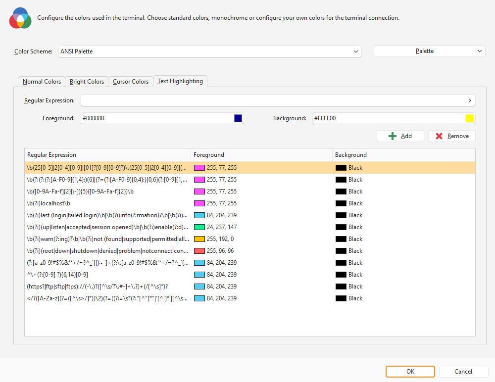

The templates with highlighting you have here, seems to be for iTerm / Royal TSX.
How do I use it for the Rebex / Windows version?
Suggestions highly appreciated.I really miss the syntac highlighting from SecureCRT and Bobaxterm.

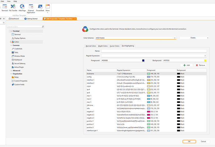

@Thomas
Using below instructions, Ive compiled this template. Feel free to use it.
Lab-Win.rtsz (17.2 KB)
