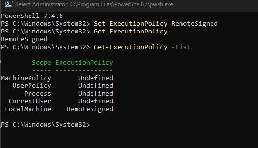

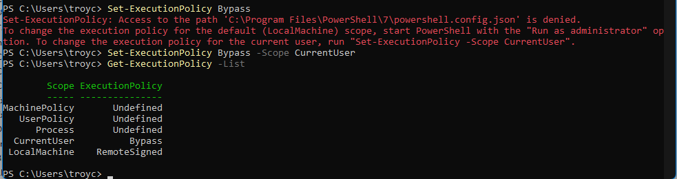

When attempting to do what I mentioned in the subject I receive the following error, this is on Windows 11 24H2 fully patched. I also set the following settings and as of now they both sit at bypass.
An error occurred while executing the dynamic folder’s script: “File C:\Users\troyc\AppData\Local\Temp\Royal TS V7\DynF_866d5504-5499-4a32-a01d-12766fe08b8d_1736232706.ps1 cannot be loaded because running scripts is disabled on this system. For more information, see about_Execution_Policies at https:/go.microsoft.com/fwlink/?LinkID=135170. + CategoryInfo : SecurityError: (:slight_smile: , ParentContainsErrorRecordException + FullyQualifiedErrorId : UnauthorizedAccess” ****

you may need to set the execution policy to Unrestricted in order to make it work. Also check the Options -> Dynamic Folder page to see if you are referring to the PowerShell 7 executable:

I found out a way, for others sake I’ll post it here. This is on Windows 11 Pro 24H2.
In addition to Set-ExecutionPolicy RemoteSigned
I did the following;
Create a GPO and go to Local Computer Policy > Windows Administrative Templates > Windows Components > Windows Powershell > Turn on Script Execution set to Enabled and set execution policy to allow Local and Remote Signed scripts.
