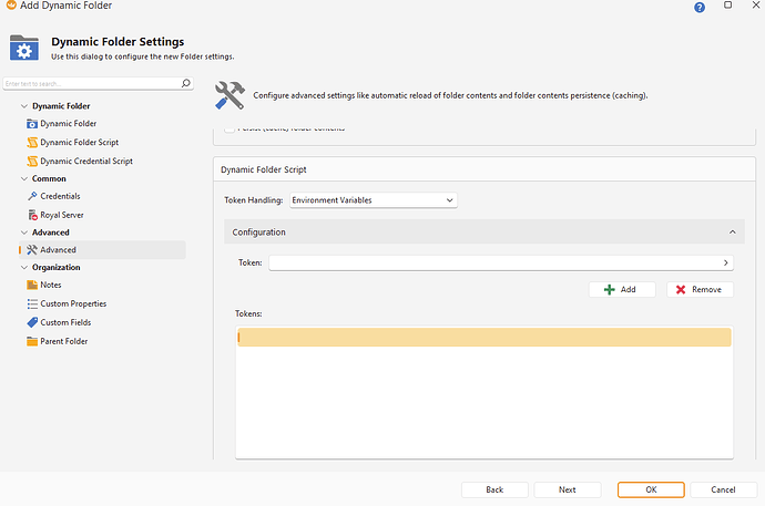

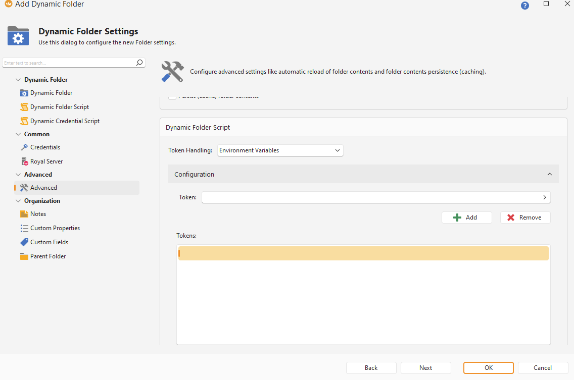

  • I found another bug in beta 7.3.11022: if you enter nothing in the text box next to “Token” but press “Add”, a blank line is added to the list of “Tokens”.
  • How are JSON environment variables implemented?
  • The documentation should provide an example specific to the selected language. For example, in PowerShell give the example “$env:DynFolder_EffectiveUsername” and do the same for other languages. Or at the very least, add a link to a more detailed documentation web page.
Damien
Hi Damien,
thanks for the feedback once again. I’ve fixed the issue where empty tokens can be added to the list.
