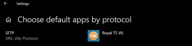

I would like to see an interface for setting Royal TS as the default application to handle protocols in windows. Specifically I am looking for FTP and SFTP.
I imagine it could be a checkbox list of protocols in Royal TS Options. When checked, Royal TS would open ftp:// and sftp:// when clicked as a new ad-hoc tab. Not necessary, but if the uri is already connected, it would just change folder paths.
