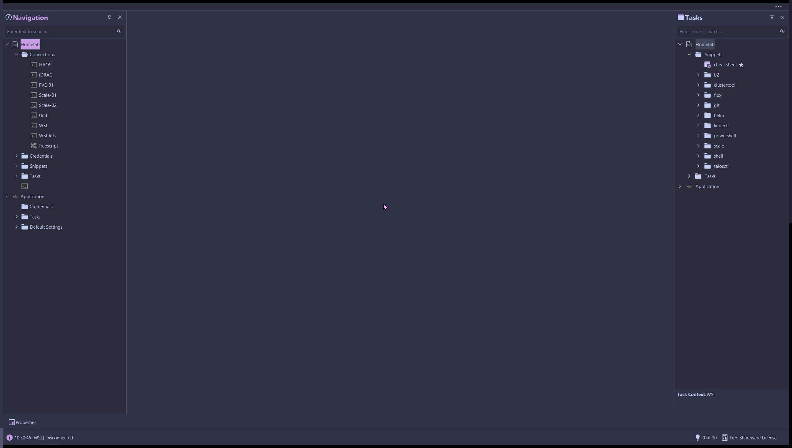

Add a New SSH Connection:
- Open Royal TS and create a new SSH Connection
- Choose the Rebex Terminal for your connection

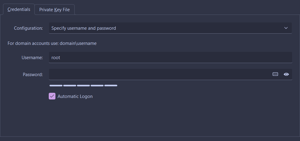

4. Configure Connection Credentials
- Under Common > Credentials, fill in only your username for the server.
- Leave the Private Key tab empty.
The 1Password SSH Agent will handle the handshake automatically.

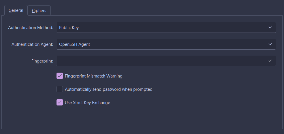

5. Configure Advanced Security Settings
- Navigate to Advanced > Security:
- Set Authentication Method to
Public Key. - Set Authentication Agent to
OpenSSH Agent. - Enable Use Strict Key Exchange.
- Leave the Fingerprint field blank; it will populate automatically on your first connection.
Optional: You can enable Fingerprint Mismatch Warning if needed, but this might become annoying for local, unexposed servers.
Do not modify anything under the Ciphers tab.
