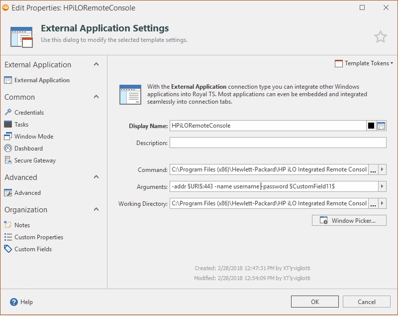

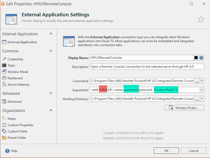

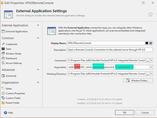

I’ve created a new external application (see attachments).

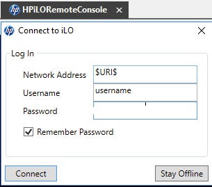

$URI$ does not work, I just see $URI$ in the field when i launch the app, while “username” and $CustomField11$ works fine as you can see
any idea on how can I make $URI$ work as well there?

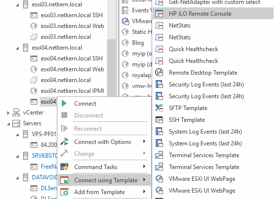

I just was able to get it working here. I guess you’re creating a usual External Application-connection, and not a ExtApp-template - right? You can create templates via “Ribbon -> Templates -> Add new Template -> External Application”. Then it’s working just fine - see my attached screenshot.

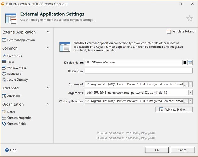

i think you are right and it makes sense. I’ve recreated it as a template but when I try to initiate a connection as shown in your screenshoot, this time it attempts to connect but then it just disconnect straight away. I don’t see anything in the logs that can be useful to troubleshoot, any hints would be great.
Pls see attachment that shows how I setup the external application template.
Patrik, many thanks! That’s exactly right!
