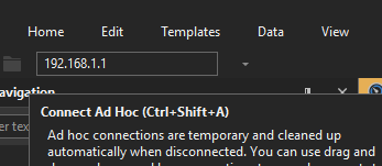

I just added the ad-hoc connection box to the quick launch bar (sorry I said ribbon before) so I could type in an IP and hit enter, which normally brings up a selection dialog to choose how to open that connection
This works fine the first time. If I try to open a second, that selection dialog will flash and disappear, preventing me from selecting the connection type. I did discover that if I add the “dashboard” back so I have another tab to select I can get a second ad-hoc to open if I have the dashboard tab selected instead of the terminal session tab. So I at least have a work around for this.

Thanks for the details. Putting this in the QAT will only work if you also put the button below (with the popup menu) into the QAT. Can you try that and see if this resolves your issue?
Putting the button in doesn’t resolve the ENTER selection dialog failure for the additional ad-hoc windows, but I can click it to open additional sessions. The behavior of typing an address and simply pressing ENTER, regardless of open number of sessions or selected tab used to work at some point in the past, but at least I have a few options figured out for going forward.
