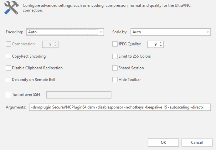

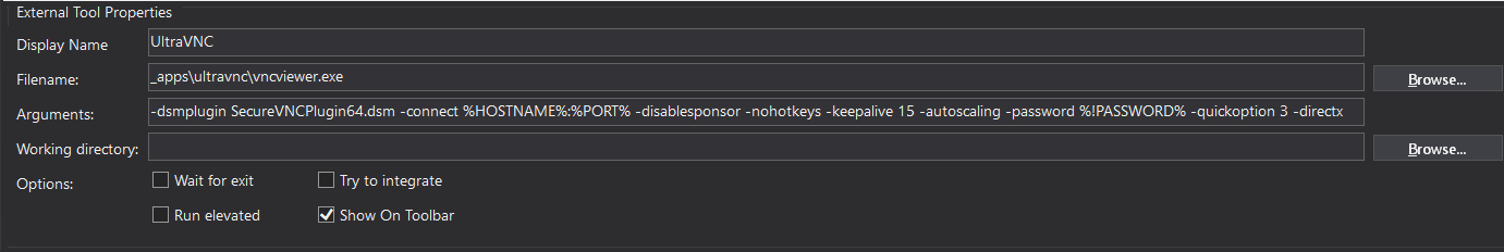

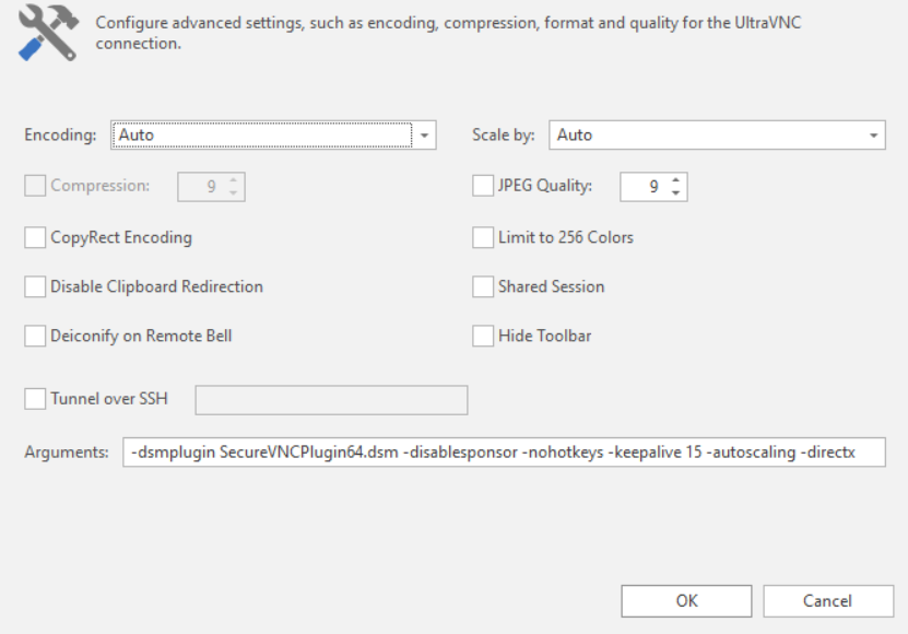

Arguments used (mRemoteng vs Royal TS):

So I moved the portable installation to another pc, a HP Elitebook 840 G3 (Intel i5-6300u/16GB RAM/NVME SSD) with Windows 10 20H2. The result is exactly the same, a 7 second delay when starting an UltraVNC connection. So it seems this delay is not due to processing power since this is a quite slower and older CPU but the delay is exactly the same. UltraVNC and Royal TS versions are the latest available.
There is virtual no delay if:
  1. I start vncviewer.exe from file explorer and use dialog to connect
  2. if I create a batch file with the exact same parameters and run in from command prompt
  3. if I create a task in Royal TS that runs vncviewer.exe, and start the connection that way
I have captured a video showing the exact situation with verbose logging enabled:
https://www.youtube.com/watch?v=EFz14q4lQiU
Only thing i haven’t tried is to install Royal TS to program files, not use it as portable app, but i doubt it will make a difference.
Regards
Lum

  2. With Sysinternals Process Monitor, I found that Royal TS uses this kind of command to start UltraVNC:
     "D:\Dropbox\RoyalTS_6.00.51119.0\_apps\ultravnc\vncviewer.exe" TEST_CLIENT:55948 /password "XXX" /autoscaling /normalcursor /disablesponsor /nostatus /dsmplugin SecureVNCPlugin64.dsm
  3. I copied the exact above command to a cmd prompt and ran it, and i encountered the exact same 7 second delay, so the problem is not related to Royal TS, but somewhere in the above command
  4. After some tests, the “/nostatus” flag seems to be the problem. If you start UltraVNC without the “/nostatus” flag, it starts immediately.
Conclusion: When using the UltraVNC encryption plugin (SecureVNCPlugin64.dsm) and the “/nostatus” flag, UltraVNC has an approx. 7 second delay to connect. Unfortunately, in Royal TS there is no option to enable/disable the “/nostatus” flag. I have already reached out to UltraVNC developer, but i am unsure if there will be any resolution from their side.
