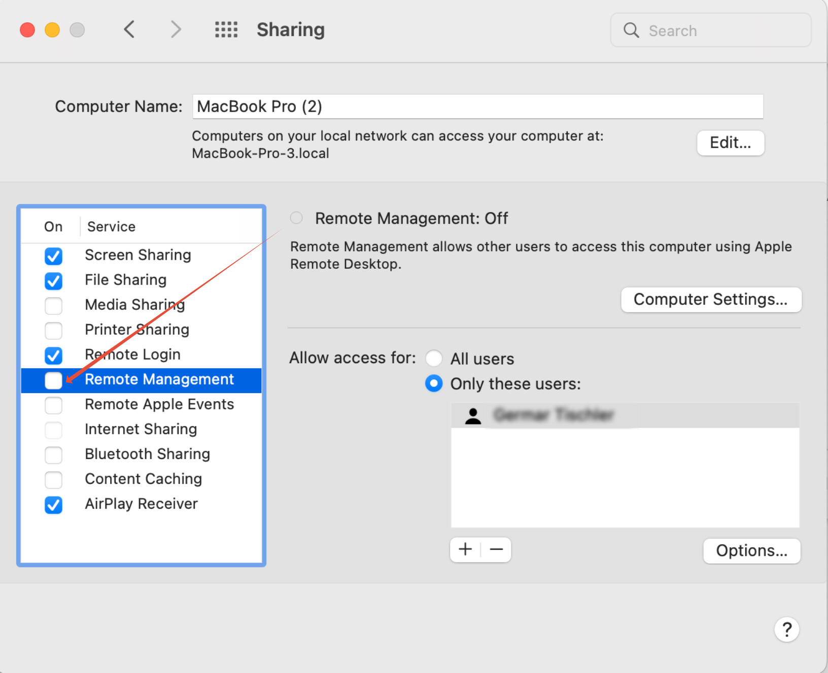

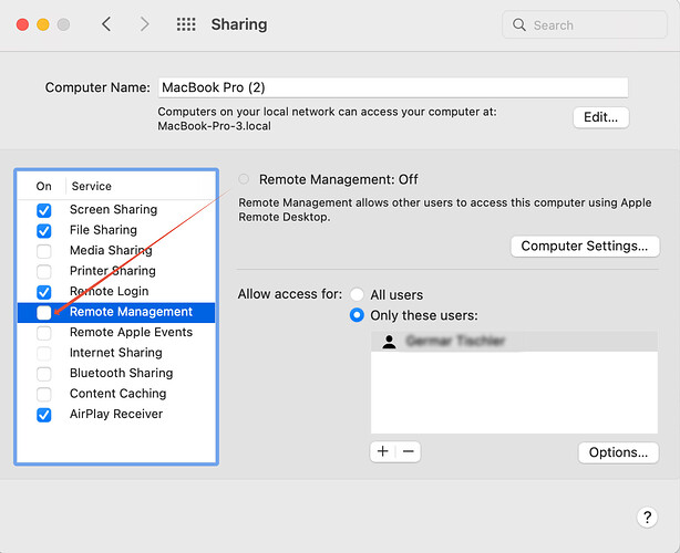

The solution to this issue is to set a VNC password. To do this, please go to “System Preferences - Sharing”. If Remote Management is turned on, turn it off. The reason for this is that you can’t have both Screen Sharing and Remote Management on at the same time:

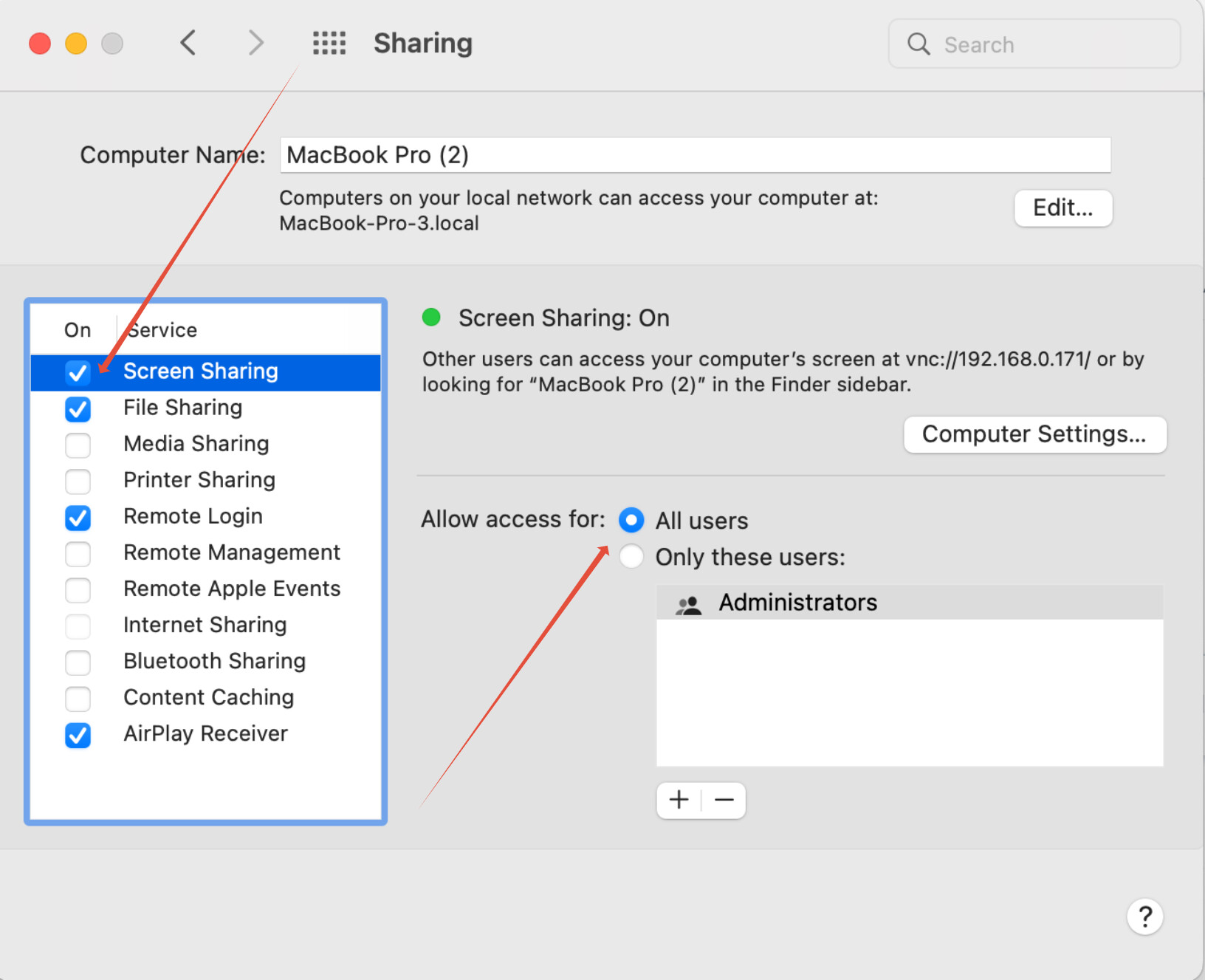

Then enable “Screen Sharing” and specify who can share your screen:
All users: Any of your computer’s users can share your screen, except sharing-only users and guest users. If your Mac is connected to a network account server, anyone with an account on that server can share your screen using their network username and password.
Only these users: Screen sharing is restricted to specific users.

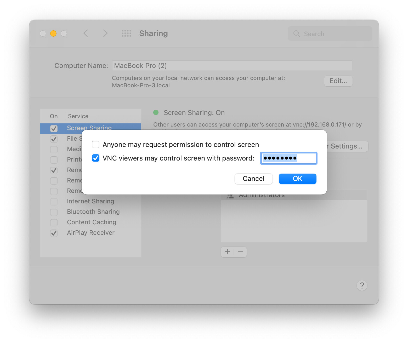

To set additional options for screen sharing, click “Computer Settings” and then select one or both of the following:
The default setting would be to enable “VNC viewers may control screen with password” and to configure a password as seen in the screenshot above.

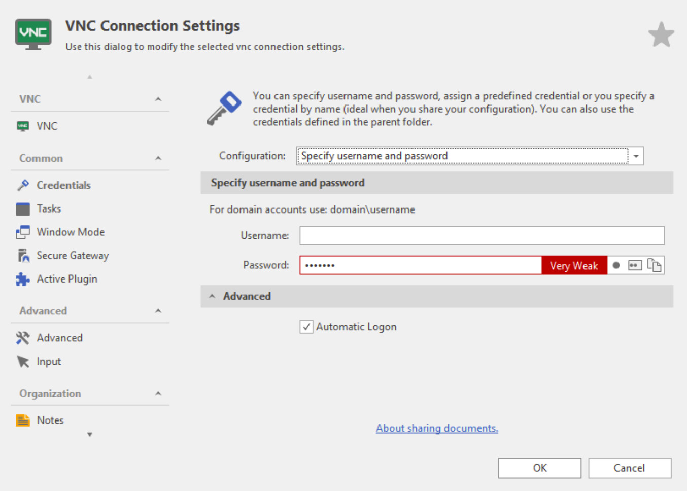

Last but not least, you will have to configure the credential in Royal TS as follows:
Important: Make sure you do NOT set a username. The password you need to set in Royal TS is the password you set for the VNC viewers, NOT the Mac OS account password.
