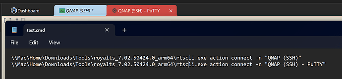

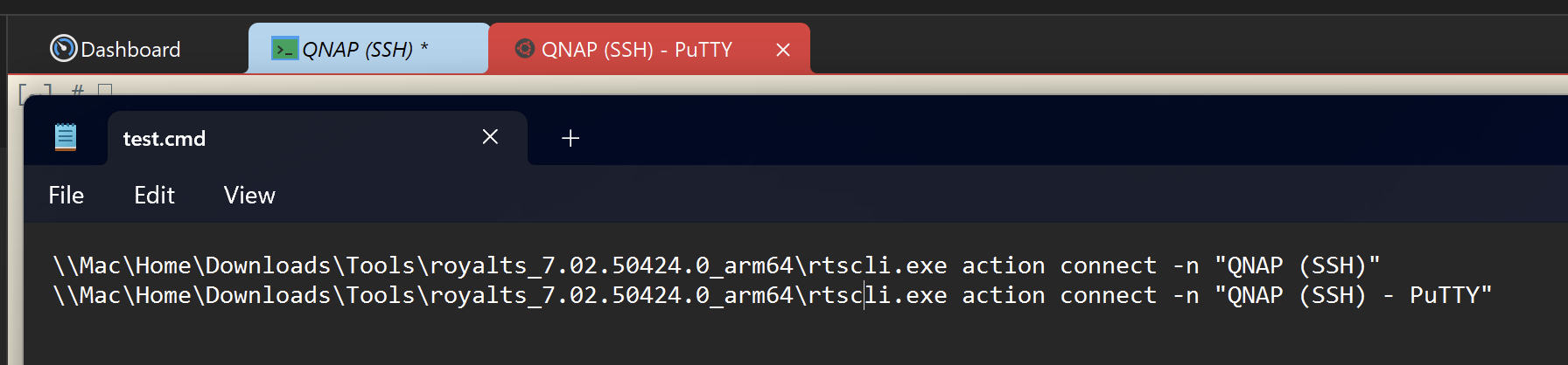

Maybe you misunderstood. There’s no script or special syntax necessary for multiple connections. You simply have one line in your batch file to connect to connection 1, in the next line in your batch file you connect to connection 2, and so on. It’s as simple as that.
Aaaaaaaah, now i understand Stefan, thanks for clarifying
Works as intendet
