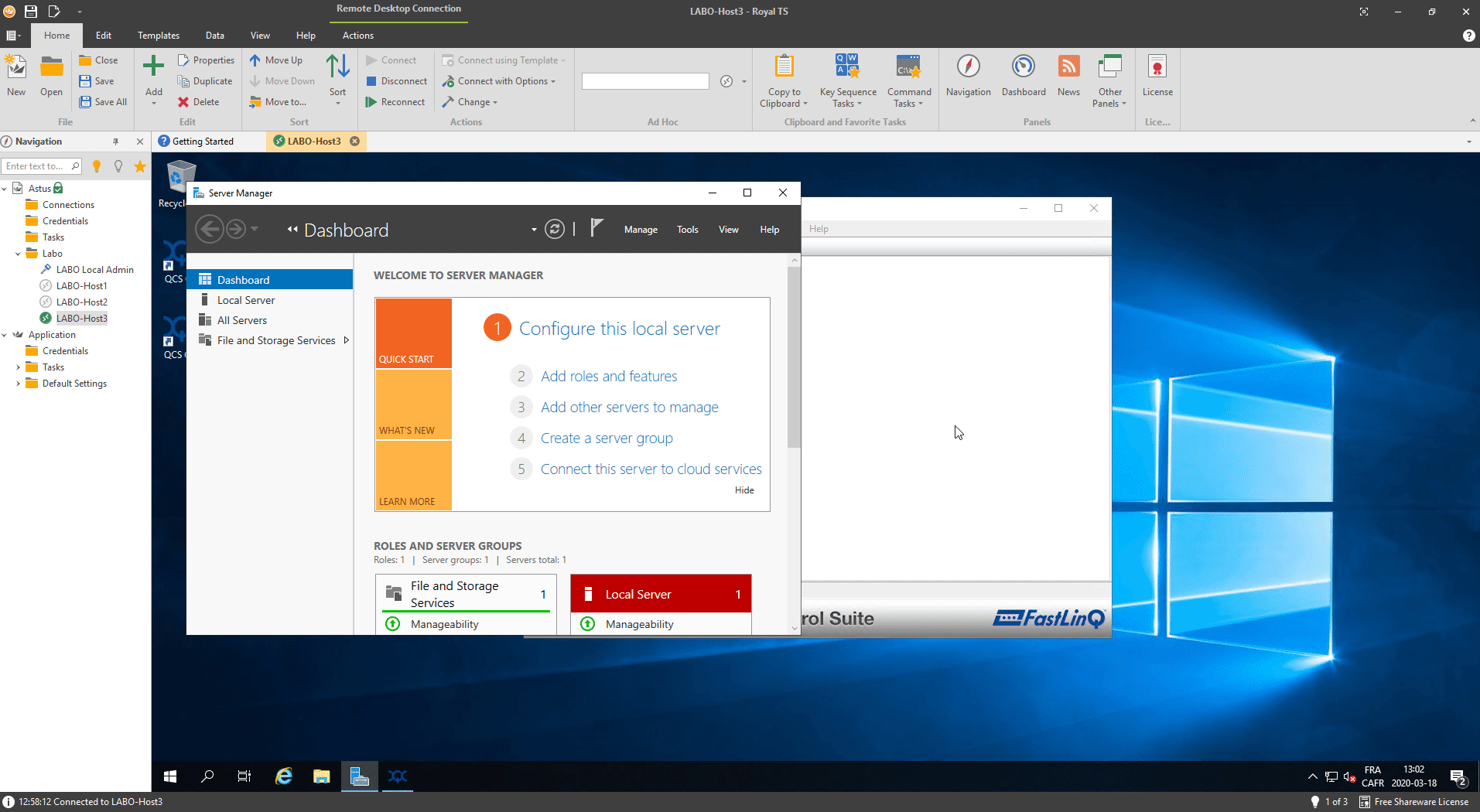

When resizing the main windows, the smart reconnect would fail one every two resize.
Please see joined gif

with fast smart reconnect, I first had to reconnect my existing sessions, and now it works fine!
