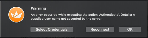

It seems that since the RoyalTSX upgrade I had recently I can’t connect to my sftp connections. I get the attached error. I open the same document in windows and the connection works just fine. I recently switched from a windows laptop to a mac and this used to work but now does not.

found this in console,
=x= Error - Plugin - Rebex.Net.SftpException: A supplied user name not accepted by the server. —> Rebex.Net.SshException: A supplied user name not accepted by the server.
at Rebex.Net.SshSession.mlxr (System.String ahg, System.String ahh, System.Boolean ahi) [0x0034b] in <6eed1ee1e36b4ed9b3052dd60b1a20b5>:0
at Rebex.Net.SshSession.mlxs (System.String ahj, System.String ahk, Rebex.Net.SshPrivateKey ahl, Rebex.Net.SshGssApiCredentials ahm, System.Boolean ahn) [0x007d6] in <6eed1ee1e36b4ed9b3052dd60b1a20b5>:0
at Rebex.Net.SshSession.Authenticate (System.String userName, System.String password, Rebex.Net.SshPrivateKey privateKey) [0x0003f] in <6eed1ee1e36b4ed9b3052dd60b1a20b5>:0
at Rebex.Net.Sftp+adkc.afib (System.String all, System.String alm, Rebex.Net.SshPrivateKey aln, nuhi alo) [0x0001e] in <71558a0ff34b4b5a9c21a773d17ccae3>:0
at Rebex.Net.Sftp.hxsn (System.String pu, System.String pv, Rebex.Net.SshPrivateKey pw, nuhi px) [0x00105] in <71558a0ff34b4b5a9c21a773d17ccae3>:0
— End <…>
even though the username is correct, i have uninstalled the plugin, reinstalled and still same error.

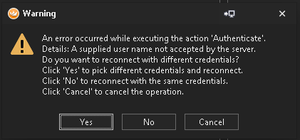

If I upgrade Mac to version 4.2 that’s when it breaks. If I download version 5.1.61104 for windows and load the same document with the same sftp connections. I get the attached error when using an SFTP connection. so it appears broken in both new versions. Even though the credentials haven’t changed something isn’t passing them correctly. Even if I manually type a username and password that is valid, it still doesn’t log in.
