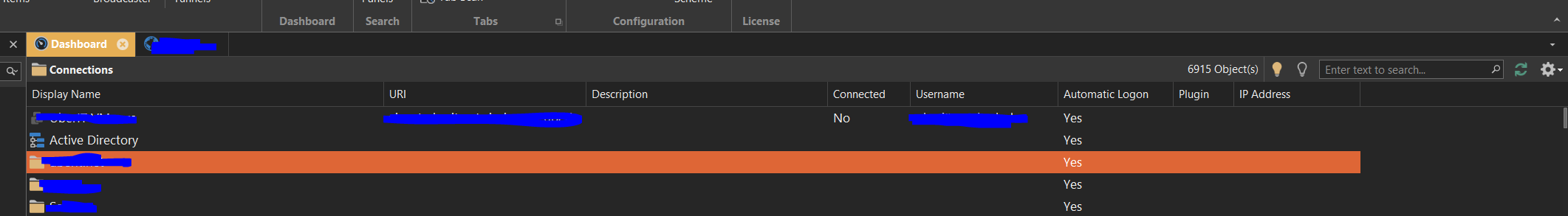

I keep on setting which columns I was at the top folder within the document (removing some standard ones and adding others) but it keeps re-setting. This is a lock down document but apart from that I cant see any options to set the default columns within the menu?
Similarly, I couldn’t see a reference in the scripting section about if this is setable as a default config in a JSON file. Is this the case?
Thanks

can you clarify (maybe with screenshots) what column layout you are referring to?
Sure. This is on the dashboard/folder views.
In this example I have added the column “IP Address” and would also remove “Plugins” for example, but this does not persist between launches
The layout of the grid is stored in the code4ward.RoyalTS.UserPreferences.config (in %appdata%\code4ward) file in the DetailsGridLayout property. The data/format (XML) is basically the serialization of DevExpress’ grid configuration. You can inspect the content of the property after you configured it how it should look and apply that using the configuration system as described here:
https://docs.royalapps.com/r2021/royalts/advanced/default-settings.html
Does that help?

I haven’t tested it myself but in theory you just need to escape this string for json and put it into the DetailsGridLayout property:
    "RoyalApplicationSetting" : {
        "DetailsGridLayout": "&lt;XtraSerializer version=\"1.0\" application=\"View\"&gt;\r\n  &lt;property name=\"#LayoutVersion\" \/&gt; ... ",
I had to convert the detailsgridlayout xml portion to a single line first before escaping it for JSON.
After I did that it worked fine!
