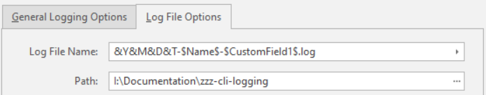

It seems that overriding logging doesn’t work.
If I’m defining the override directly on the devices it works, But if I’m using override nothing happens.
Issue is on RoyalTS and TSX

I just tried to reproduce the issue and here’s what I found out:
the override actually works (when applied). A log file will be written and can be seen using the file explorer at the location of the override log directory.
since the log directory is configured in the override but not in the connection itself, the dashboard actually doesn’t know where to look for the log files, hence you don’t see them.
overrides are only applied when connected. the dashboard shows data according to the configuration of the connection when not connected.
if you want to see the log files in the dashboard as well, you need to configure logging on the actual connection, not the override.
I hope that explanation makes sense.
