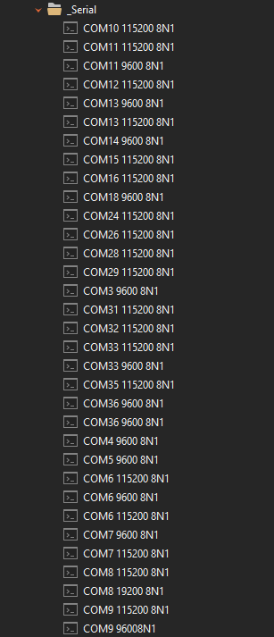

I’ve submitted this RTS Dynamic Folder to the RTS toolbox repo which will create a set of connections for all available serial ports with various (configurable) speed and framing options. On my system the result looks like this:

This script utilizes PowerShell to generate a list of available serial devices, along with RTS Custom Properties defining speeds and framing settings, to generate a set of Terminal connections for each combination of port/speed/framing.
The resulting folder structure will look something like the following:
Attached Serial Devices
|-- USB Serial Device (COM12)
|   |-- COM12 9600 8N1
|   |-- COM12 9600 7E1
|   |-- COM12 19200 8N1
|   `-- COM12 19200 7E1
`-- USB-SERIAL CH340 (COM34)
    |-- COM34 9600 8N1
    |-- COM34 9600 7E1
    |-- COM34 19200 8N1
    `-- COM34 19200 7E1
