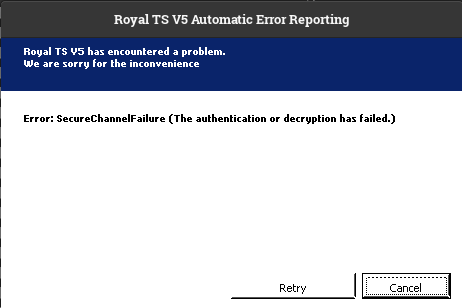

Just FYI for others trying the same thing. The 5.1 version does not seem to run under Wine (4.0.3). Running the msiexec against the installer seems to work, but once installed, running the RoyalTS.exe generates an error message. See attached picture.

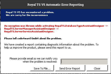

I was not able to due to an error that followed when I tried. See attached error pic.
I’ve attached the error file if that helps.

Hi John,
the crash seems to originate from a WMI call to read out the OS info. The latest (5.2) release should handle this exception and Royal TS shouldn’t crash because of that. Can you check?

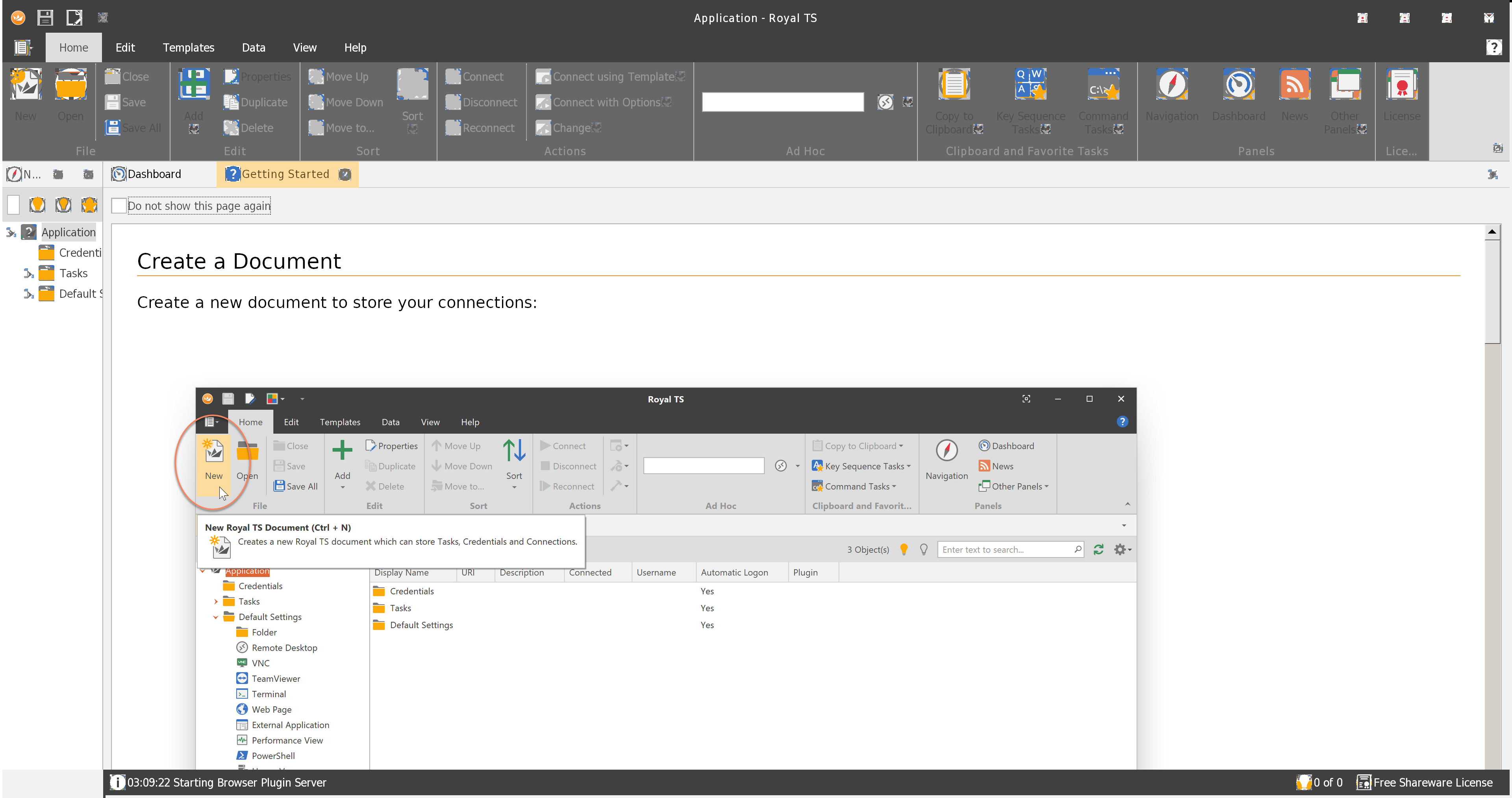

I can start Royal TS 5.2, I get an error during launch which I click ignore and then I can see the main screen.
The software does appear to work, I can go into options, create connections etc…
I’m using KUbuntu 19.10 with Crossover Linux 19.0.1.
I installed into a 32bit Win 7 container with: C++ 2015 and .NET Framework 4.7.2.
What other software did you install in the container? I think I’m extremely close to having a Royal TS running with Crossover but suspect I’m missing some component.
Screenshot attached, notice the problem with icons:
