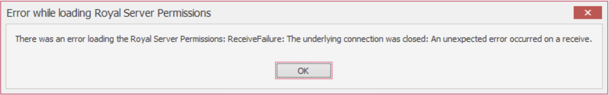

Error while loading Royal Server Permissions:
The was an error loading the Royal Server Permissions: ReceiveFailure: The underlying connection was closed: An unexpected error occurred on a receive

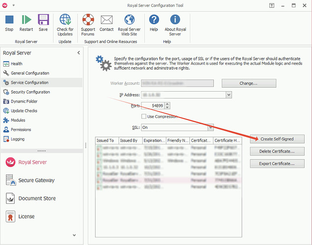

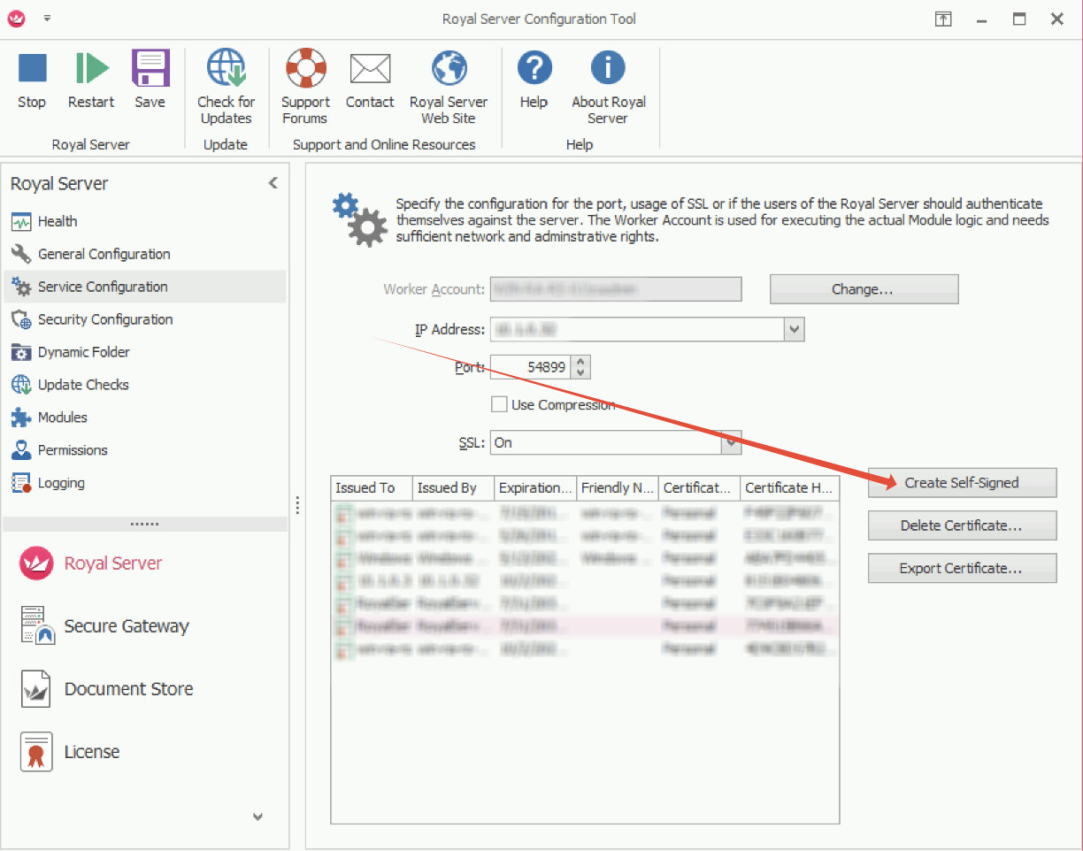

This error message suggests either a problem with the self-signed certificates or with the TLS version being used. If you get this message the first thing to check is whether or not you have already created self-signed certificates. If you haven’t, this can be done in the Royal Server Configuration Tool under “Royal Server - Service Configuration”, by clicking on “Create Self-Signed”:
If you have, please remove any existing ones and create new ones. If that also doesn’t help, then you may have a problem with the allowed security protocols. Microsoft has changed the way the OS handles cipher protocols (e.g. for SSL connections) over time and disabled insecure ones.

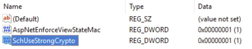

Last but not least, it is also possible that the “SchUseStrongCrypto” registry key has been removed or changed. Please check the following registry key and make sure it is set to “1”:
HKEY_LOCAL_MACHINE\SOFTWARE\[Wow6432Node\]Microsoft\.NETFramework\<VERSION>: SchUseStrongCrypto
