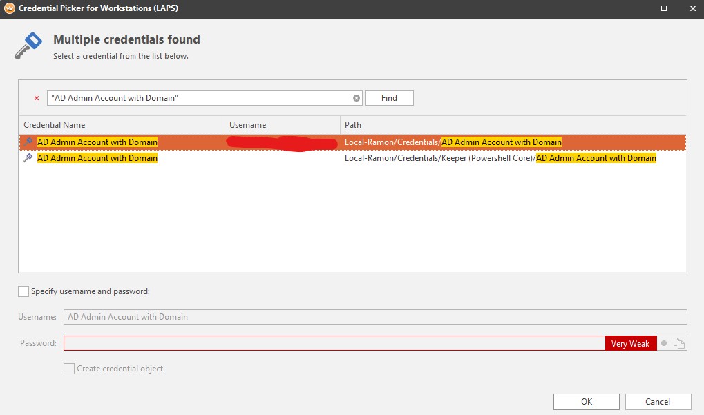

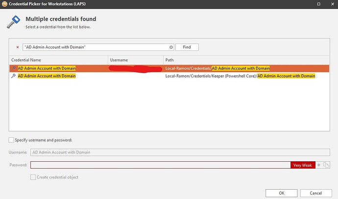

Lockdown is not enabled. However, the credential I’m trying to use is, itself, resolved through a Dynamic Folder which looks it up in my Keeper vault. I don’t know why I didn’t think to test it with a directly made credential, but when I did I can see that it is not resolving the first Dynamic Credential from Keeper even though it does see it.
In the screenshot you can see that the local credential does show the username (redacted) while the dynamic version of the same credential does not.
I can modify the LAPS credential script to directly get the credentials from Keeper, but I was hoping to keep it generic to any type of credential. Maybe cascading dynamic credentials could be a feature request?
I see. That explains the issue. Cascading dynamic credentials is not supported and we do not have plans at the moment to implement that. Feel free to submit a feature request in the Ideas forum though. Depending on demand and available resources, we might be able to do something like that.
