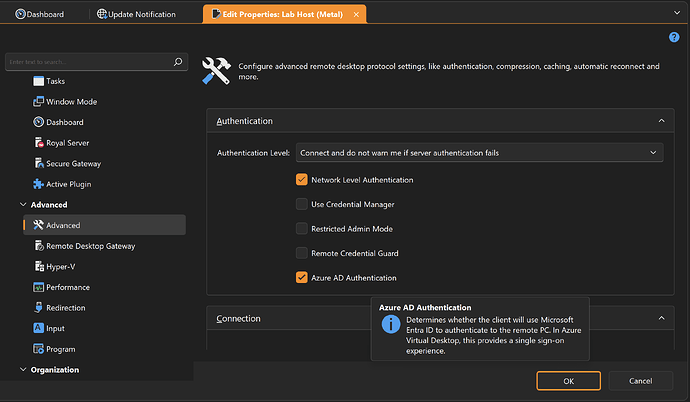

That being said, we implemented the following setting recently:
I’m not sure if this resolves your issue but I thought it’s worth a try.
