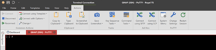

thanks for the SuperPutty link. Quite helpful, actually. I was able to implement the restart session button in the ribbon directly (also put the change settings button up there):
Will be in the next release. Thanks again for the feedback and help!

Just released a new version with that feature on board:
https://royalapps.com/ts/win/download
Working beautifully!

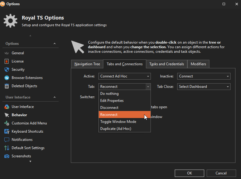

I assume it’s not possible to put things like that into the list of possible actions when clicking/double clicking/etc on tabs, due to the modular nature of things? (i.e. a tab might not even be a PuTTY tab, so putting plug-in specific things in that list is probably unwise?)
I’ve already added it to the Quick Actions Toolbar at the top of the window, but of course I sometimes forget. :wink:
(Yes, it’s a brand new feature, of course I still need to get used to it…)
Best regards
I’m afraid it’s not possible to add this to this list. The problem is, that this command is “plugin specific”. Other plugins wouldn’t know what to do because they are not PuTTY. The QAT is probably the best way to have it at your fingertips. Sorry to be the bearer of bad news.
