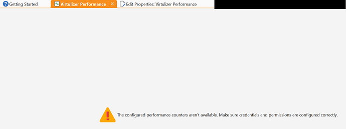

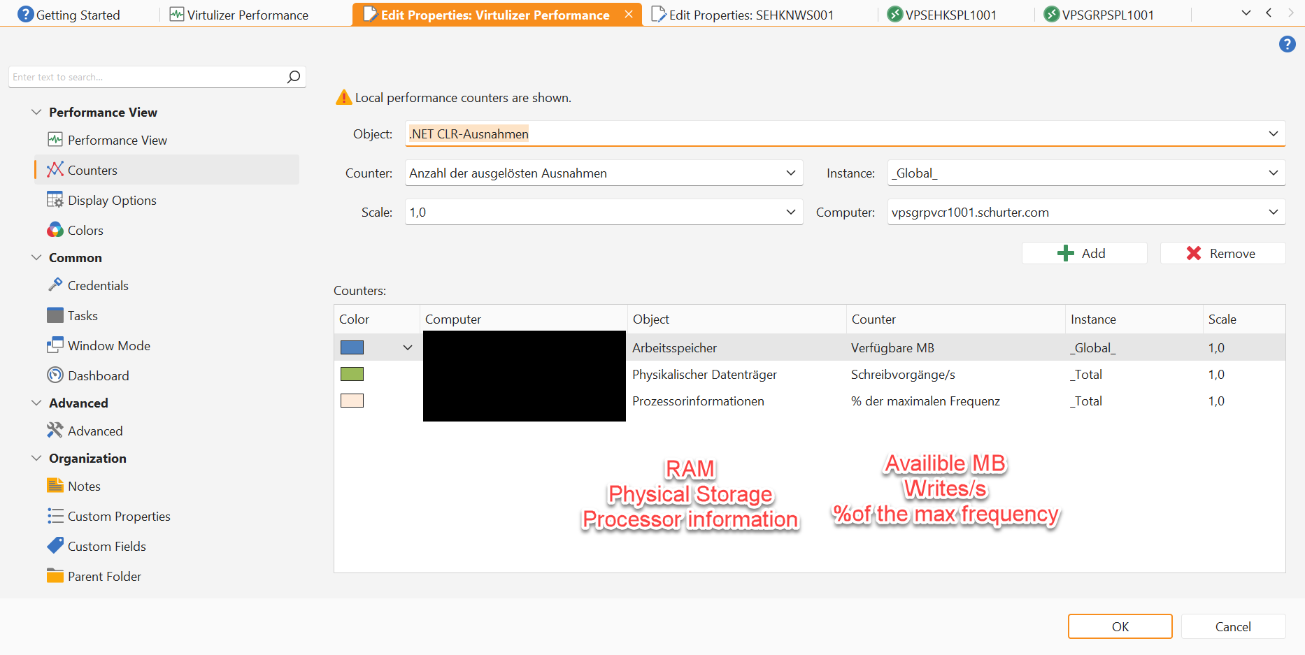

Sure. I configured the basic performancemetrics in the settingspage, that I wanted to see and hit connect. for reference, these are the metrics, and a screenshot of the error:
Screenshot of the settings translated in order:
I suspect you are using the Performance View but this will only work with Windows Performance Counters of ESXi instances running Windows. Do you want to see perf data from ESXi itself?
Ohhhh… Well, it was the idea to use it on ESXi itself, and yes I am using the performance view. But if this only works on Windows machines, I suspect I would only be able to use it on something like Hyper-V…

I’m afraid you can’t use the performance view for the ESXi host directly. To be honest, I’m not sure if VMware has even an API to get performance data at that level. The performance view only works with Windows performance counter. Sorry to be the bearer of bad news.
