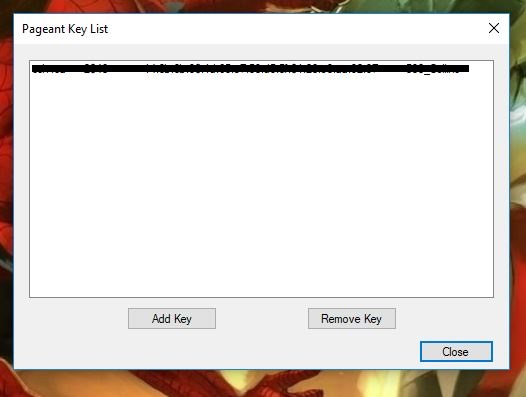

Hi Further to this.

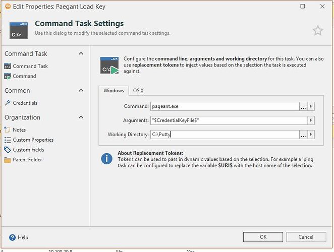

I have successfully created a task in Royal TS and when double clicked it does prompt for password and loads key when entered:

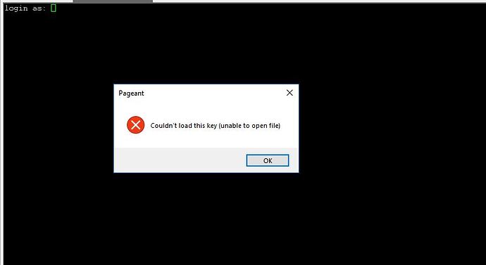

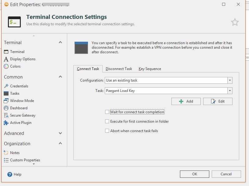

However if i add the task to be executed on connection i get the below error:

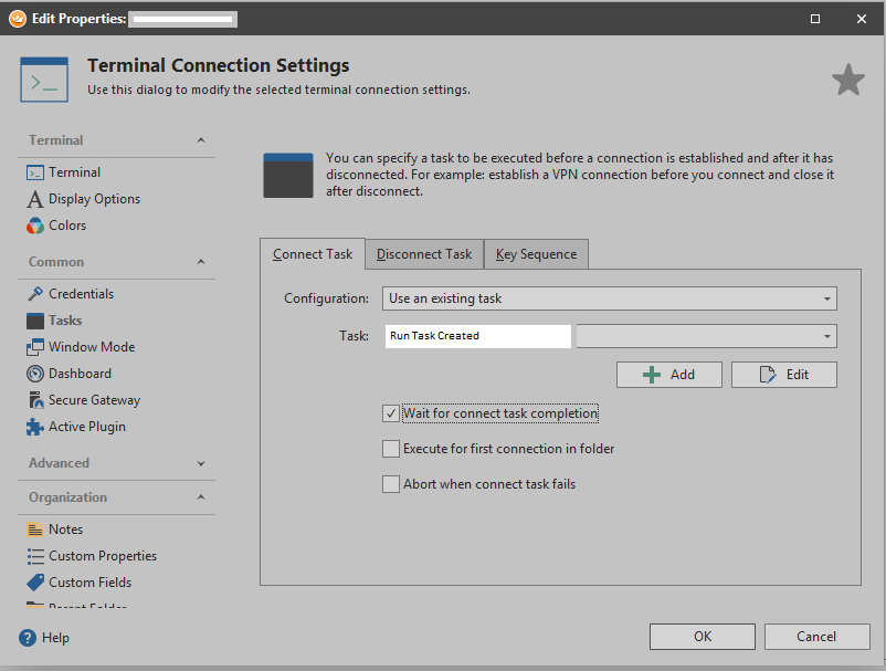

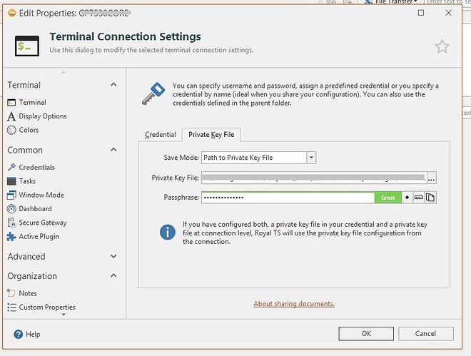

My setup in the terminal is as follows:
Im not sure why right-click on task and execute is working but triggering from terminal connection is not.
Ideally it would be nice to get Royal IT to enter the password too however i think this would need to be an integrated application in order for that to occur as paegant doesn’t have a command to pass the password.
Hope this helps clear up what i was trying to achieve from my request above.
thanks,
I see that you haven’t enabled the option “Wait for connect task completion”. If you check that, would it work then?

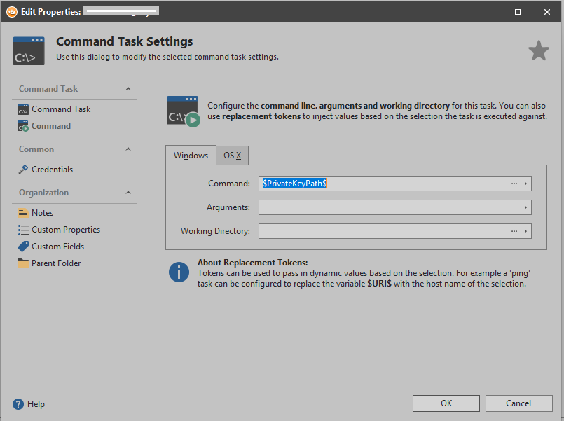

So I have managed to get it to work to a point. I still need to manually enter a password in but i can get the file to load each time.

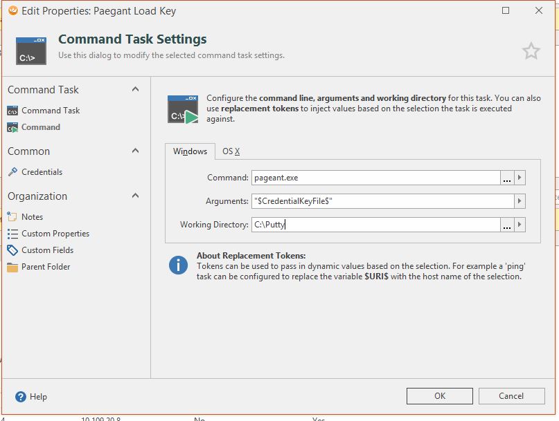

Basically instead of trying to get Royal TS to load the application, i simply use a “Task” to run the file, which Windows opens with its default application (being pageant).
Setup is as follows:

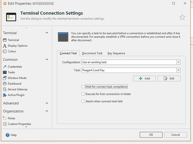

Command Task created and Named:

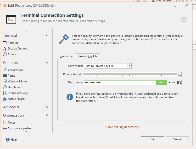

For the “Command” I point it to the $PrivateKeyPath$ specified in the terminal session. (this is determined by the application in its nested Folder.See below for folder structure)

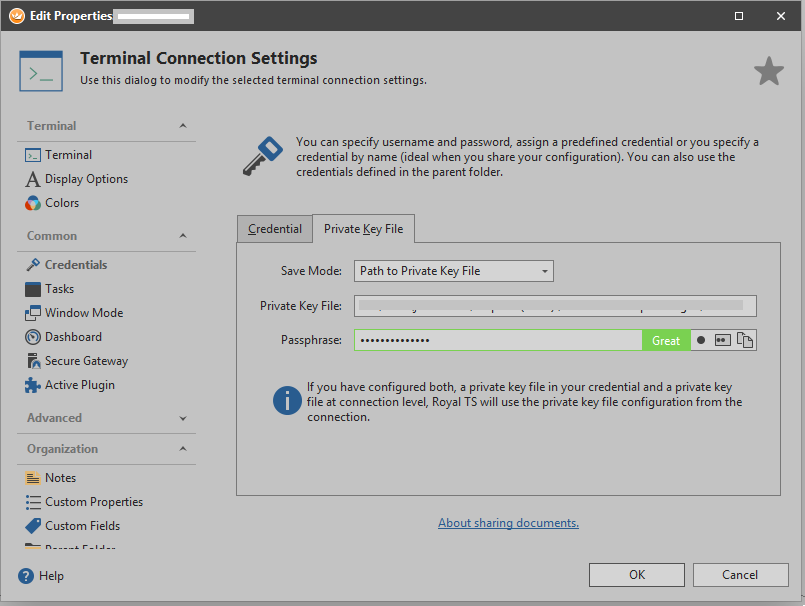

Again, in the terminal session i specify the Private Key path:
And then Specify the Task created above to Run:
Running the Terminal, then loads the key into Pageant which prompts for password:

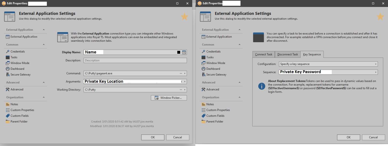

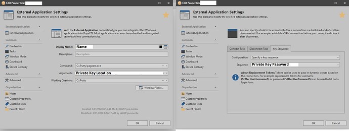

You can achieve this now by using “External Application”. Point it to Paegant.exe and even under tasks set the password and it automatically loads the app and inserts the password with only “OK” needing to be clicked.
See attached image of how i got it working. Closing connection also closes paegant so its a win win.
