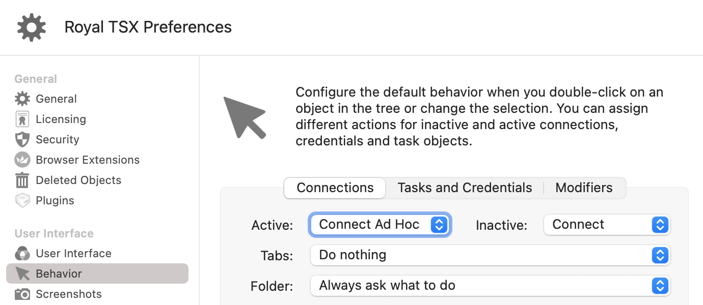

by default, you can right-click on the active tab that you would like to duplicate and select “Duplicate (Ad Hoc)”. Alternatively, you can also change the behavior of double-clicking on an active object in the Navigation Panel. This can be done under “Royal TSX - Preferences - User Interface - Behavior - Connections”. By changing the “Active” settings to “Connect Ad Hoc”, Royal TSX will create a “Duplicate (Ad Hoc)” connection when you double-click on an active connection object in the Navigation Panel:
