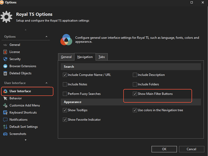

Unfortunately, the hotkey, Control F that is associated with it invokes FIND and doesn’t toggle the Favorite on or off. It’s a button I clicked a dozen times a day, now you have to go find it in a sub menu. At least make the hotkey work if it’s going to be nested in a menu now instead of a clickable icon some where if possible.
Hi Troy,
if you press Ctrl + F and then hit the F button again, the ‘Favorite’ filter will be applied.
Furthermore, you can display the icons in the Navigation Search bar, by heading to the User Interface options and enabling the ‘Show Main Filter Buttons’ checkbox.
The icons should then show up again:
