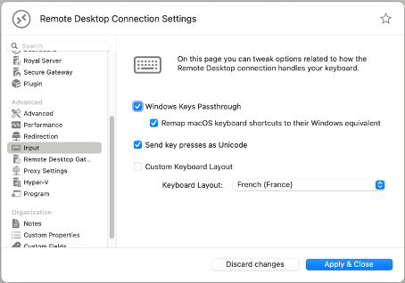

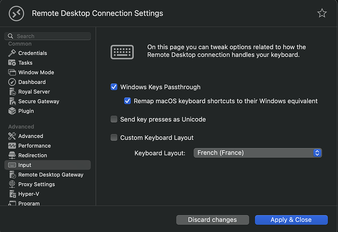

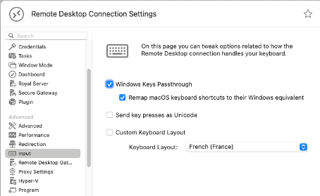

could you please try setting the Keyboard Layout to “French (France)” and let me know if this worked?
Furthermore, please also try toggling the “Send key presses as Unicode” option in case changing the Keyboard Layout did not work.

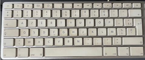

My french keyboard
keys :
With this
configuration, this is not correct
8 write _
6 write –
@ write ²
Shit + @
write nothing
£ write *
Shift + £ write
µ
Shift + $ write £
I can’t
write \

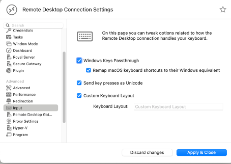

With this
options
or
Only one problem,I can’t write \
