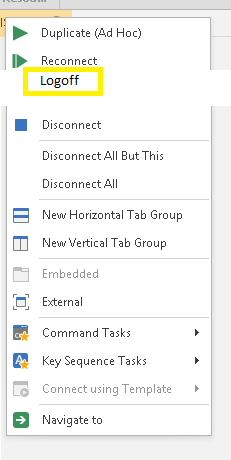

Logoff RDP Session through rightclick on TAB
What would be realy helpfull would be the posibillity to habe an option “logoff” if you rightclick on the RDP Tab (like the disconnect Tab)
Thanks!
Pat
