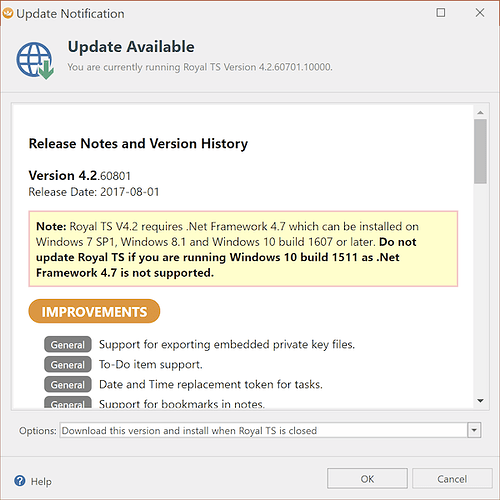

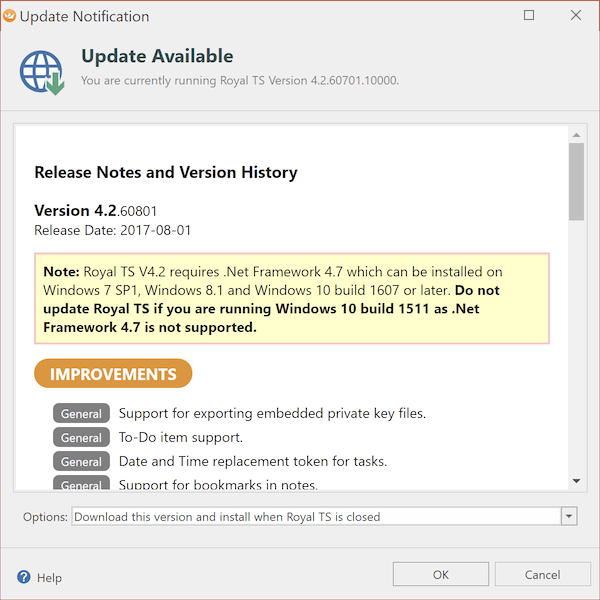

I’m sorry you faced issues with the upgrade. Please accept my apologies but I want to mention that we put in a warning in the update notification to make users aware of the .NET framework issue:
