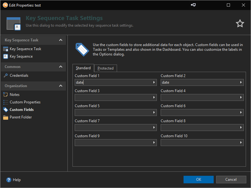

That didn’t work. I’ve attached a couple screenshots showing how the task is set up. It will run the first alias correctly but the second one it will simply output $this.CustomField1$ to the terminal.

It seems there’s an edge case in the token parser which gets confused when you start with something like $update. When you put a blank behind the $uptime it should help the parser to know that this is not a token. Can you try this workaround with your V4 version?
HEY that worked. If I have the key sequence like this it works.
$update<space here>
$this.CustomField1$ (passes the word “date” as defined in the custom field 1 slot for this key sequence task.)
