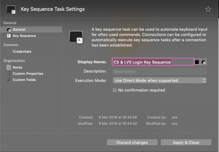

Thank you very much for your great support. I am currently running Royal TSX v4.0.0.27 and see this behaviour. The «Direct Mode» is the default mode and enabled (see attached Screenshot) and I am still seeing this issue. Of course it says «Use Direct Mode when supported» but what are the prerequisites for that support?
Pascal
Hi Pascal,
direct mode requires each connection plugin to implement this mode so “when supported” means Royal TSX will use direct mode when the connection supports it and fall back to keyboard simulation if it doesn’t.
Currently, all main connection types and plugins (RDP, VNC, Terminal, Web) support it. Which connection type are you trying this on? Also, please ensure you have the latest plugins installed and send us a short video that shows the behavior. Also, a document containing a sample connection and key sequence task would help us reproduce the issue.
