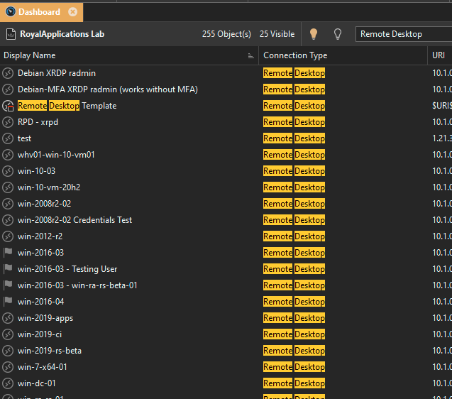

For existing objects, you can use the bulk-edit feature to edit all connections at once.
Just add the Column ‘Connection Type’ to the dashboard, and search for ‘Remote Desktop’

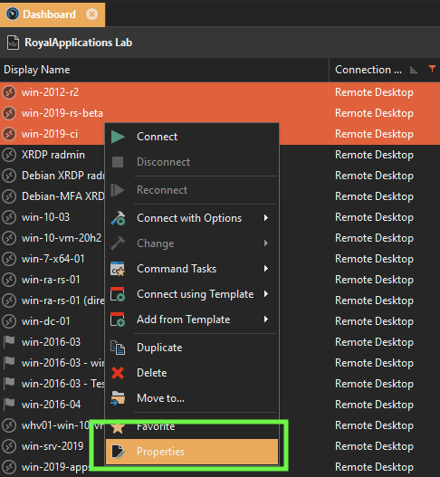

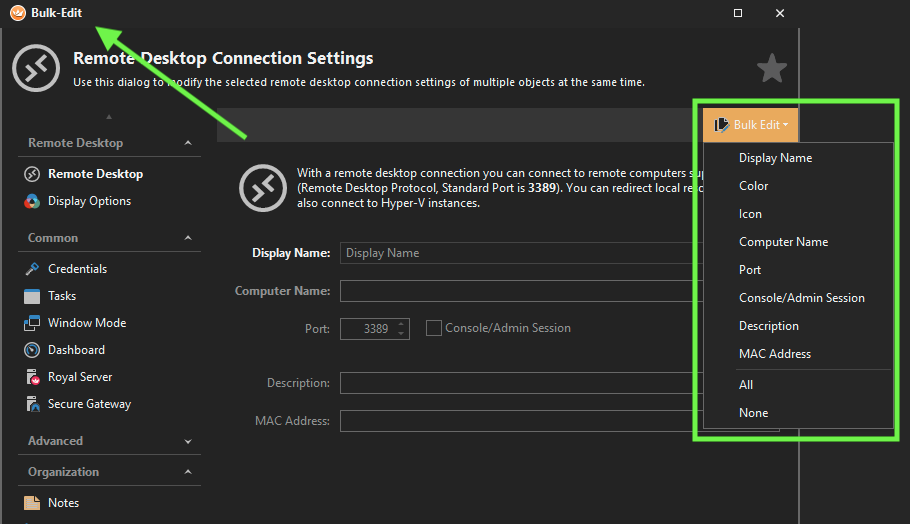

Marco,
you can Bulk-Edit several connections via the Dashboard, by right-clicking on the selected connections and clicking on Properties
After doing so, a window should open, and you are now actively in the ‘Bulk-Edit’ mode, where you can decide, what you want to edit by using the drop-down box in the upper right corner:
So no, the feature was not removed :wink:
