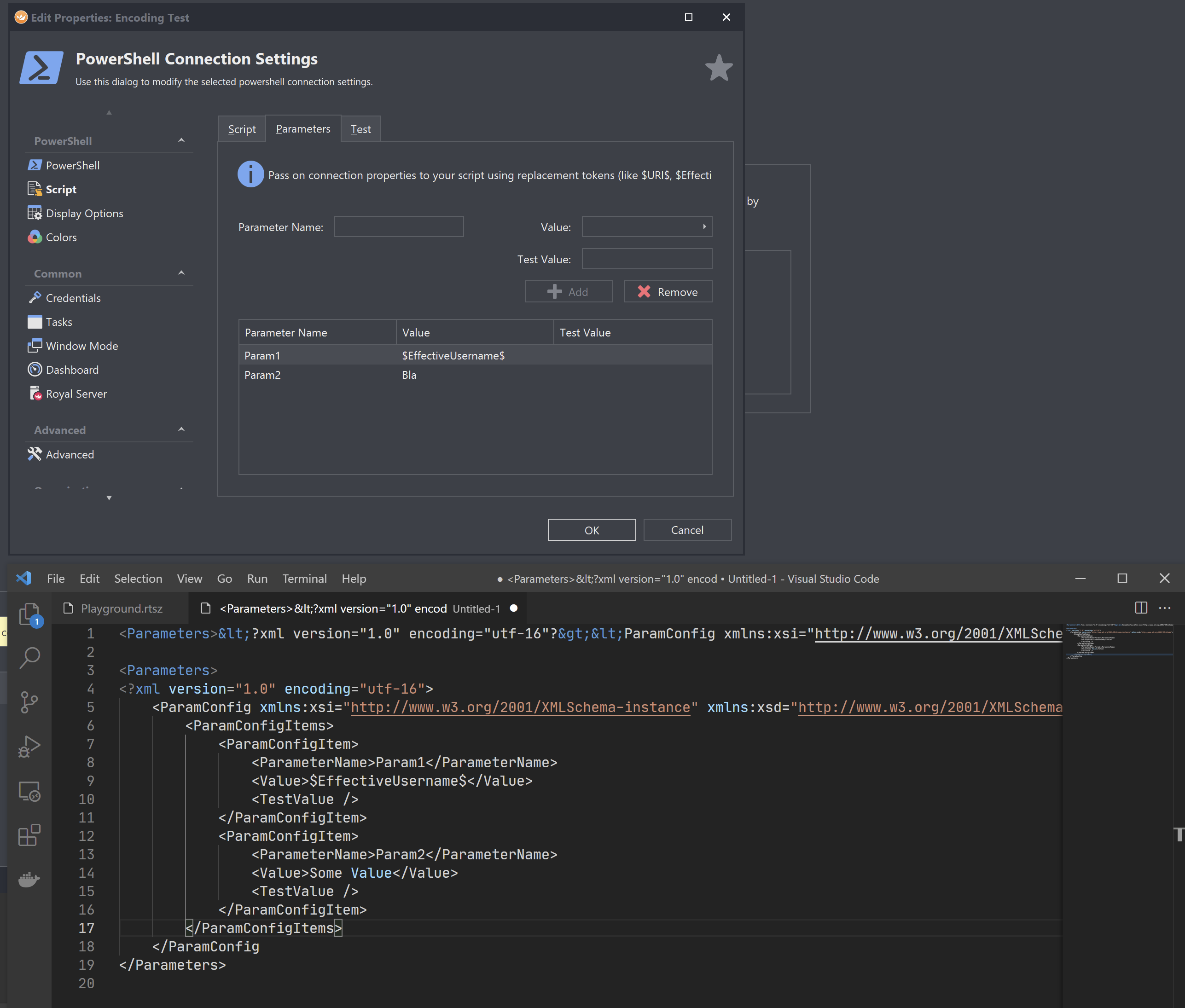

you can specify the script parameters using a simple XML encoded string. Here’s an example:
Line 4 to 18 in the screenshot above shows the XML which is expected by Royal TS/X.
Line 1 shows the actual property value as XML encoded string.
You can create the following XML:
<ParamConfig xmlns:xsi="http://www.w3.org/2001/XMLSchema-instance" xmlns:xsd="http://www.w3.org/2001/XMLSchema">
    <ParamConfigItems>
        <ParamConfigItem>
            <ParameterName>Param1</ParameterName>
            <Value>$EffectiveUsername$</Value>
            <TestValue />
        </ParamConfigItem>
        <ParamConfigItem>
            <ParameterName>Param2</ParameterName>
            <Value>Some Value</Value>
            <TestValue />
        </ParamConfigItem>
    </ParamConfigItems>
</ParamConfig>
Set this XML as XML encoded string to the Parameters property as described in the Advanced Scenarios topic:
https://docs.royalapps.com/r2021/scripting/rjson/advanced-scenarios.html
I hope this helps. I will also include the XML sample in the docs.

In my previous post, I showed you how to “build” the XML for each parameter. The XML must be inserted as “XML encoded string” into the json. Here’s the example I used:
"Properties": {
    "Parameters": "&lt;?xml version=\"1.0\" encoding=\"utf-16\"?&gt;&lt;ParamConfig xmlns:xsi=\"http:\/\/www.w3.org\/2001\/XMLSchema-instance\" xmlns:xsd=\"http:\/\/www.w3.org\/2001\/XMLSchema\"&gt;&lt;ParamConfigItems&gt;&lt;ParamConfigItem&gt;&lt;ParameterName&gt;Param1&lt;\/ParameterName&gt;&lt;Value&gt;$EffectiveUsername$&lt;\/Value&gt;&lt;TestValue \/&gt;&lt;\/ParamConfigItem&gt;&lt;ParamConfigItem&gt;&lt;ParameterName&gt;Param2&lt;\/ParameterName&gt;&lt;Value&gt;Bla&lt;\/Value&gt;&lt;TestValue \/&gt;&lt;\/ParamConfigItem&gt;&lt;\/ParamConfigItems&gt;&lt;\/ParamConfig&gt;"
Does this help?

Hi again,
sorry this took so long. I was quite busy but I had some time today to take a closer look. Here’s a quick summary what I found:
  1. I was mistaken that the parameters XML must be an XML encoded string. It actually needs to be an escaped string for json.
  2. The same applies to the script. New lines, etc. are not allowed. It must be escaped for json usage.
Here’s a working example I just tested:
    "Objects": [
            "Type": "Credential",
            "Name": "DEVuser",
            "Username": "User123",
            "Password": "mysecretpassword",
            "ID": "Dev1"
            "Type": "PowerShellConnection",
            "Name": "Powershell-Dev",
            "Computername": "localhost",
            "CredentialMode": 3,
            "CredentialID": "Dev1",
            "Description": "Dev connection",
            "Properties": {
                "DefaultOutput": 1,
                "CredentialAutologon": false,
                "Parameters": "<ParamConfig xmlns:xsi=\"http:\/\/www.w3.org/2001/XMLSchema-instance\" xmlns:xsd=\"http://www.w3.org\/2001\/XMLSchema\">\n                    <ParamConfigItems>\n                        <ParamConfigItem>\n                            <ParameterName>Param1</ParameterName>\n                            <Value>$$EffectiveUsername$$</Value>\n                            <TestValue />\n                       </ParamConfigItem> \n                        <ParamConfigItem>\n                            <ParameterName>Param2</ParameterName>\n                            <Value>Some Value</Value>\n                            <TestValue />\n                        </ParamConfigItem>\n                    </ParamConfigItems>\n                </ParamConfig>"
            "Script": "#Get RoyalTS Creds\nparam ([string] $uid,\n            [string] $userpw,\n            [string] $Param3)\n      Set-PSDebug -trace 1\nwrite-host $uid\nwrite-host $userpw\nWrite-host $Param3\nWrite-host $Param4\nwrite-host 'CredUser Name' $$CredentialUsername$$ \nwrite-host 'password' $$CredentialPassword$$\nwrite-host 'Effective user' $$Effectiveusername$$\n"
Let me know if this works for you.
