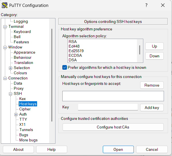

Using the Putty-based terminal, I cannot connect to a switch via SSH. It’s quite old one which I cannot update.
In Putty, I need to put “RSA” on the first position under SSH->Hostkeys.
I do not find the same possibility in RoyalTS 7.3.50320.
Would be great if you added this possiblity to change the host key configuration.

Glad to hear rebex based terminal works here. I will put this on our feature list and hope to get support for it in the 7.4 timeframe.
Small update here: next release will offer the host key configuration as found in the PuTTY settings.
Sorry for the late reply. It works great now, thanks a lot!
