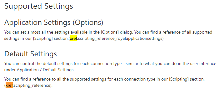

All makes sense, the only issue is that the links on that help page to the reference of all the settings seems to be dead/wrong? e.g .(xref:scripting_reference_royalapplicationsettings).
That’s strange. I tested all links and they are working for me. Which link(s) are affected?
Just in case, you were probably looking for this:
https://docs.royalapps.com/r2021/scripting/objects/options/royalapplicationsetting.html#custom-fields
Just this section
https://docs.royalapps.com/r2021/royalts/advanced/default-settings.html#supported-settings
Just:
https://docs.royalapps.com/r2021/royalts/advanced/default-settings.html#application-settings-options
https://docs.royalapps.com/r2021/royalts/advanced/default-settings.html#default-settings-1
And
Thanks! I fixed the links.
