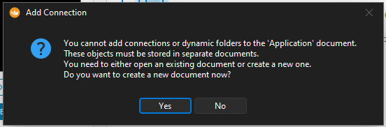

I typically install updates when Royal TS notifies me when one is available. This morning I upgraded to 7.2.50229.0 and now I cannot add connections. The app is telling me I can’t add connections to the Application document, which is not what I’m doing.

Right click a folder (not in the Applications document) –> Add –> Remote Desktop

Glad to see I’m not the only one with this problem. I can “duplicate” a connection, but cannot create a new one. Exact same behaviour as described by Chris.
Most probably after I updated to 7.2.50229 this morning.

Interestingly, I can add a new connection to my standard file if (and while) I have another (newly created) connection file open. If I close the new connection file, adding to my standard file is again not possible.
Benjamin that is what I found as well. Follow the dialogue to create a new file, leave it open, then open the existing file.
Exact same issue, can duplicate/delete, etc.. but “new” gets the same error on document
