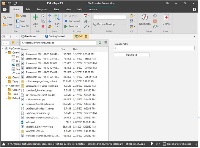

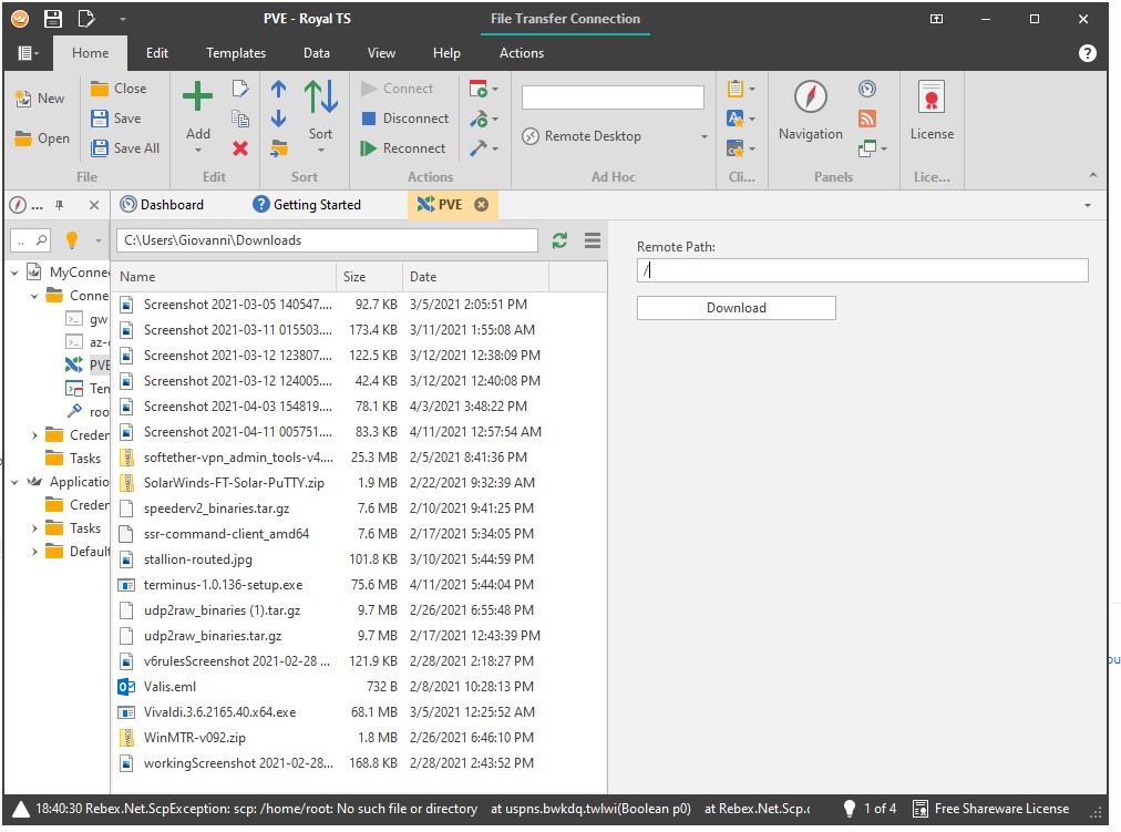

I’m a MobaXterm user and was trying RoyalTS as a replacement, I setup a SCP connection and I see the UI is not displaying the files on the server path - is this intended?
I clicked “Download” and it just started downloading everything - thats not what I intended I wanted to see the files on the server then right click download if I wanted to do that…

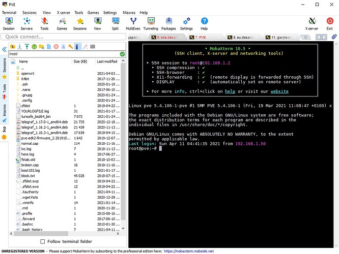

Below is a screenshot of what I am used to and sorta what I expected out of file transfer module.
What I got on TS after connecting…
am I doing something wrong?

Our file transfer implementation doesn’t support directory browsing when using SCP. Most systems which support SCP also support SFTP. Not sure if your host supports this. If SCP is your only option you might be able to integrate a 3rd party app like WinSCP using the external application connection:
Thanks for the response. Changing the setting to SFTP does show the UI I was looking for - great!
