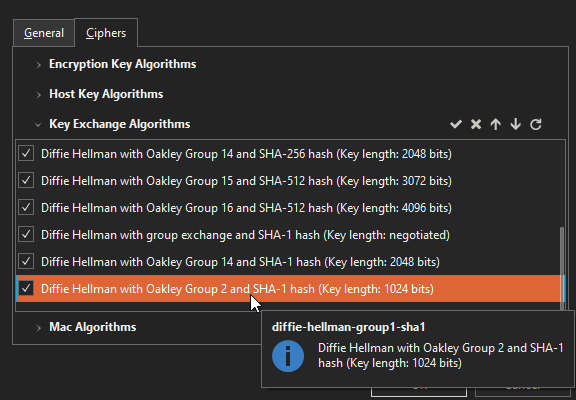

Regarding the new Security Configuration UI in Rebex Terminal, Advanced > Security. Even after checking/reordering all the Key Exchange Algorithms, I am no longer able to connect to some older Cisco Switches that are using Diffie-Hellman-Group1-Sha1. I was previously able to connect to these in v5 by checking the box for “Allow insecure SSH Key Exchange Algorithms” under the old Advanced Security tab. I do see in the Key Exchange Algorithms that there’s a diffie-hellman-group1-sha1 after hovering over the item, but the Friendly Name shows as “Diffie Hellman with Oakley Group 2 and SHA-1 hash”

Hi Zach,
would you mind submitting a support ticket about that. We would like to have more information on how to reproduce the issue.
