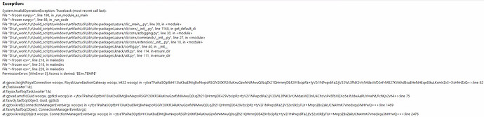

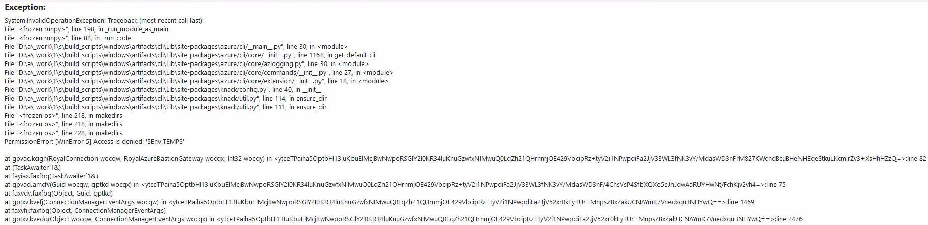

Here’s the entire error with verbose logging enabled.
Just to clarify: replacement tokens are not resolved but environment variables are expanded. Also, make sure the full (expanded) path already exists.
So using %USERPROFILE% should work. Can you post a screenshot of your log entry using the environment variable?

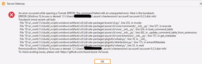

When I make a connection to a VM with bastion configured, I’m prompted to authenticate in WAM.
But I get the error: An error occurred while opening a Tunnel: Azure CLI Login failed.
If I clear the Azure Configuration Directory and do the same, I get prompted to authenticate but this time in the browser.
I disabled WAM by running ‘az config set core.enable_broker_on_windows=false’.
This has previously worked but now it fails with access is denied to my own profile (verbose logging enabled).
I have tried running az login prior to opening a connection and also az logout and starting fresh.
Thanks for the additional information. From your screenshots and posts I gather, the token/variable expansion seems to work fine. If I’m not mistaken, the last screenshot (resolution is quite poor) shows “Access is denied”. I can’t read much more but can you confirm that the actual path is correct in the error message?
