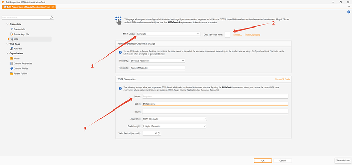

our new TOTP MFA Code Generator feature can be found in the properties of the credential under “Credentials - MFA”. To use it you will need to configure “Generate” here (1):
You can configure the secret via QR Code here (2) using drag&drop, browse or even paste the secret from the clipboard. Alternatively, you can also or define it here (3). The generated MFA codes can be used in Autofills, Key Sequence tasks, etc, and can be referenced using the $MfaCode$ token. Not only that, but you can even specify the different decimal spots using $MfaCode[0]$ for more advanced scenarios.
Here is an example of how to configure the secret based on the aforementioned website (https://authenticationtest.com/totpChallenge/).

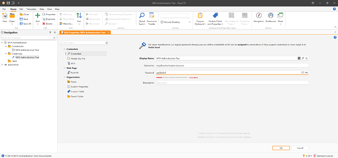

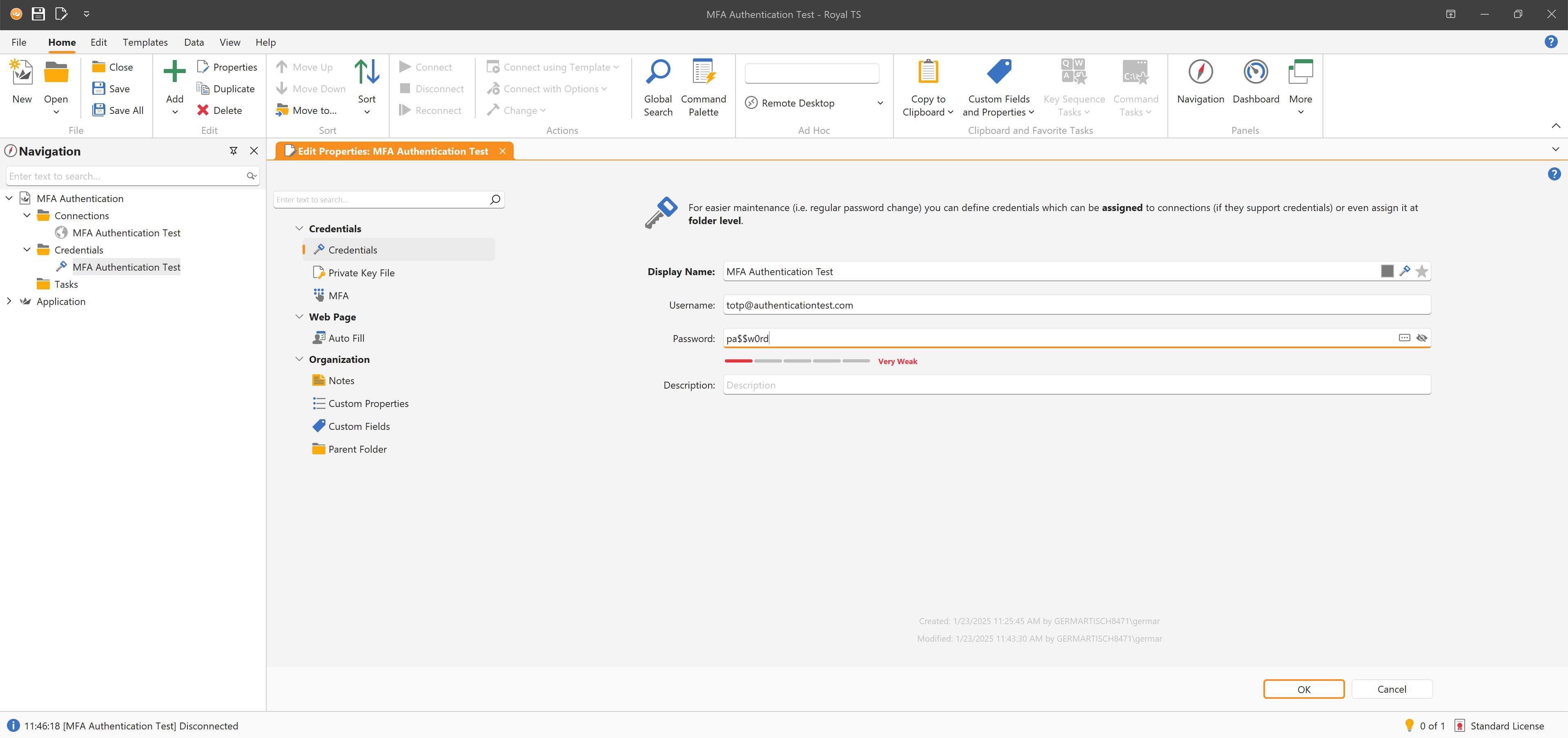

First off, you will need to create and configure a credential object. I always being with username and password:
Once you have done that, please move to the “MFA” section of the credentials and configure the following (this can also be automated using the QR Code as mentioned earlier):
Once you have done this, save your changes by clicking on “OK”, then you are ready to move on to the configuration of the Auto Fill.

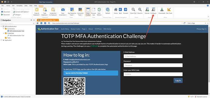

To use the new feature, first configure your newly created credential in the properties of the webpage. Next, you will need to open your webpage and then click here to configure the auto fill:

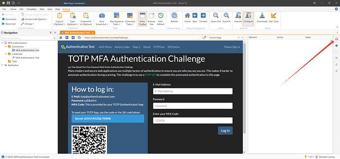

The next step if to analyze the webpage by clicking here:

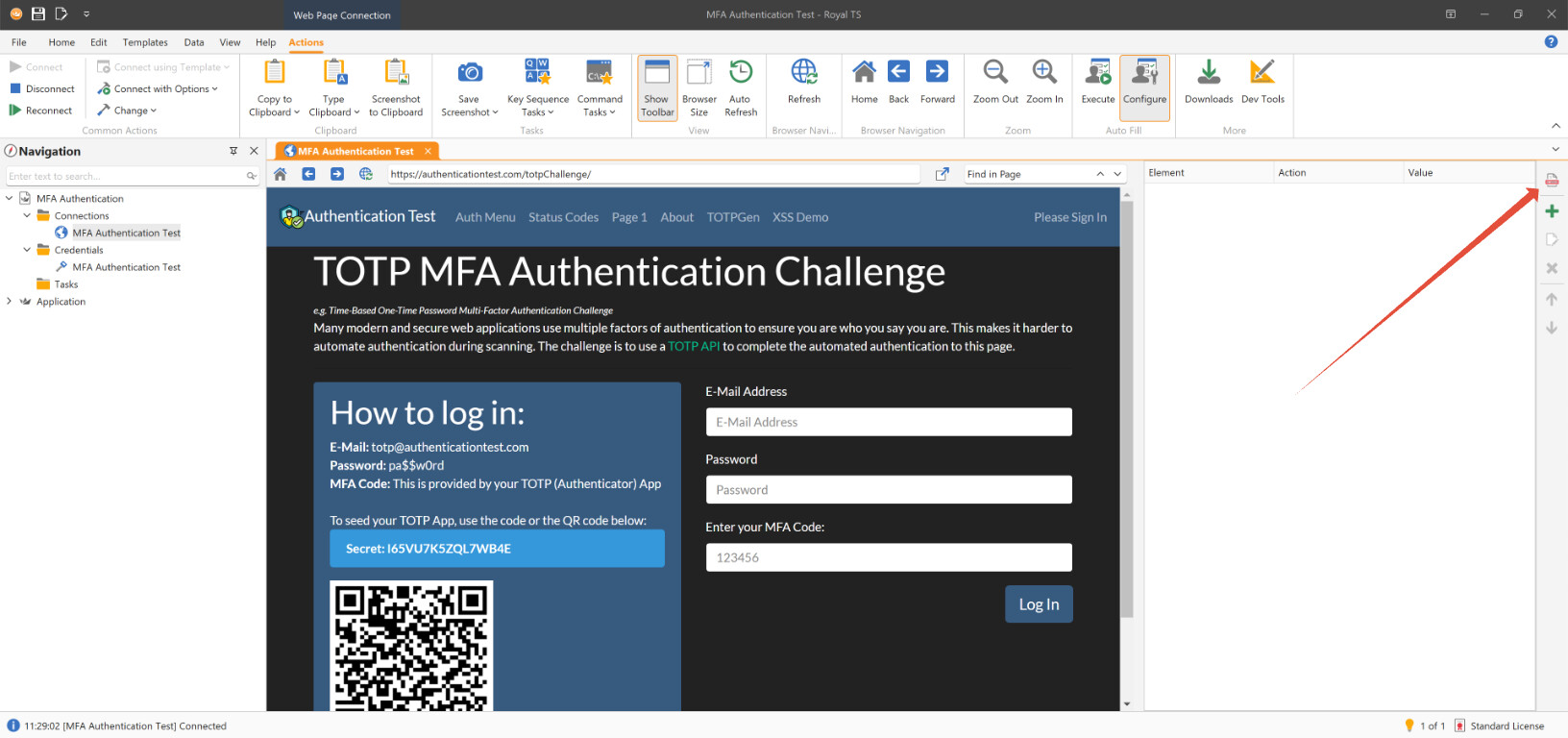

Once you have done that, the can simply select the different fields using your mouse and add autofill mappings using the “+”.

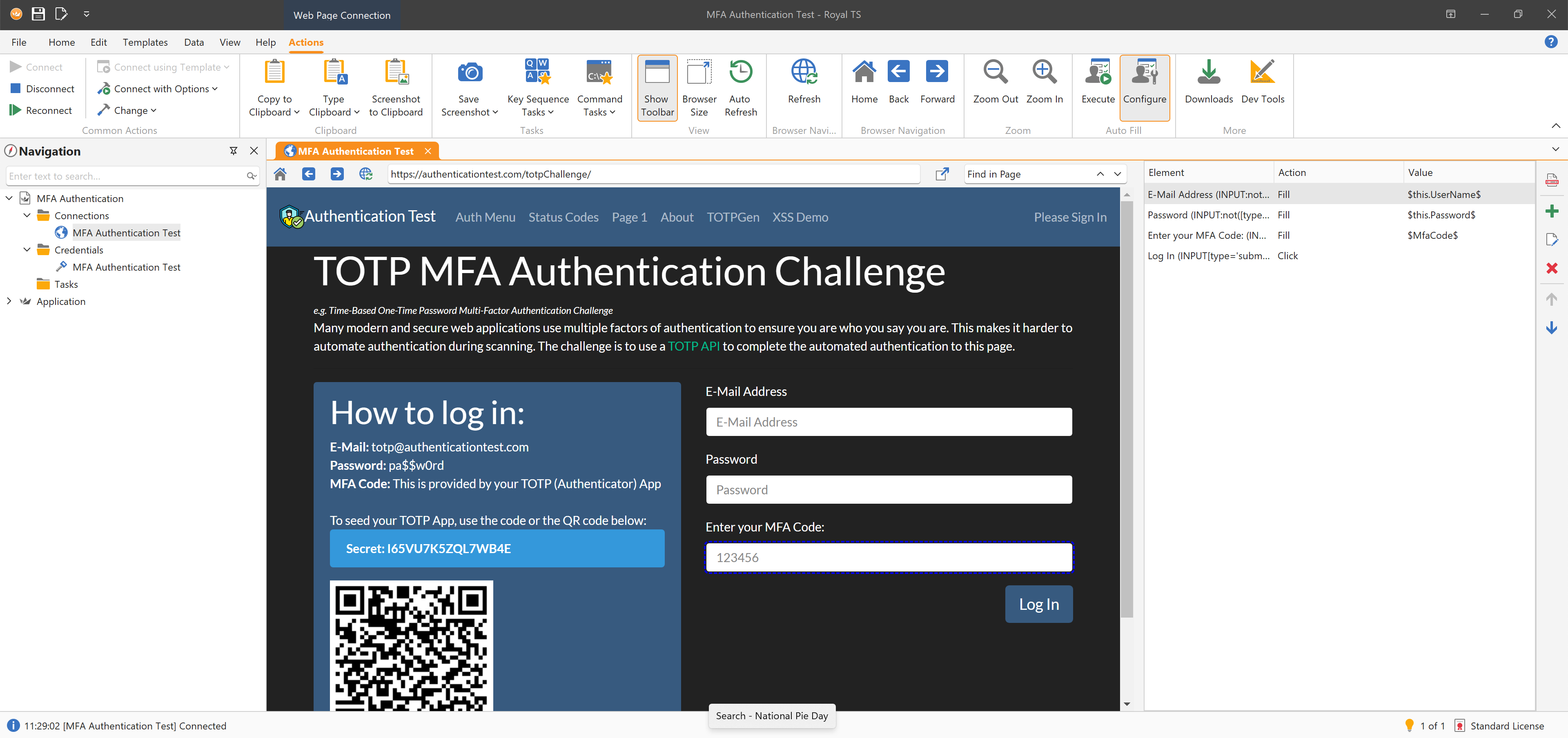

If you need to remove a mapping, you can do so by selecting it from the list and then clicking on the “x”. If you need to change the order of your mappings, this can be done by selecting the mapping and then using the up and down arrows. To auto fill your generated MFA code, you can select it from here:
Last but not least, don’t forget to configure “Click” for the “Log In” field. For this example, the following configuration worked just fine:
To save your changes, simply click on “Configure” in the Auto Fill selection in the Ribbon.

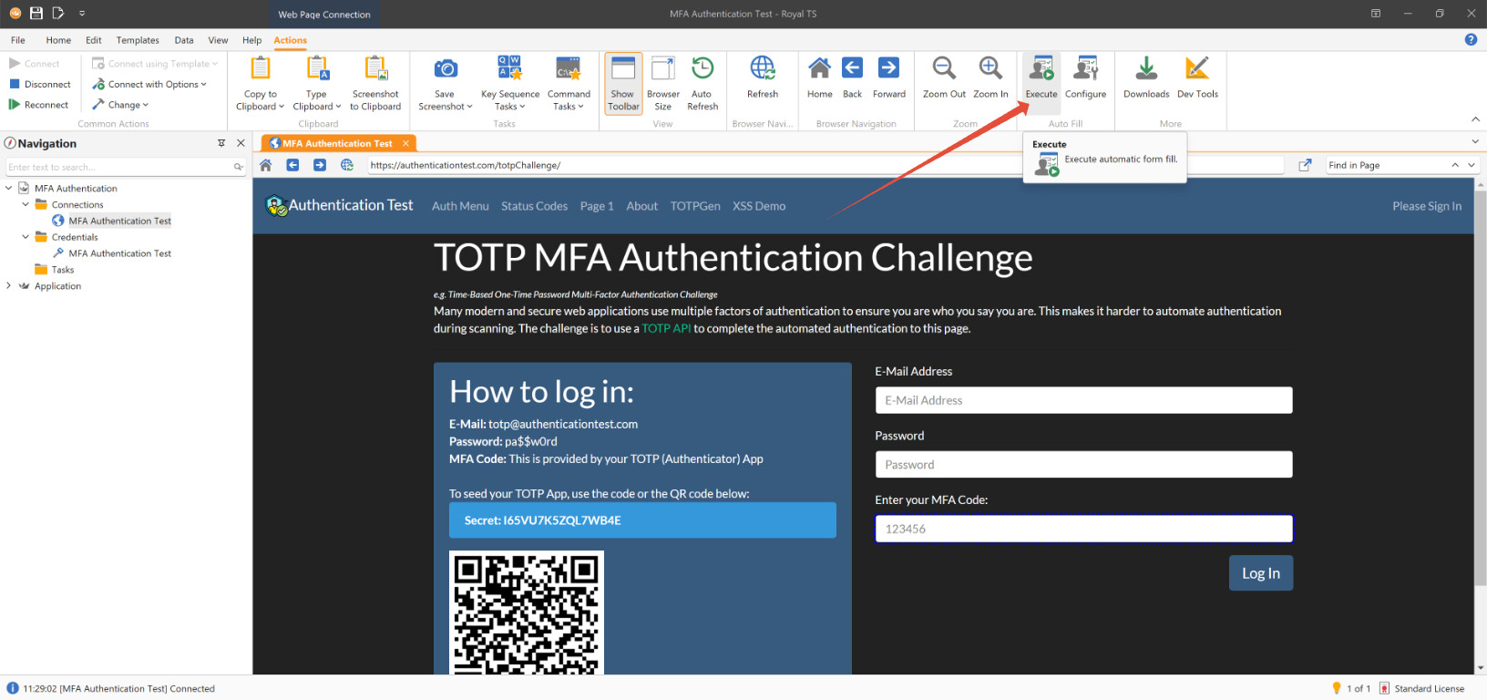

Once you have done that, you can test your Auto Fill configuration by clicking on “Execute”:
If everything is configured correctly, you will be successfully logged in:
