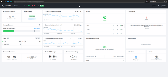

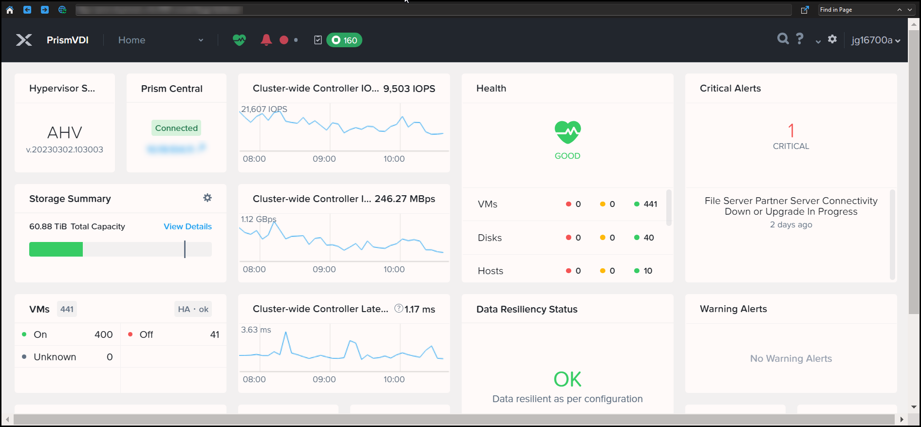

I don’t have a public website, but I can attach some images here.
I found that I can do a page refresh as well using the button at the top and the page zoom returns to normal.
Thinking more on it, I think I remember how it started. I was using zoom for something else and I believe I accidentally changed window focused onto Royal TS and then zoomed the page. I did a CTRL+0 to return the window to normal as the CTRL+Scrollwheel method was difficult to realize when it was back to 100%.

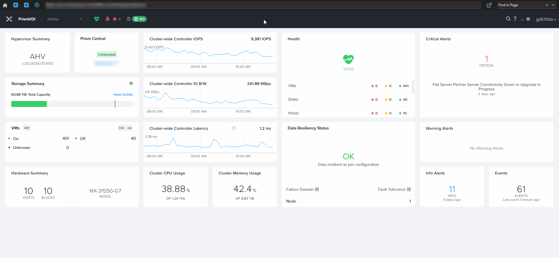

Here are a couple screen shots of before and after on two different pages.

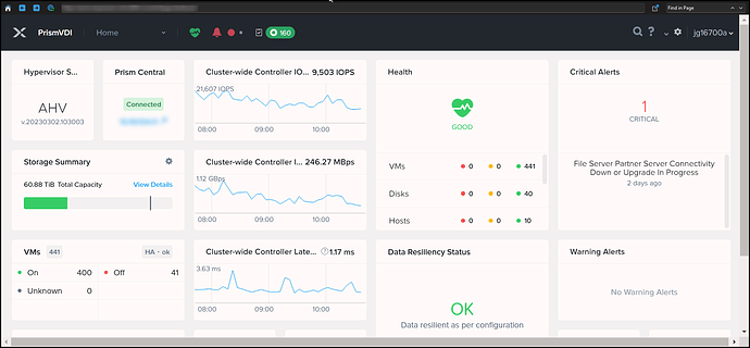

After a page refresh:

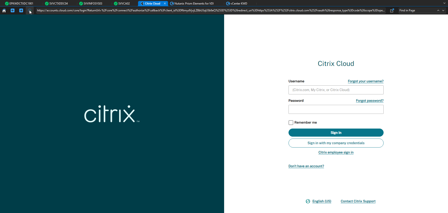

Here is a Citrix Cloud login page as well. This is before:

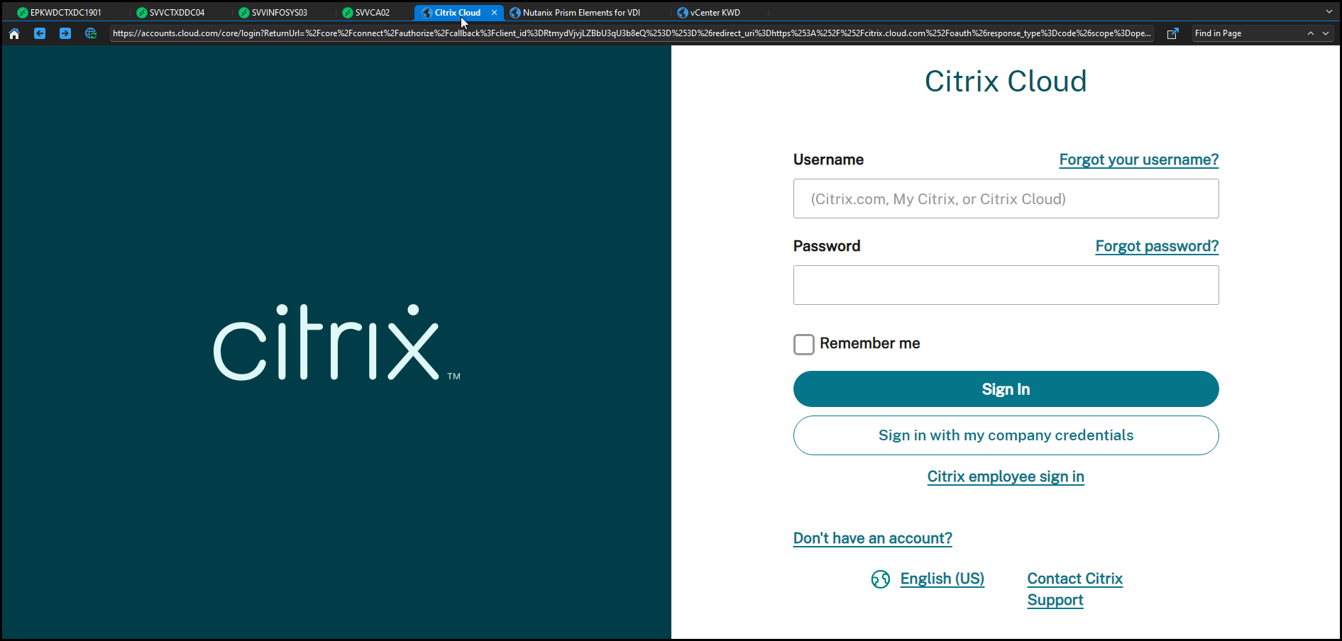

And this is after I refreshed the page:

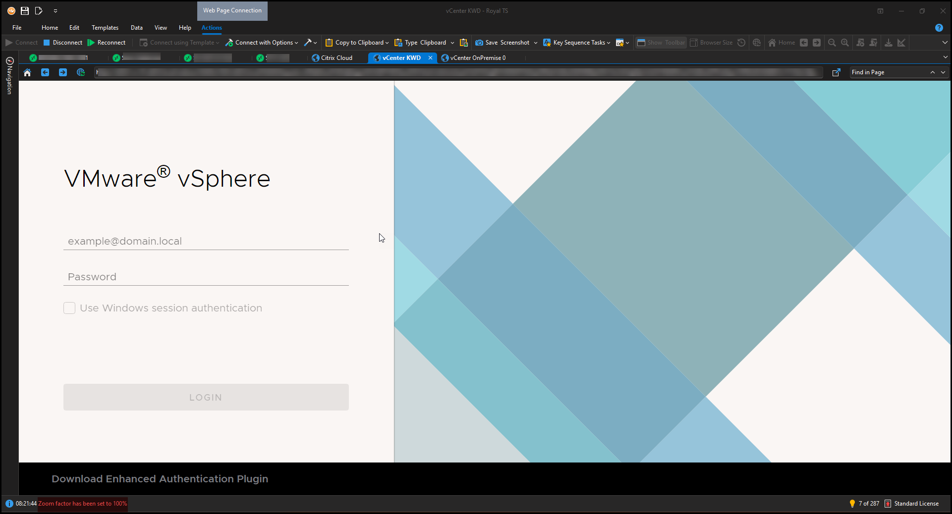

I think I just figured something out. There appears to be a mismatch between what Royal TS thinks is 100% and what is really 100% zoom. I noticied on this vshpere login page that zoomed in. So I attemtped to use CTRL+0 to reset and that didn’t seem to have any effect.
I then used CTRL+(SCROLLWHEEL) and noticed at the bottom that Royal TS was telling me what the Zoom factor was set at. Notice in this screenshot it says Set to 100% but it is larger than 100%!
Then I did a page refresh again and the page did return back to the real 100% zoom.
