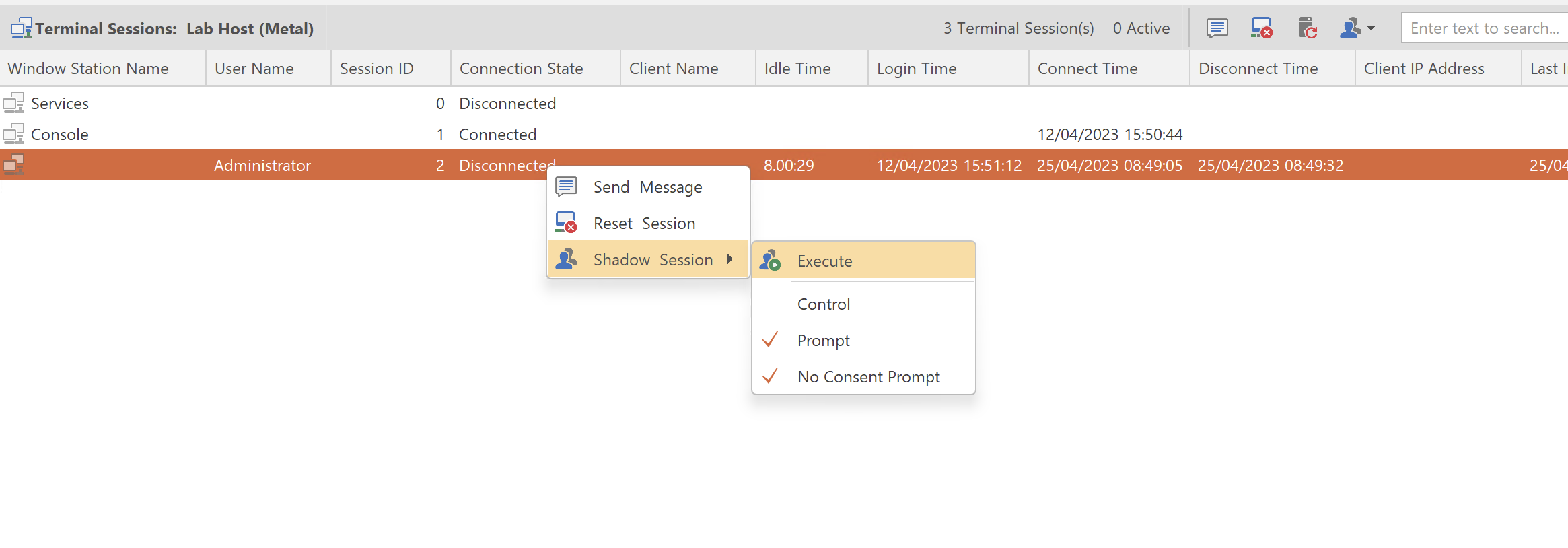

Hi Johnnie,
in Royal TS V6 you can actually execute mstsc /shadow directly from the dashboard:
Is this not working for you?
Thanks for your reply.
Yes, the Dashboard option works - albeit somewhat clumsily - via the dashboard, because it requires several extra clicks.
What we were hoping for is basically a checkbox in the configuration screen (Properties) of an RDP Connection in RoyalTS that says something like “Connect to session [1/2/3/console] and shadow session”, with the additional options “no consent prompt” and “control”.
These options should also be available when you right-click on a connection in the Navigation pane and select “Connect with Options”, indeed in the same way as they are currently available from the dashboard.
The whole idea is to be able to simply double-click an RDP connection in the Navigation pane (e.g. in a folder named “Tech Support - Shadow Connections”), and instantly be connected to the existing user’s session on that PC and be able to help him by seeing his screen(s) without him being thrown back to the Windows login screen.
On the face of it, it does not seem too difficult to implement, especially since, as you mention, the code is already there to use with Terminal Servers from the Dashboard. Seems more a case of adding the checkboxes and menu entries to the UI, and copying the entries from the context menu of the dashboard to the “Connect with Options” menu…
