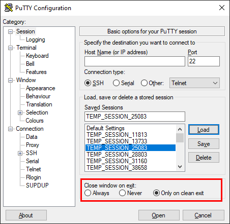

can you show me the setting in PuTTY? Maybe a screenshot?
Hi Stefan, sure:
It should be easy to do since you’re already generating a temporary session for each connection.
  • CloseOnExit = 0 -> “never”
  • CloseOnExit = 1 -> “only on clean exit” (the default, as far as I know)
  • CloseOnExit = 2 -> “always”

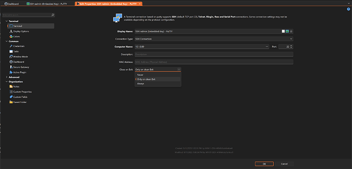

Hi Christian,
the next minor release will have the setting on the main page - similar to what PuTTY shows:

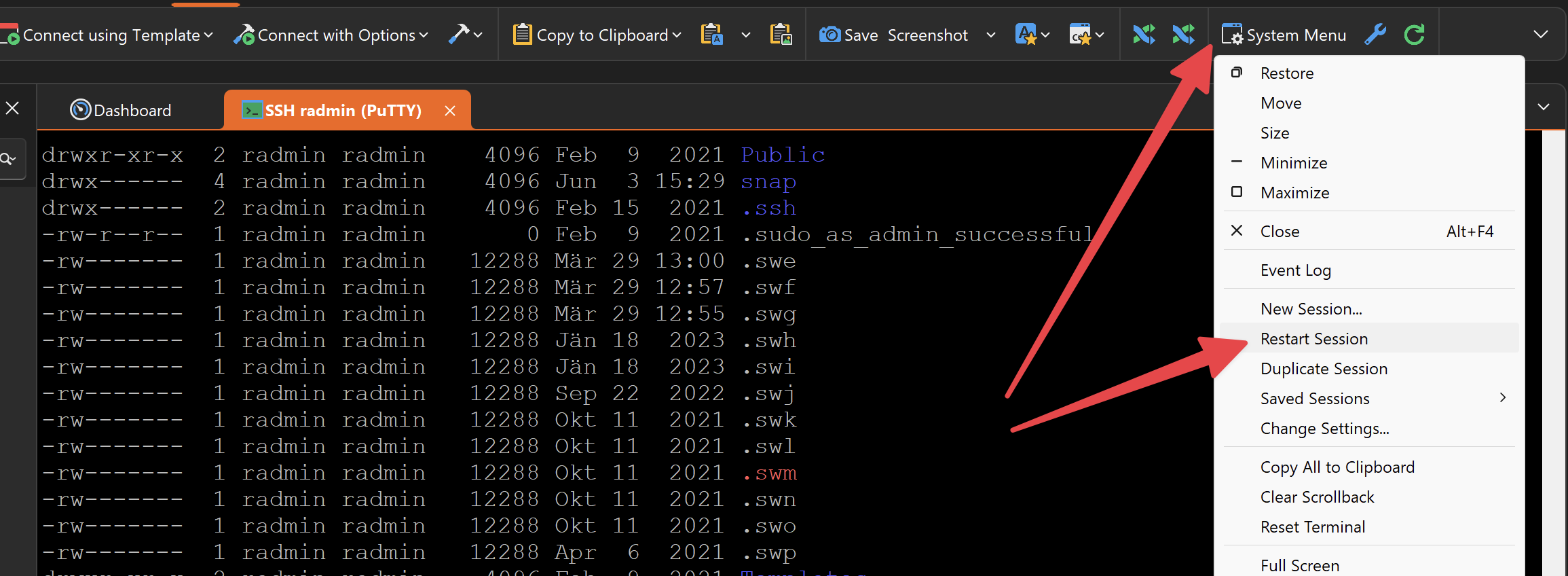

unfortunately this can’t be done since PuTTY is an external process, we can’t really tell what state the PuTTY session has. If you set the “Close on Exit” behavior to “Never”, the PuTTY executable keeps running but in disconnected state. From Royal TS’ point of view, PuTTY is still running and since we can’t really tell if it’s still connected or not, Royal TS assumes it is still connected. You actually need to tell PuTTY to restart the session in order to keep the scrollback buffer:
I hope this helps.

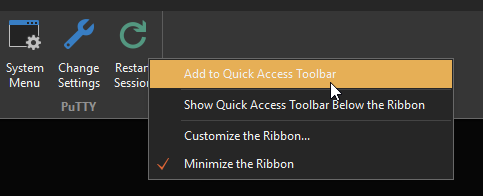

To save one step, you can even put that particular action into the quick action toolbar at the top left of the RoyalTS window:
@christian_wissel: that’s a good point. Thanks for mentioning it!
Thank you both for fast replies, wasn’t even aware there’s a Menu for the actual Putty in RoyalTS to use directly.
This usage makes sense, will use it instead of the RoyalTS reconnect to preserve the session.
