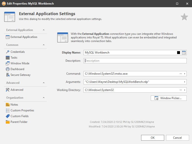

I’ve managed to get it working by setting it up as an ‘External Application’ and referencing the RDP app (example attached), but don’t know how to pass the correct user credentials. Also, I don’t know if it’s possible to embed that application window.

to be honest, I’m not really sure if you can embed a remote app after you started it as external app using that rdp file. Especially Remote Apps do custom stuff to the hosting window which would most likely cause troubles. I’m also not aware of any method to pass in credential information to mstsc.exe. As far as I know, it’s not possible.
Unfortunately there’s no way to make Remote Apps work with the Windows RDP ActiveX control from Microsoft which ships with Windows. We use this ActiveX control in our application but it doesn’t support Remote Apps.
Sorry to be the bearer of bad news :frowning:
