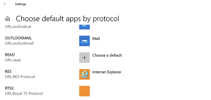

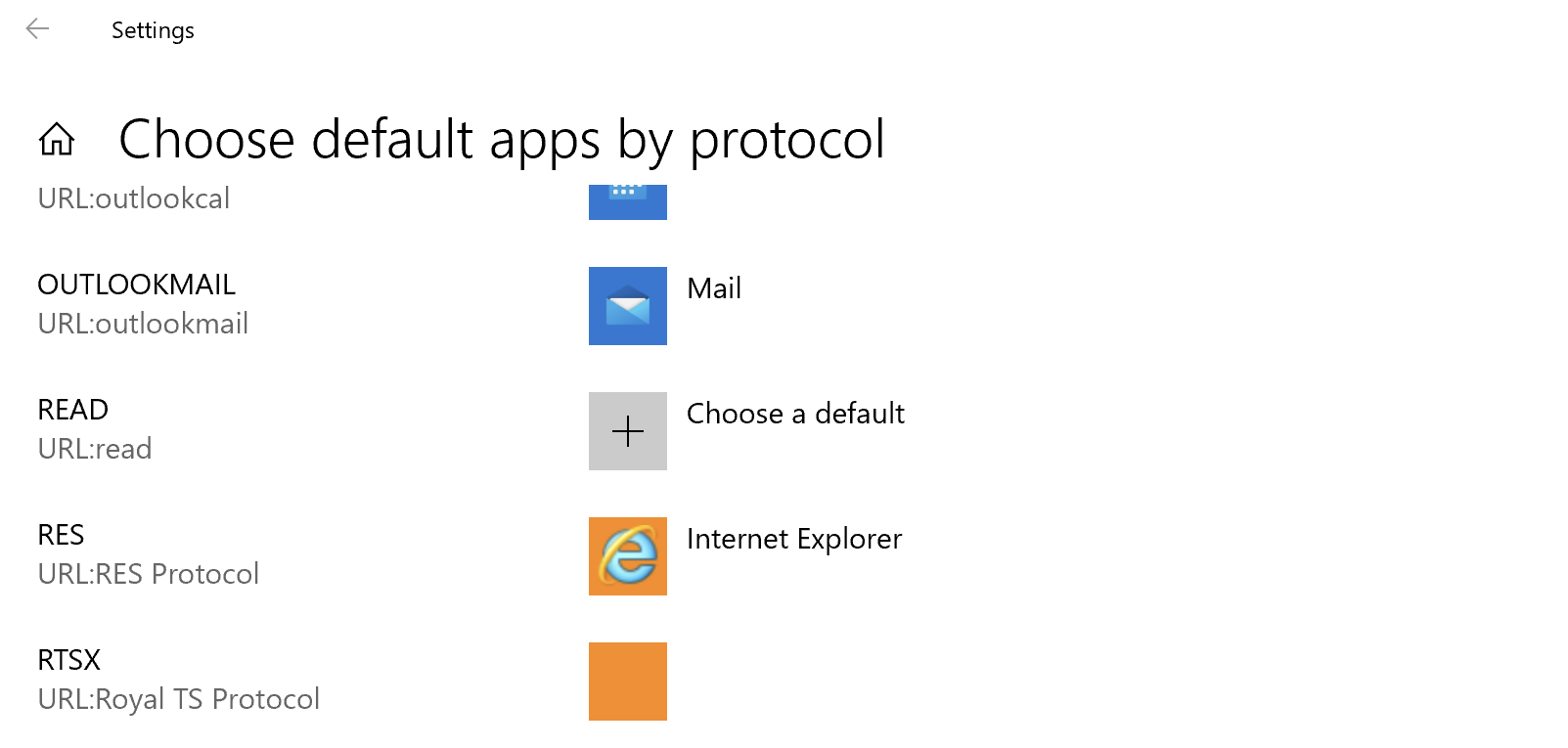

I’ve also tested the color scheme link and there’s indeed something not right here. I was able to identify an issue where the URL string is not parsed correctly but I still can’t get it to work. It seems to me that a recent Windows 10 update broke the URL protocol handling. I’m not able to launch Royal TS from an URL protocol although it is configured correctly (according to the docs). In the default apps by protocol I see this:
I’m not able to choose Royal TS and it also seems that I only can choose apps from the Windows Store. Not sure if and how I can fix this but this will take more time, I guess.
