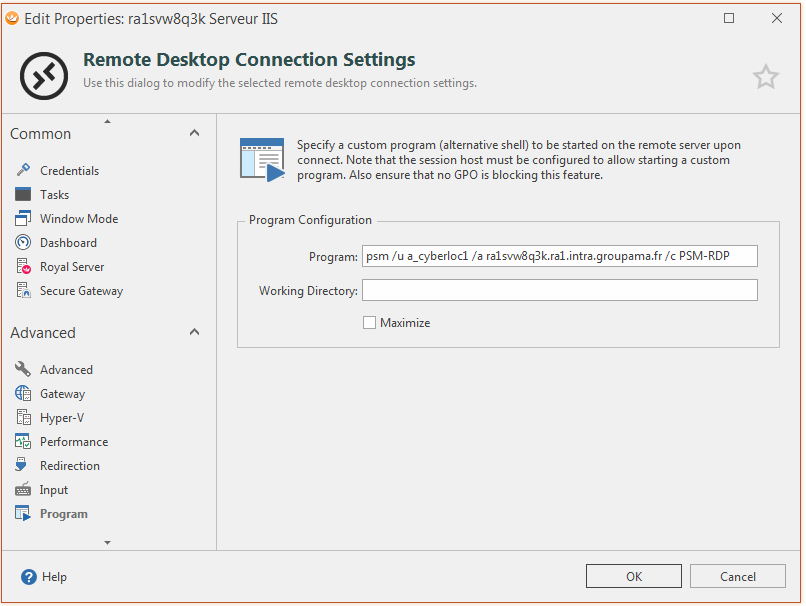

I’m using a proxy to make RDP connexions to servers.

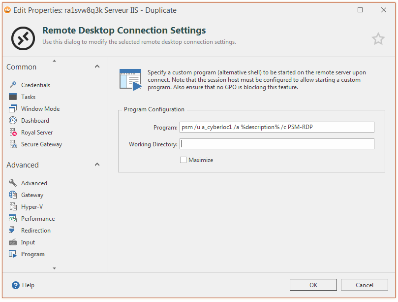

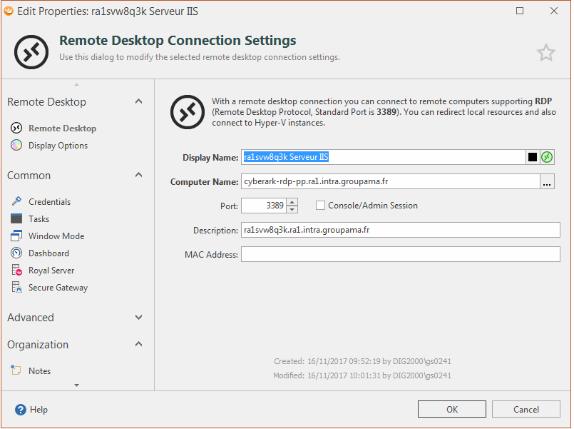

If i specify the “description” field in “Remote Desktop” section. (screen 1)
How can i use this value as a variable as a program parameter like %description% (screen 2)
Thanks for your help

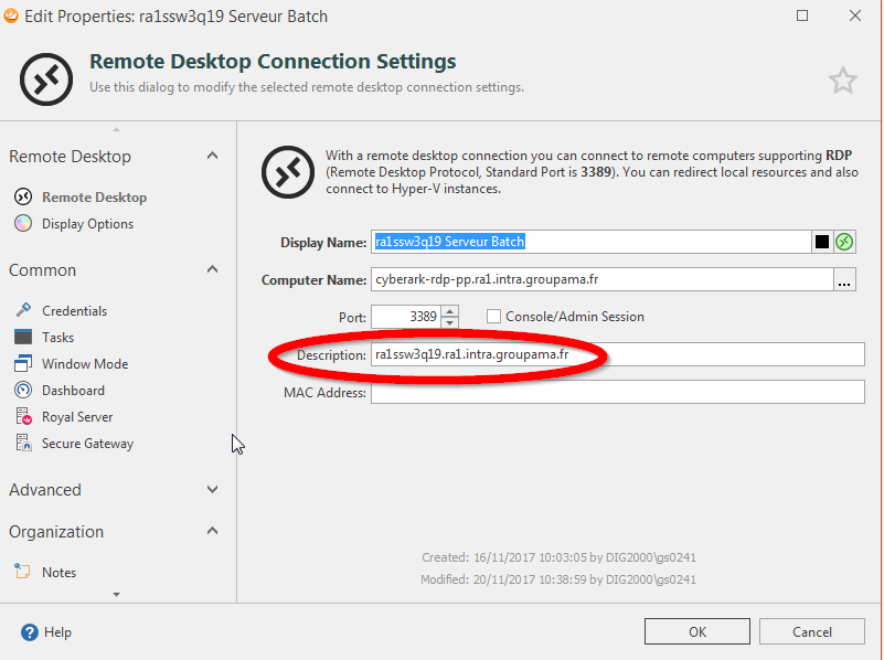

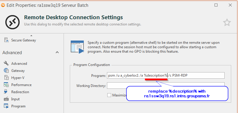

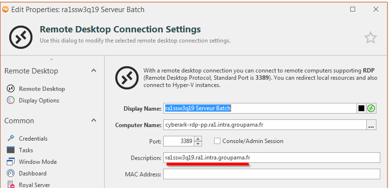

Hello Stefan,
I’m now in RoyalTSInstaller 4.02.61030.10000 and i have the same result.
Config working OK :
Config NOT Working
In fact, we are using Cyberark and the gool is to connect to a server thru CyberArk Proxy and to have only one line to change when you duplicate an entry.

Hi Pierre,
as mentioned in my first reply, you need to use the following syntax: $Description$. Note that you need to use $ instead of %
Thank you so much
it’s working fine.
