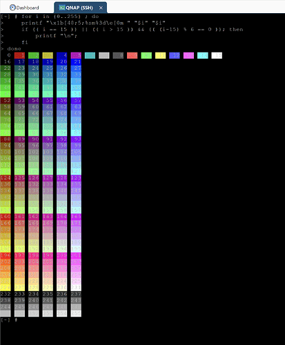

I’m not sure what you mean. You can only define the 16 base ANSI colors but the terminal can render the full 256 color palette:
You can try it yourself:
for i in {0..255} ; do
    printf "\x1b[48;5;%sm%3d\e[0m " "$i" "$i"
    if (( i == 15 )) || (( i > 15 )) && (( (i-15) % 6 == 0 )); then
        printf "\n";
    fi
done

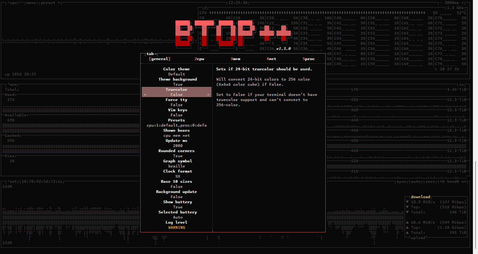

You have absolutely right. It was btop that use truecolor as default that fooled me. :slight_smile:
