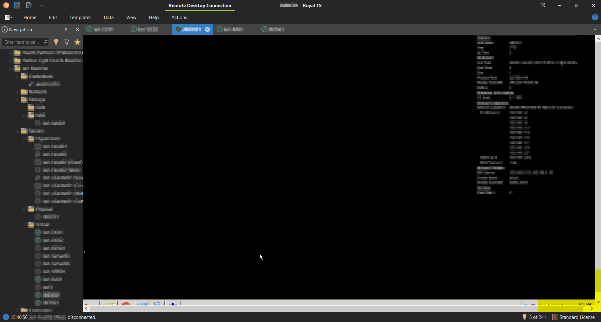

Hello usually I’ll be working in a couple RDP sessions then minimize RoyalTS while doing some researching in Firefox. Then when I pull RoyalTS back up after a bit the RDP session has resized itself adding scroll bars so I have to reconnect each RDP sessions to have it sized properly again.
Below is an example:

I was able to repro the issue on my side. Seems to be a bug in the UI framework. I opened a ticket with the vendor to look into it. What I noticed, it only seems to be a one time size change when minimize/restore is done. So if you minimize and restore the window at the beginning one time before you initiate a connection, you shouldn’t see the issue. Also, for me the smart reconnect in the latest build solves the issue for the active session.
