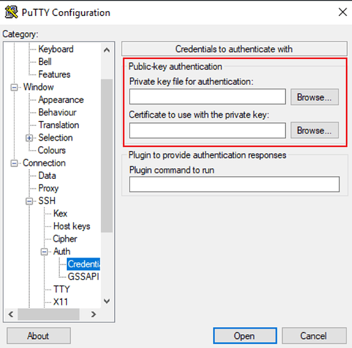

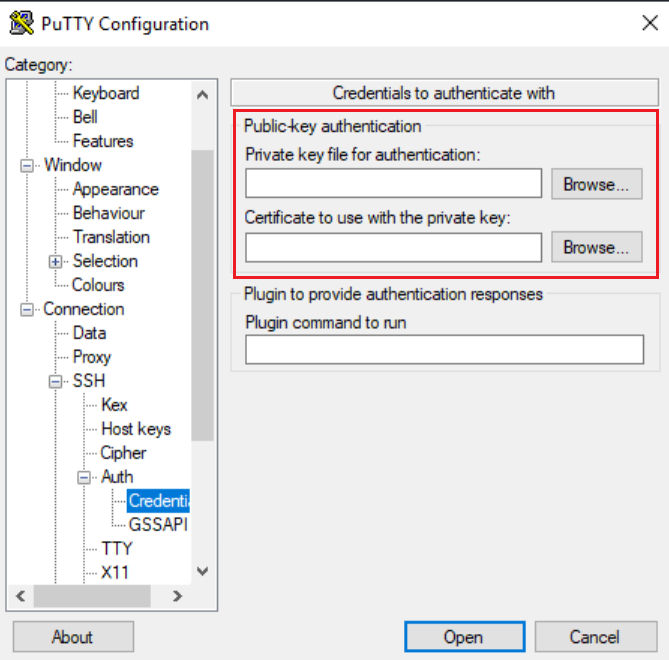

Hi Royal Apps,
Would it be possible to support OpenSSH certificate as an authentication method to login?
In the latest PuTTY version 0.78, there is support for this method (see screenshot).
One of the major security benefits of using signed cert is its validity period.
Thanks.
supporting OpenSSH certificates as an authentication method is possible and provides several security benefits. PuTTY version 0.78 and later supports this feature.
the next beta release of Royal TS V7 will have this feature on board. Stay tuned for the next update…
