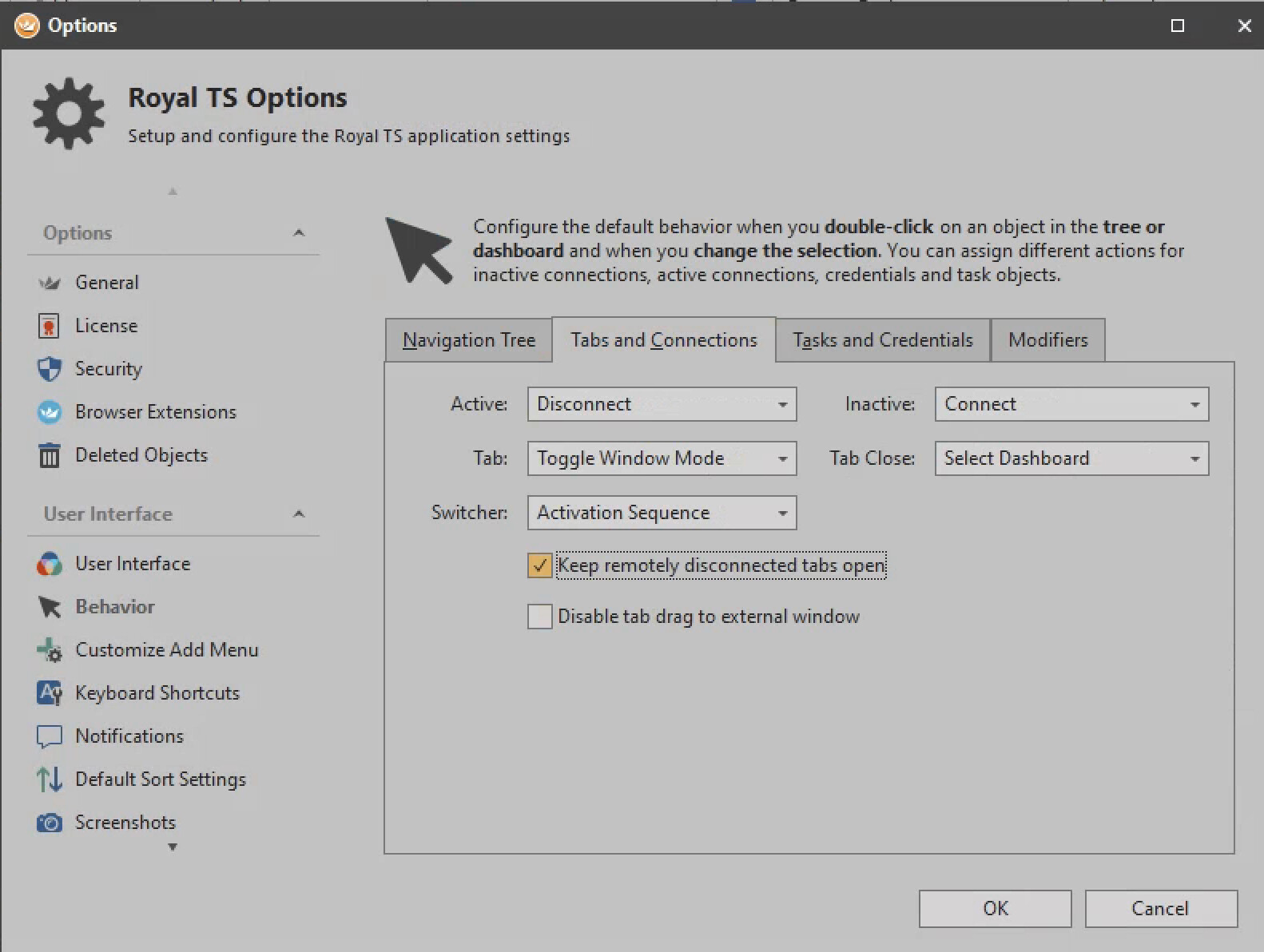

Hi Davin,
this can be enabled within the Royal TS Options > User Interface > Behavior > Tabs and Connections section, as shown here:

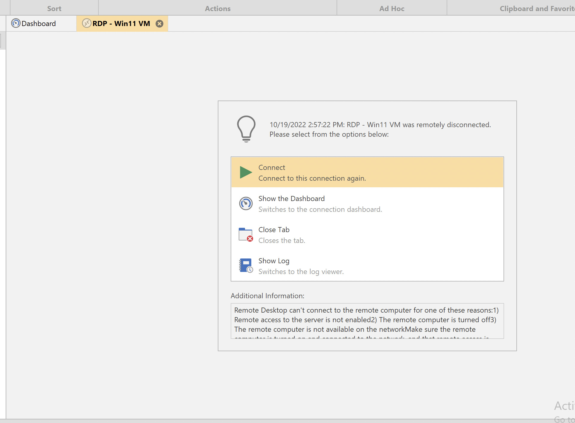

I just tested this via my Windows 11 VM.
I was connected to the VM via RDP using the latest version of Royal TS and then shut off the remote VM.
Afterwards, I was greeted with the following message:
I then clicked on “Connect”, which did not work, as the VM is turned off, however the Tab stayed open with the same screen, as in the screenshot I posted above.
