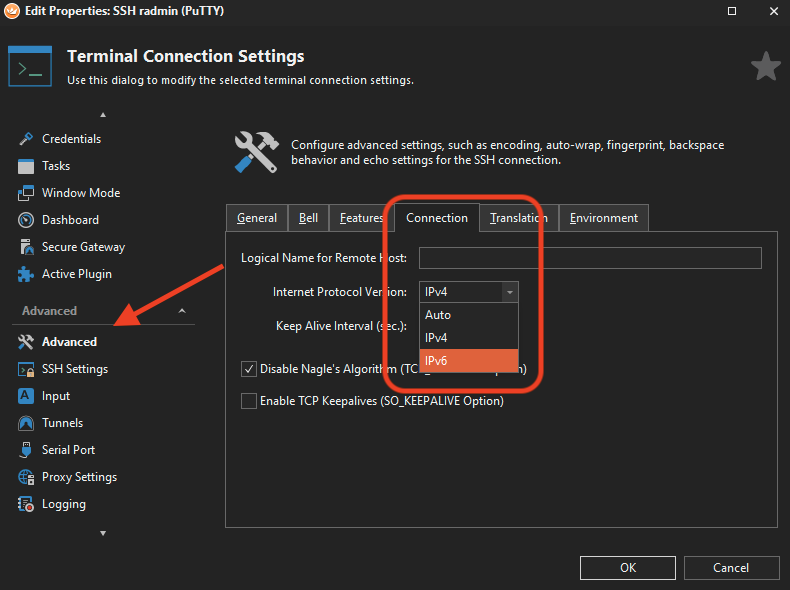

have you tried setting the Internet Protocol Version to IPv6 within the Advanced settings of your putty connection?
Let me know if that worked for you or if you need further assistance!
best regards,
Many thanks. This worked. For some reason it was also set to ipv4 instead of auto.
