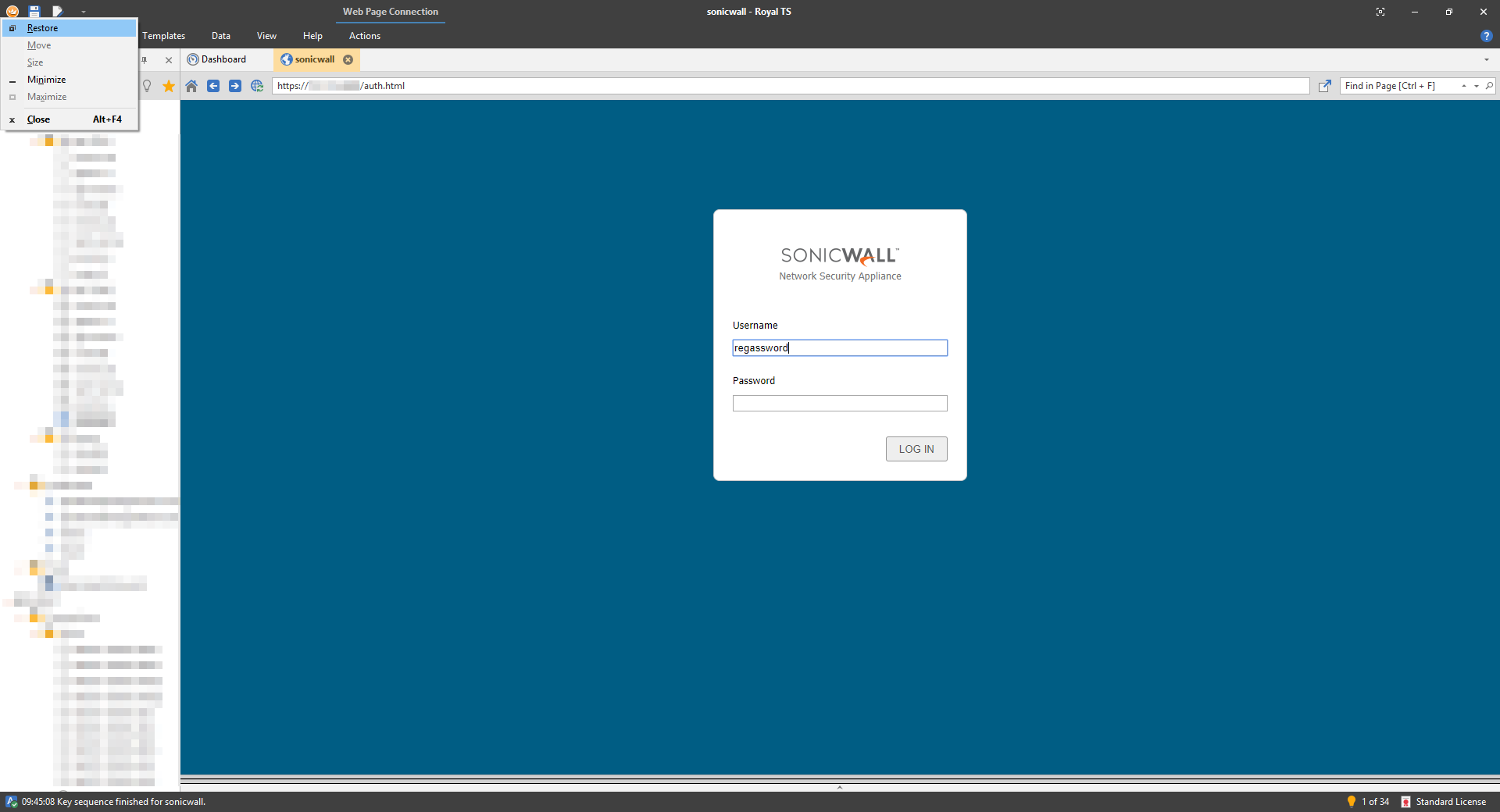

I tried that too, and I’m not sure what I’m doing wrong. Here is my key sequence:
$EffectiveUsername${TAB}$EffectivePassword${ENTER}
It seems to leave out or skip the first character of each value, it doesn’t Tab correctly, and Enter causes the window menu (normally Alt+Space, Restore/Minimize/etc.) to pop up. So if I’m using “greg/password” all I get is “regassword” in the username field and then the menu showing up in the top left corner.

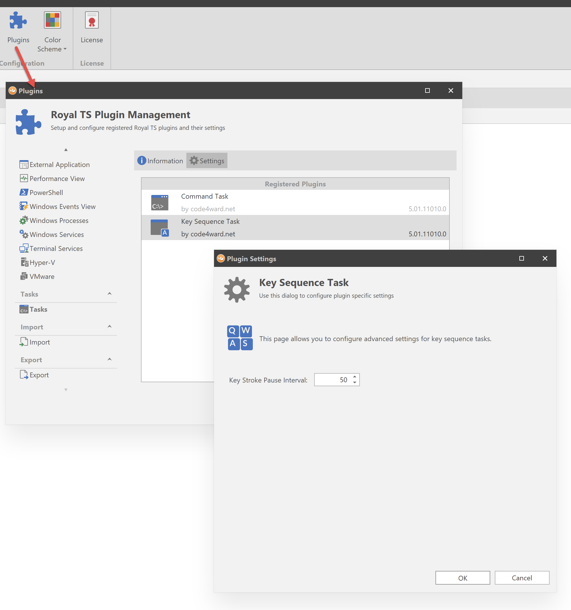

It seems that the newer chrome versions have issues with keyboard automation. In IE it seems to work fine. Adjusting the pause between the key strokes and increasing the initial delay seems to improve things:
According to some users, the {ENTER} sequence at the end is also not working correctly. Other tools (like Silenium) which are using Chrome to automate keyboard input struggle with the same issue. I haven’t found a workaround yet.
If you omit the last enter sequence and adjust the timing, you may at least get half way there.
